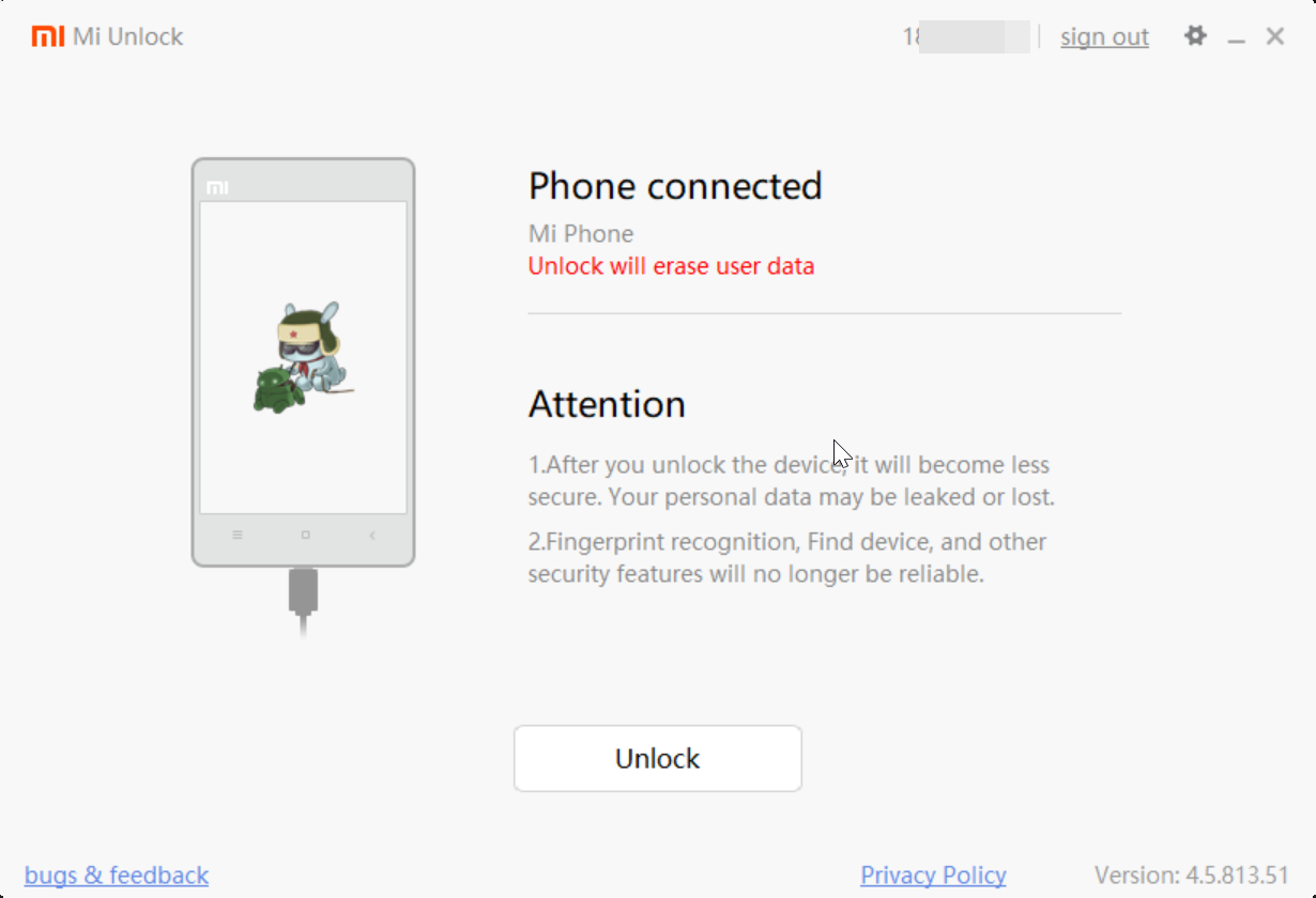

I'm always getting the notification, that my system can't be linked with my account.
The unlock button was visible in the software. Comes the cooldown after clicking the button, or before?
Click the button and it will warn you about wiping the phone (once or twice even), and then first check your phone an Mi account, then tell you there's a mandatory 168 hour waiting time. That will then start and be linked to you Mi account. I just checked again, and the countdown is now at seventysomething hours left before unlock is possible.
Ah okay, will the phone get wiped when the countdown starts or when the bootloader is getting unlocked?
When the bootloader gets unlocked. Clicking UNLOCK now will not do anything to the device, it just starts the countdown on your account. You'll have to wait a week and then try unlocking it again for the device to get wiped and the bootloader unlocked.
