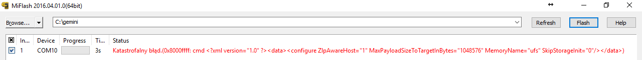

I'm afraid I've the same problem with my about two weeks old black Mi5 64GB.
On Saturday morning got Ota update to dev miui ver 6.5.7 and in the evening phone screen got black, and just navigation buttons lights on. I tried to reboot my phone holding power button but phone didn't start up. Now I can't do anything.
Win10 device manager discover mi5 as Qualcomm HS-USB QDLoader 9008 and MiFlash connect with it but I can't install any rom with MiFlash.
Yesterday MiFlash hangs on with status "Missed hello packet, try to recover". Today something changed and MiFlash get status "Total error (0x8000ffff: Receiving hello packet)" and sometimes same error with more information:
I've described this problem on Polish Miui forum but as far I didn't get any working solution.
Today another user get the same problem.
I hope We'll find some working solution soon.
