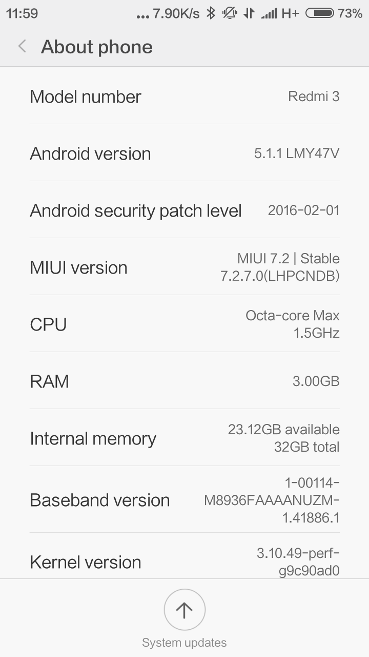

Android version 5.1.1 LMY47V
Android security patch level 2016.02.01
MIUI version : 72. stable 7.2.7.0(LHPCNDB)
Kernel version 3.10.49-perf-g9c90ad0
Baseband version 1-00114-M8936FAAAANUZM-1.41886.1
I would really love your help

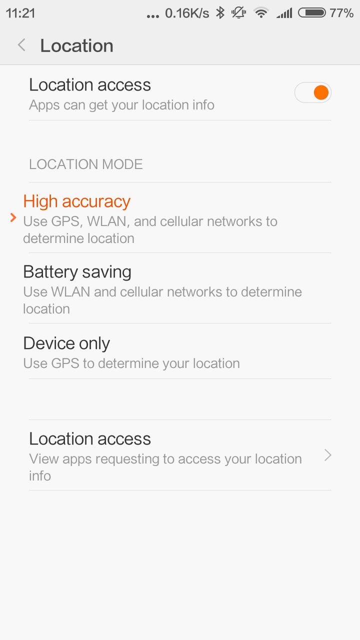

just to be clear what we are dealing with here. My settings for xiaomi redmi pro 3

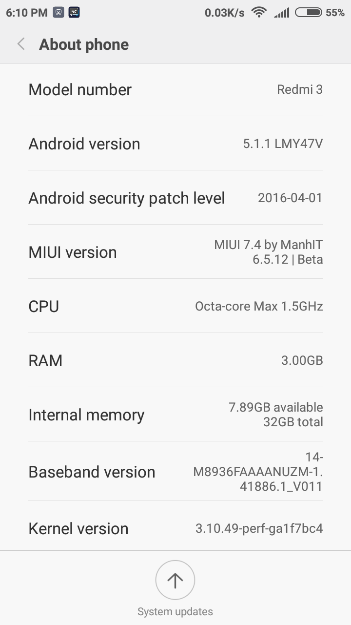

nevermiss can you also post the miui version and screenshot of your phones details please? Maybe I also need to install other ROM
I Am using Rom by manhIT

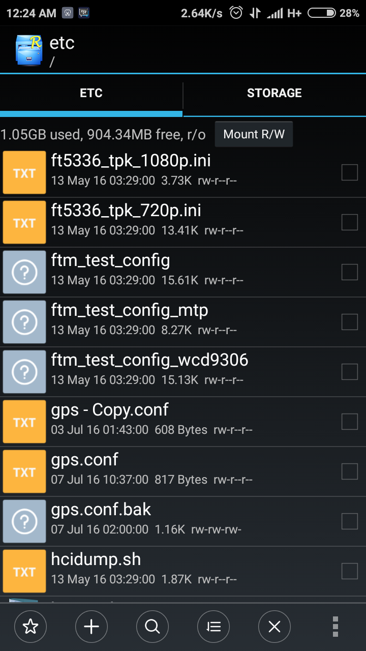

Gps.conf in etc/gps.conf.
Try see this file with rootbrowser. This app available in app store.
If you cant found in etc/gps.conf, the trouble is in your Rom.
Gps.conf by country
link : m*box*com/shared_item/https%3A%2F%2Fapp.box.com%2Fs%2Fw57s1v1n3hie7l5lk28i
Note : replace the star thing with dot
Step :
1. Downloads root Explorer, and Grant root access for that app.
2. open folder etc.
3. mount as R/W and hold gps.conf.
4. Popup come out and choose text editor.
5. Copy all new gps.conf and replace all text with the new one.
6. Restart.

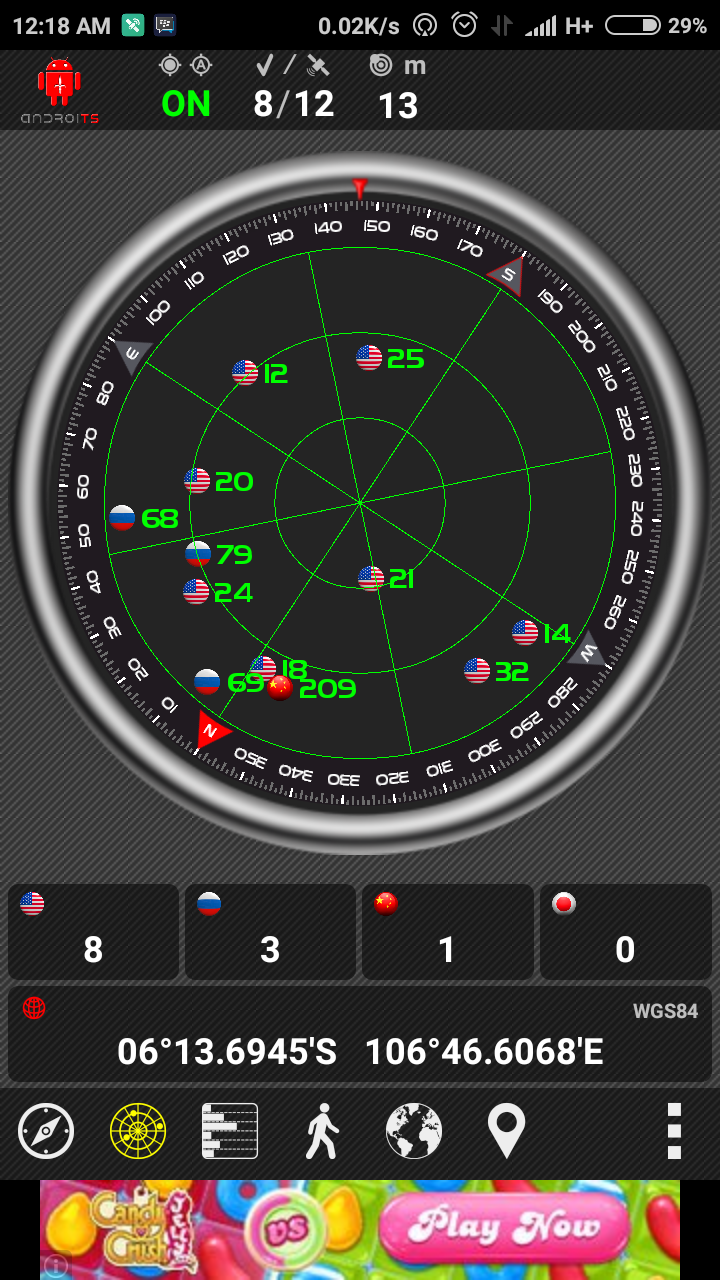

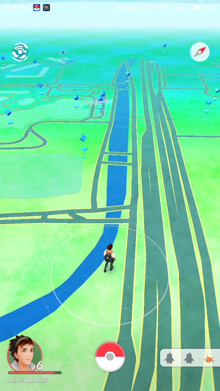

7. Open androiTS app and you Will see satelit used or not.
