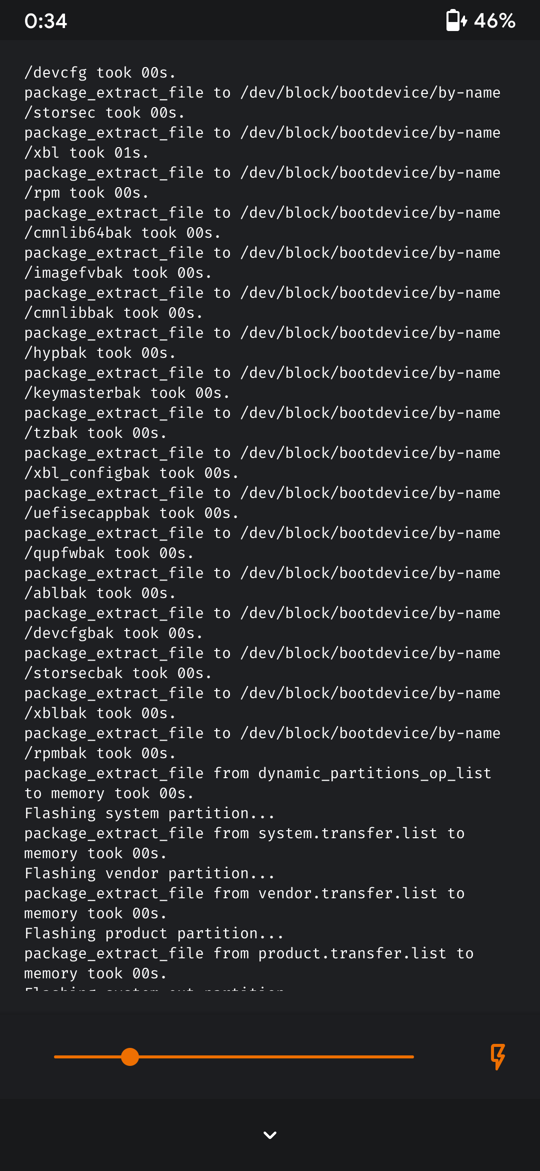

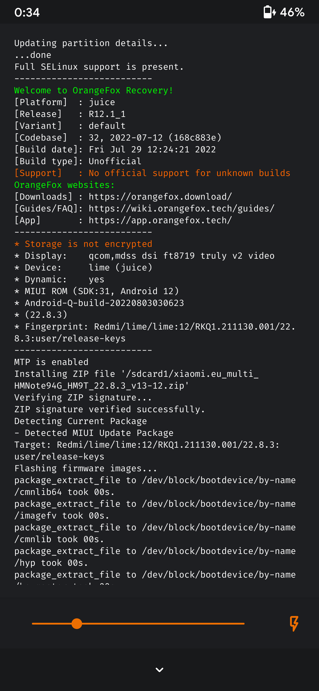

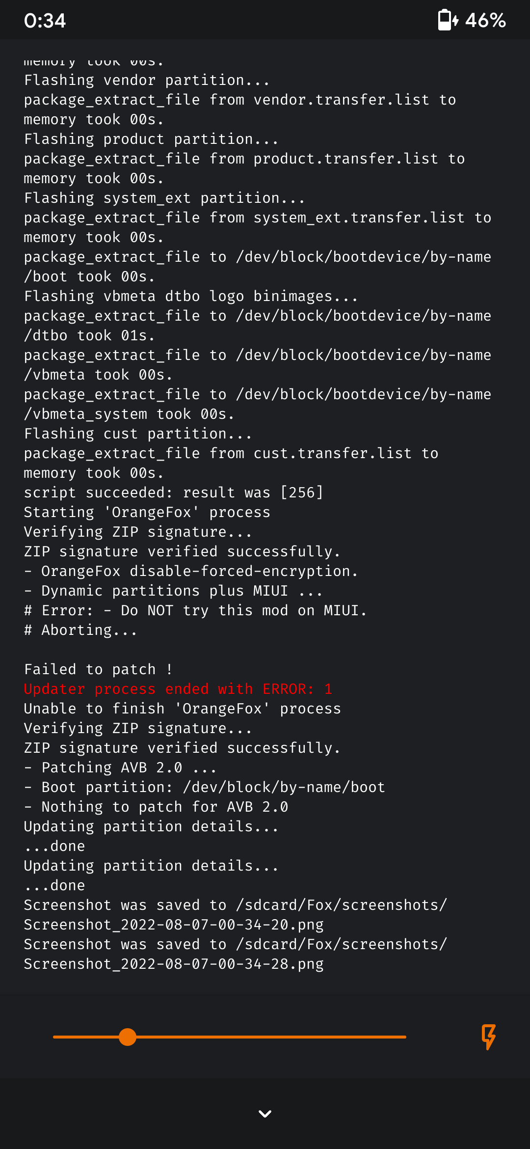

I just did you a favor, I try all 3 versions provided on our site, they are all from the guy that stopped MIUI support on his twrp, I even format data on my Redmi 9T -my work phone- and sure enough, the userdata is still get encrypted without the pin or anything.
You can now forget about updating it as the twrp return code 256 which is not a success at all, some other guys got a logo-loop after getting this result code.

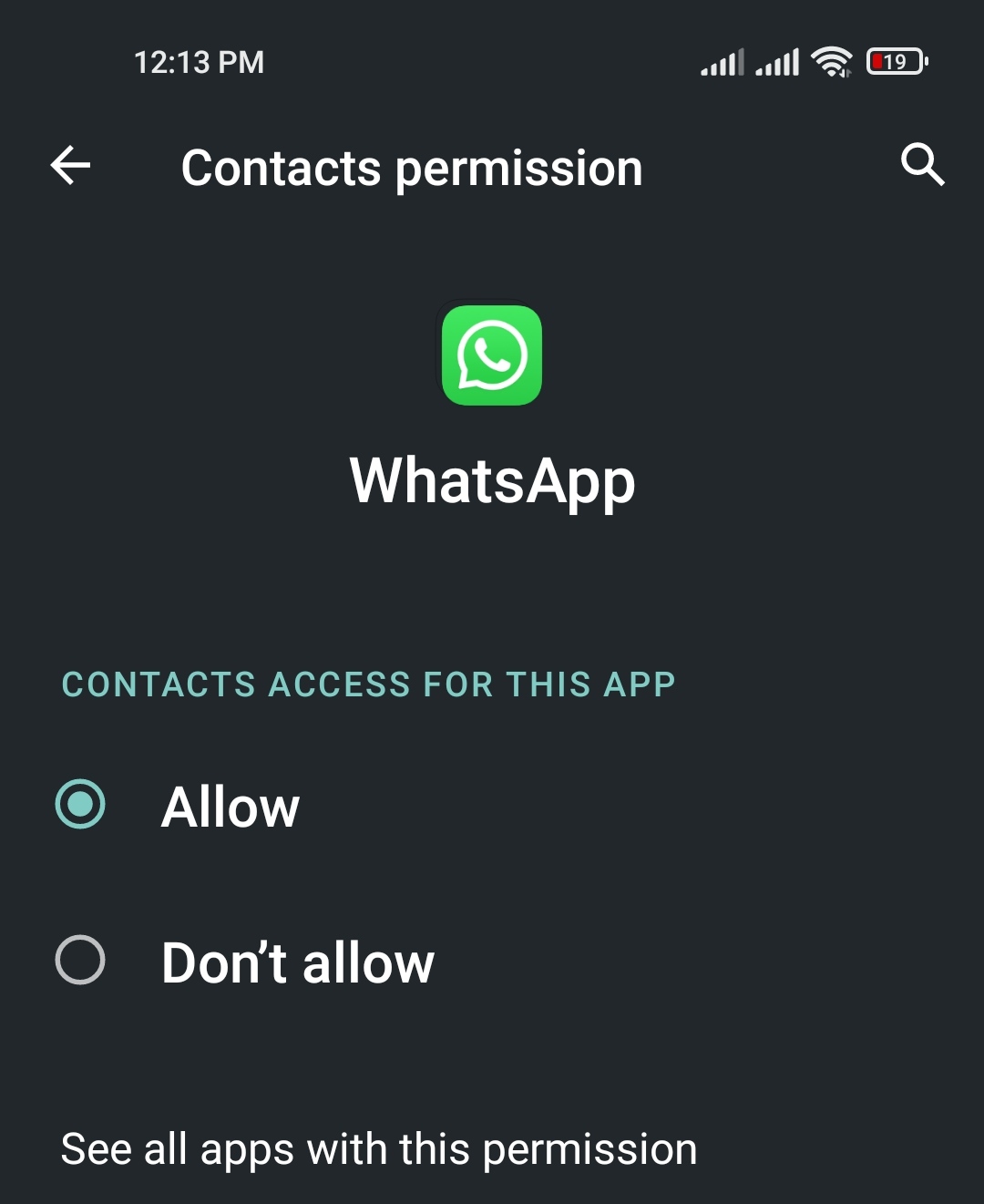

Hello members, when I open Whatsapp the names of my contacts do not appear but only the phone numbers. I have set miui Optimization to no limitation and automatic start and still have the same problem. Does anyone knows how I can fix this? My device is the 12x.
Settings, Apps. Manage apps, search for WhatsApp, Permissions, Contacts
You must allow Contacts permission for WA as on the screenshot
Similarly if you would have problem with any other app and its permissions
Every new version of MIUI is by default more and more restrictive on permissions - and many apps do not do proper business on installation to require all permissions they would later need
It's not necessary. This is done automatically during the installation (update).
