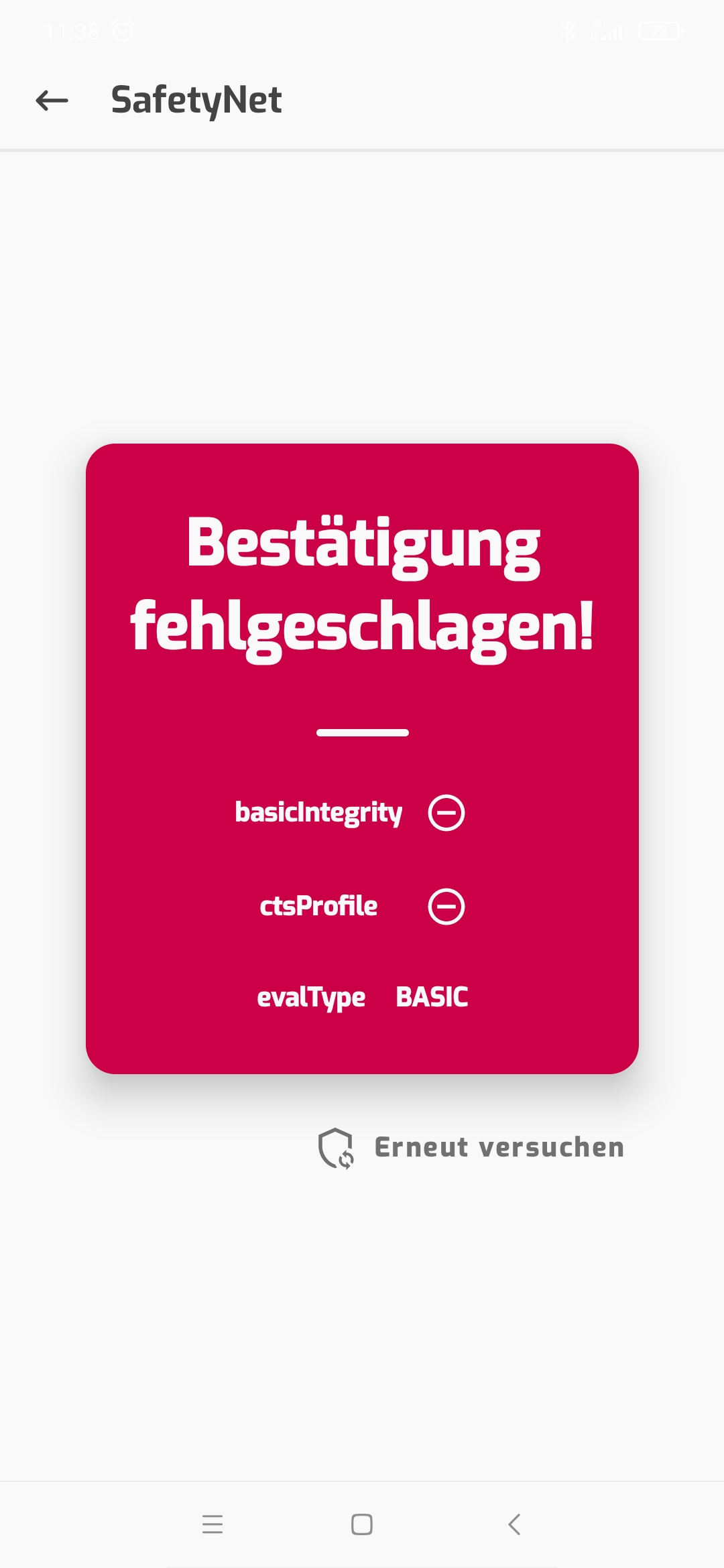

I successfully installed this ROM on my Mi10T Pro with global version plus rooted with Magisk. First I installed stock ROM (downloaded from official source, fastboot install mode and let it first start). In fastboot booted (not flashed) to TWRP recovery (Whyle) and with that I installed this ROM. This is worked fine and the phone is ok. I have found several Magsik patched boot image but no one worked for me. Then I installed Magisk 11 via recovery and updated that after phones started. In first case I got bootloop then reinstalled Magisk 11* and now I have a working root on my Mi10T Pro (apollo) with up to date Magisk and SafetyNet check as well.
Before I had problems with cloned Viber but now it is runs great. The one thing: if you have backed up Viber on Drive, before restore step in the corresponding account on your device after that the cloned Viber can restore the backed up data.
Good luck,
G
*Edit: after bootloop I installed Magisk 21005.

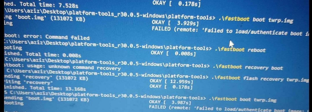

I tried but when I give them command fastboot boot twrp_umi.img it gives me ok then failed as in the images I posted yesterday I tried the boot method img but nothing

it works for me only if I install the twrp 3.4.0-11 but without files inside
ok thanks to all I installed twrp 3.4.0.11 then I rebooted in twrp I rebooted in boot then installed the boot .img and rebooted and the phone started
Thank you very much now I no longer have any twrp has the stock recovery if I wanted to install the 20.11.12 do I have to install which twrp and do I have to use otg USB? Thanks
Power of the phone then hold all 3 buttons vol+ , vol- and power and phone will enter at twrp ..
With this twrp you need usb otg for next update and you will be fine..
EDIT
If i saw a screenshot of your commands and fails i will understand better your issue , I'm pretty sure that somewhere you made a mistake ..

This is the failed to load error ....
