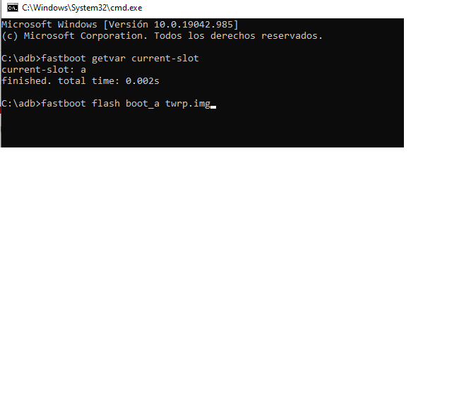

What are you doing? Why are you flashing TWRP?
because twrp is necessary to install the room ...
if we use this commands doesnt work:
fastboot flash recovery twrp.img <--- not woks because we have a partition problem
fastboot boot twrp.img <----- not works, only we will have a black screen and a reboot
Redmi k40 pro users can't update the room because we don't know how

If TWRP for your device has issues , probably because it's a new device and TWRP still is under development you can easily update with fastboot.zip rom through fastboot mode ..

1) You don't have "a partition problem", boot-as-recovery devices don't have a recovery partition, hence the "boot-as-recovery" nickname.
2) You're not supposed to flash TWRP, only boot to it.
3) We are now aware that the Chinese TWRP released for your device doesn't work as intended, flash the fastboot ROM.

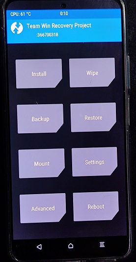

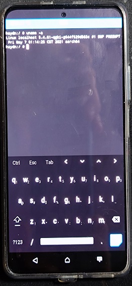

Hi all.
I did update my K40 Pro to 21.05.20 via TWRP.
As the "prefererred" way of booting the twrp via fastboot (fastboot boot twrp-3.5.1-haydn.img) did not work ,
I did a little research and somehow I came up with this here.
Prior You have to flash both boot slots a and b.
- fastboot flash boot_a twrp-3.5.1-haydn.img
- fastboot flash boot_b twrp-3.5.1-haydn.img
After that you can reboot into recovery.
- fastboot reboot recovery.
In "Advanced" Menu of "TWRP" you have to choose Onkey Inject TWRP.
Decrypting /data- partition, booting into the system and booting into recovery and fastboot works.
Regards,
Petros
