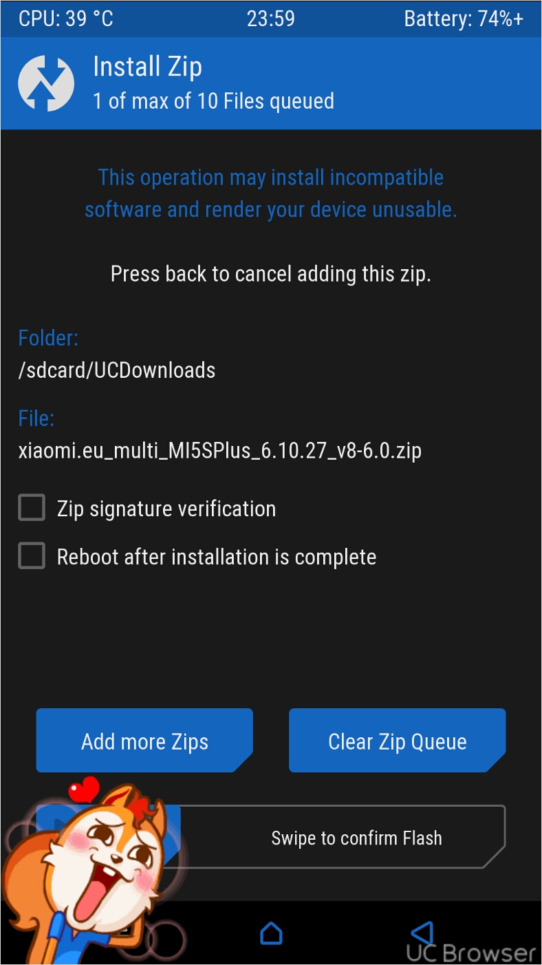

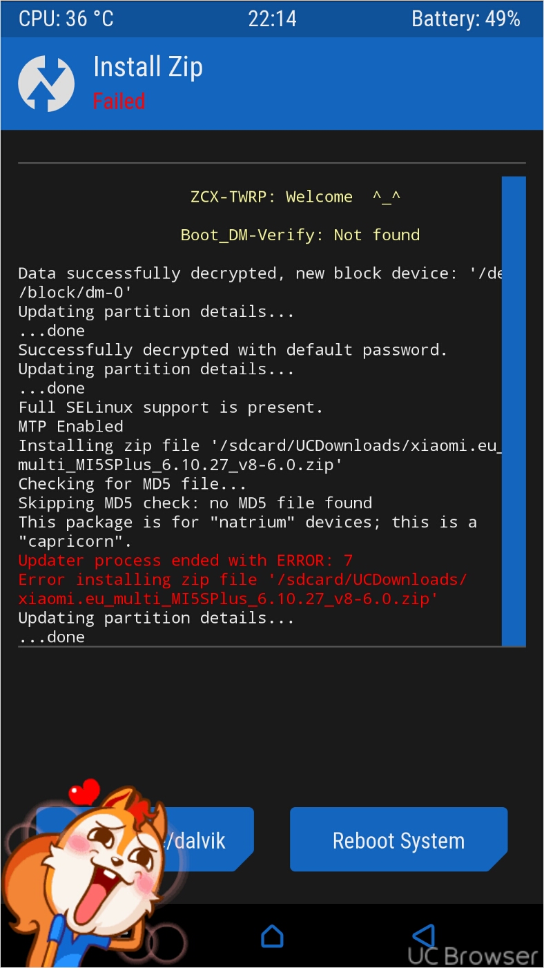

Mi5s Plus cannot flash this rom have an error

The error message appears that you have installed a rom for "Capricorn" (MI 5s).
Inviato dal mio MI 5s Plus utilizzando Tapatalk
I install rom for Mi 5s plus then me flash why it show "Capricorn" not "Natrium'
