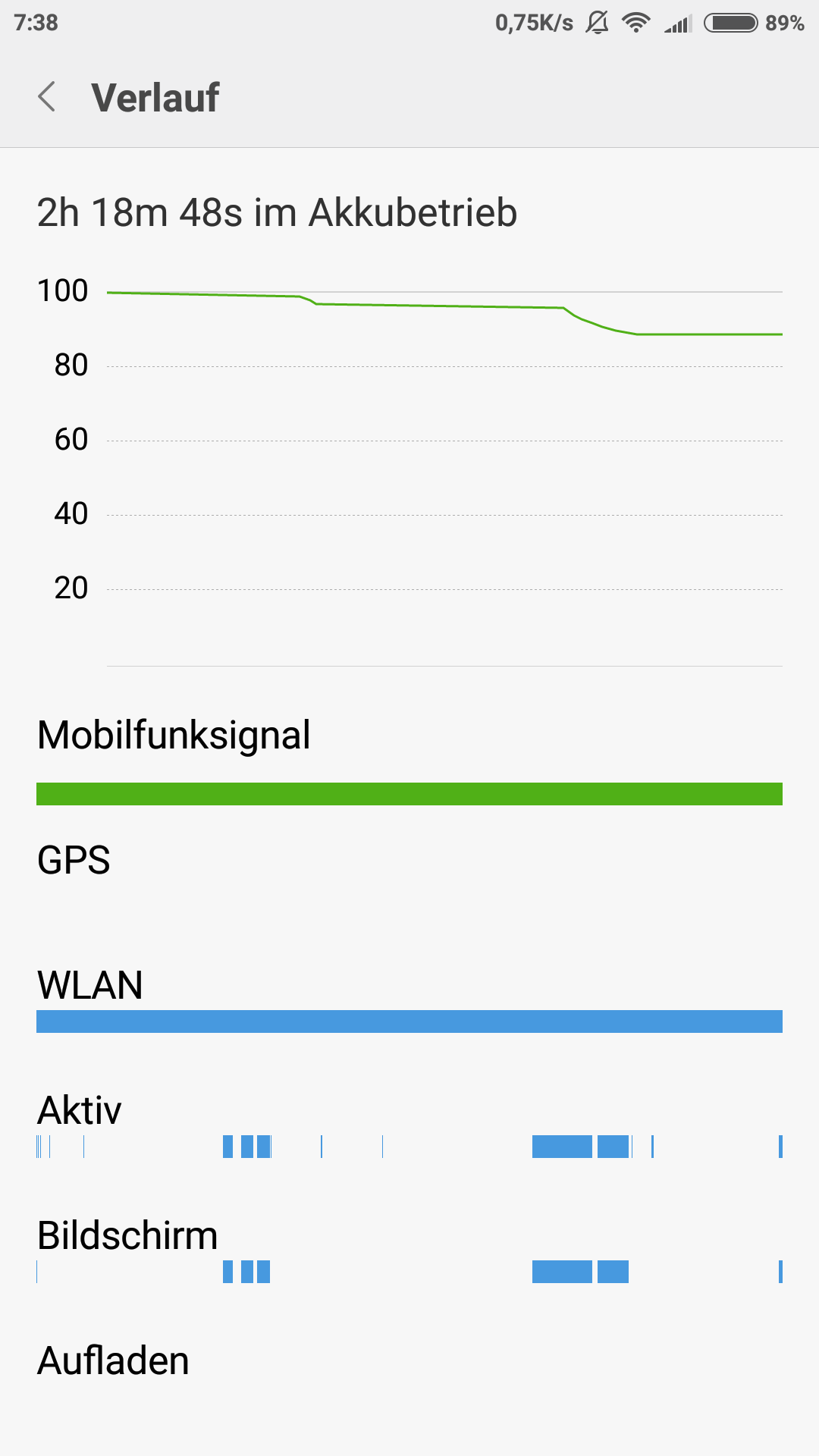

I got batterydrain on rmn3. Caused by fingerprintscanner. Phone don't go to deep sleep when FP is on. Without FP deep sleep worked and battery is awesome then.
Gesendet von meinem Redmi Note 3 mit Tapatalk
