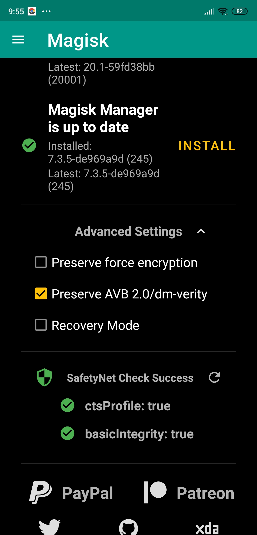

Thanks for the crazy great work again !
But flashing magisk will cause booting into fastboot
Not support yet or ?
It works, use the canary build.
