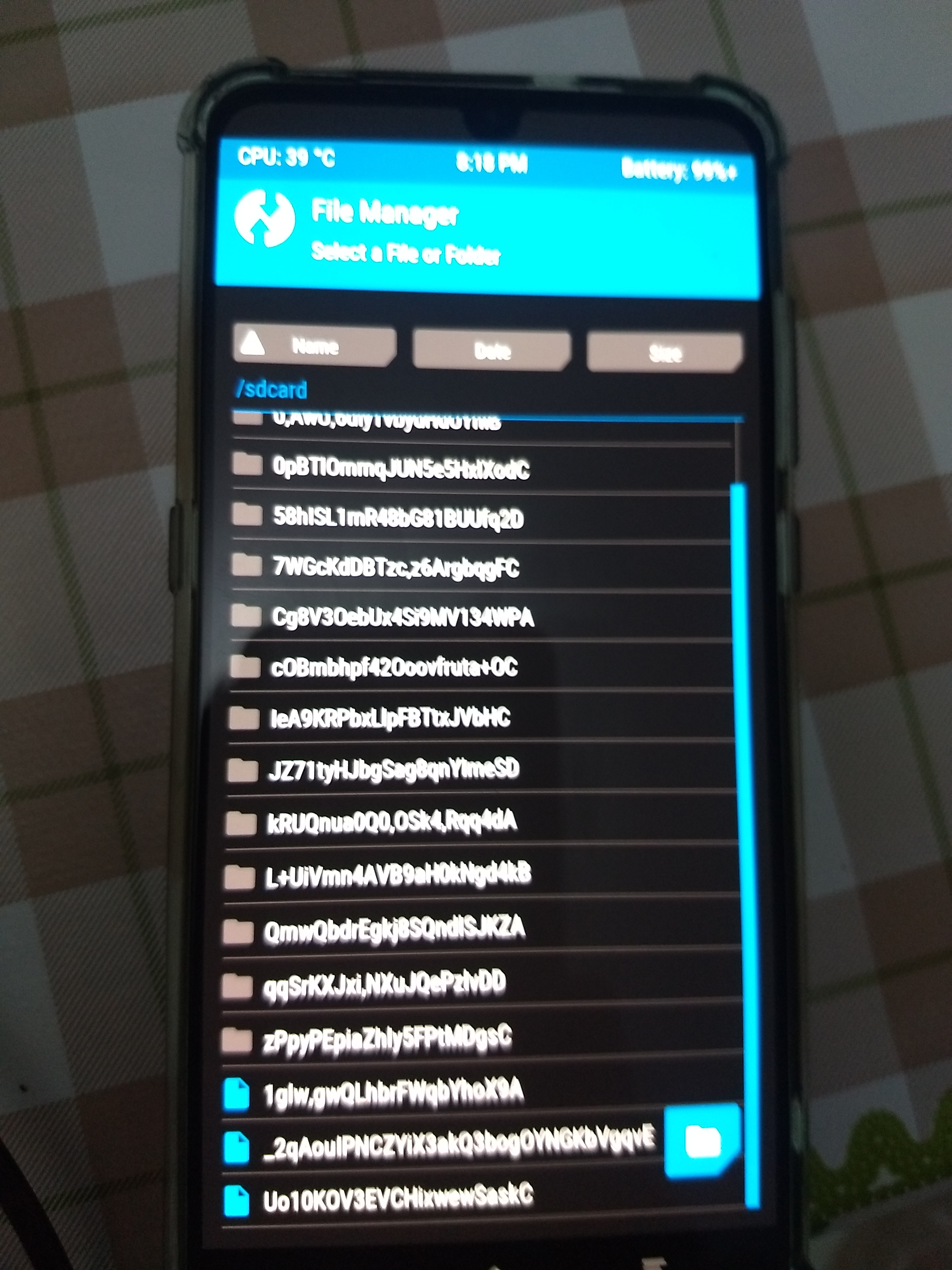

Hello Guys I asked 2 days ago if I can Came from stock rom without remove Encrypt of my phone.
I receiver a answer that supports....
Then I installed TWRP and make a reset, Flashed the rom and at the end, make the last wipe...
Now I am stucked at TWRP and I can't send nothing to my phone, and when I browse the files are this way, how can I Fix this?...

format data and type YES

glad to hear that
Thanks for the fast help, the comunity is great, maybe fixed a tip to noob users like me in the first page can help someone with the same issue.
I am testing the .EU now and it's more beautiful than stock and the google feed is amazing ._.

If you received an answer, it wasn't the good one because you DO NOT FORMAT DATA (with yes confirmation) in the wipe section of TWRP before installing EU rom.
THIS IS MANDATORY when coming from ANY stock rom!
This is called as CLEAN install name.
