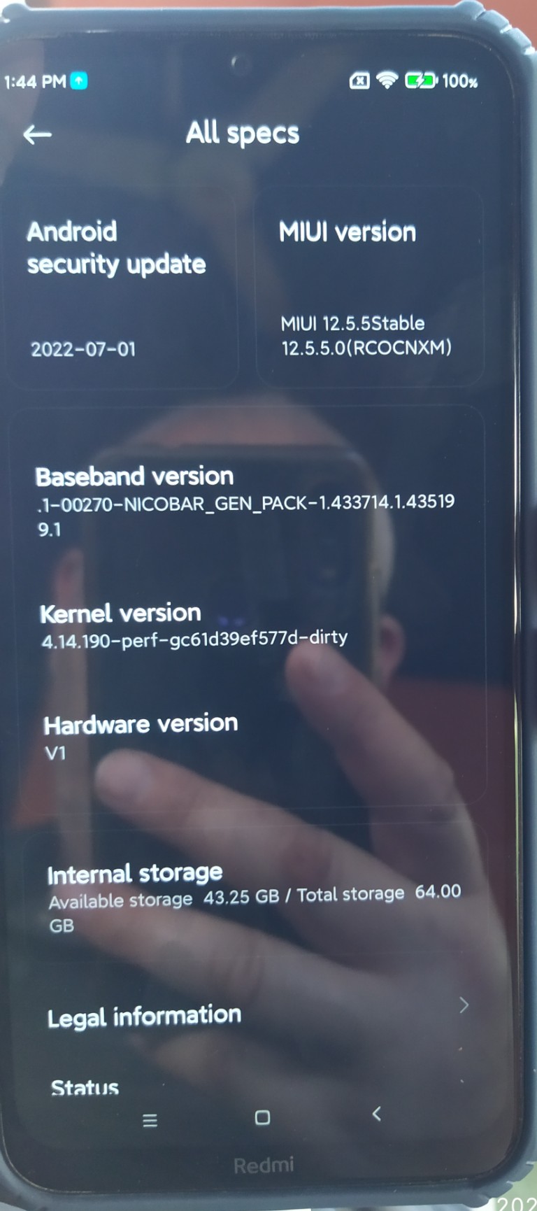

Later it turned out the phone is Original CHINESE Redmi Note 8, modified by seller and had Global ROM android 11,MIUI 12.5.2.0 installed - AND Unlocked bootloader in order for everything to work.
I had a local phone shop unlock bootloader, install Original Chinese stock Rom and recovery(English though) 12.0.x.x(can't remember the excact version, but android 10), and lock bootloader again. Everything worked but I couldn't install Google Apps or Play store. Then I saw there were an OTA update, and it updated to MIUI 12.5.5 Stable 12.5.5.0(RCOCNXM) Android 11.
But still couldn't get Play store Installed. I tried all Google installers from the net, all installed but I couldn't toggle Basic Google Services to ON.
Did a factory reset, now phone worked quicker but no matter what I have tried so far will make Play store work.

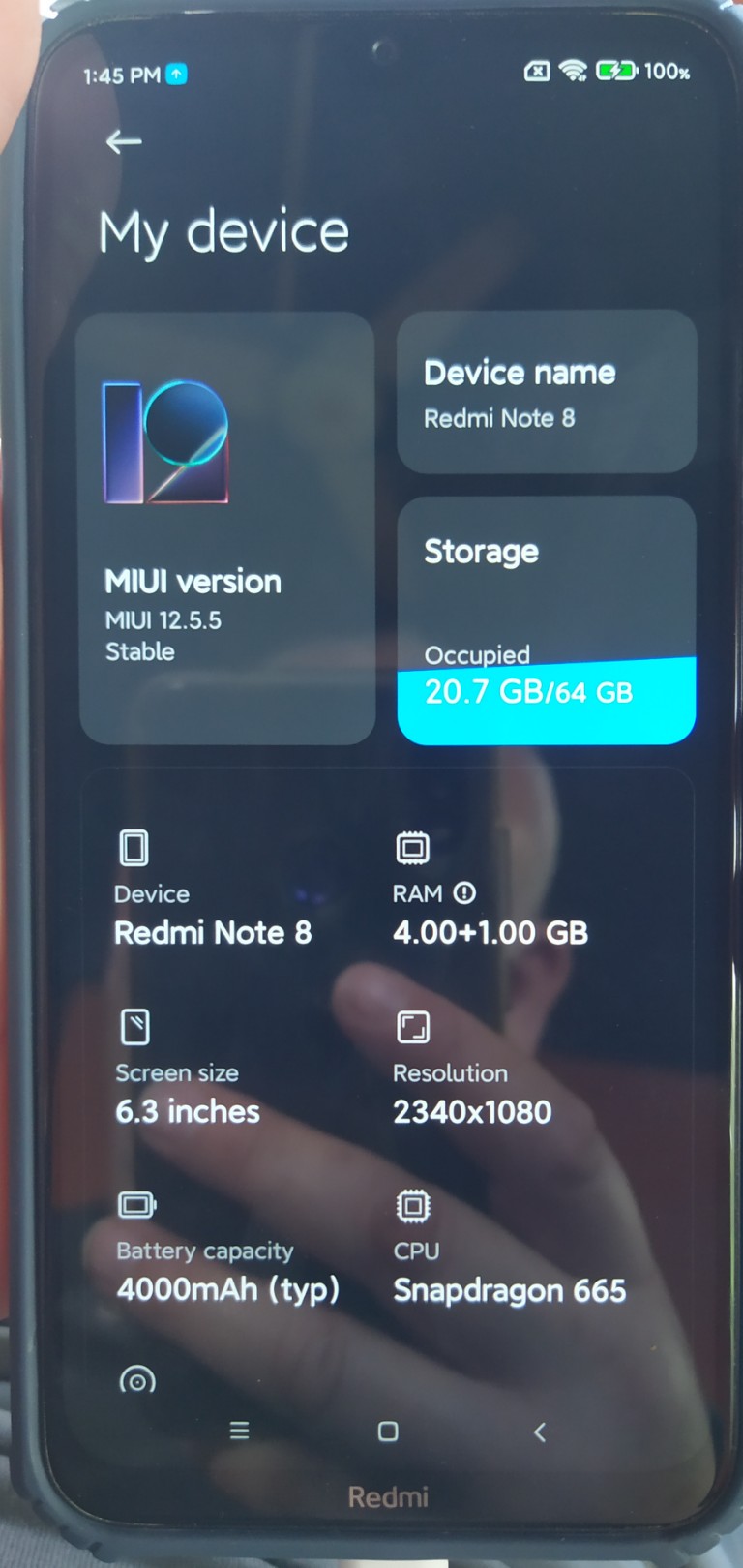

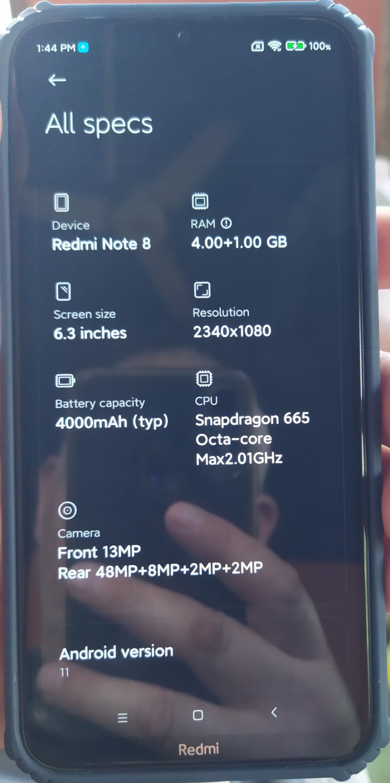

Phone:
Redmi Note 8 M1908C3JE 4/64
48Mps
gingko
This is NOT the 2021 model!

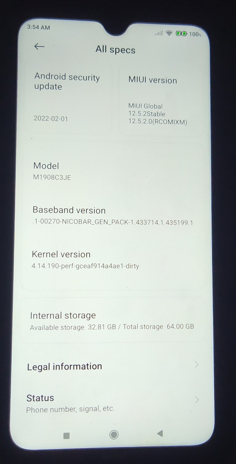

EDIT : I got the local phone shop to unlock bootloader and flash Global ROM MIUI 12.5.2.0 and leave the bootloader unlocked. Everything is working without having to root - Well, banking Apps are not working and will not work with unlocked bootloader.
So I am going to sell it again.
Too bad that there is no solution for this
PS2: If anyone of you know how to remove password protected Lockscreen on Samsung Galaxy A31 SM-A315G/DS without data loss, then please PM me.

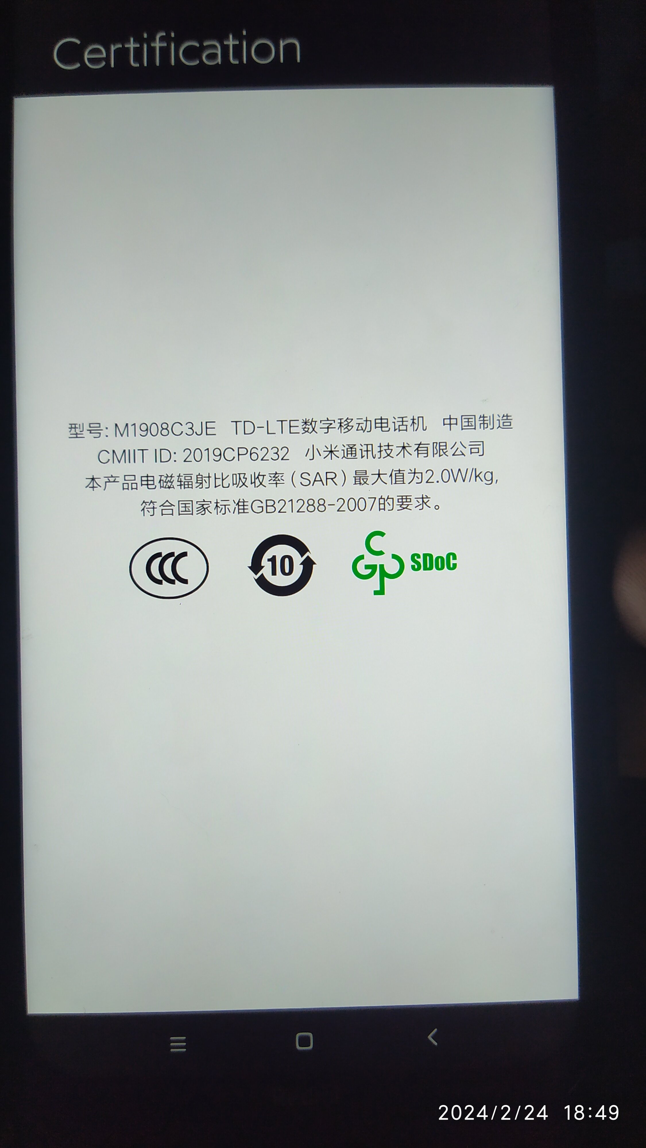

Photos attached - Certification is the same on both Setup's.
The photos with white background are from "Original" Setup when just bought
