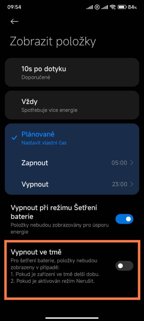

Turn off in the dark To save battery power, items will not be displayed if:
1. The device is in the dark for a long time.
2. If Do Not Disturb mode is activated.
