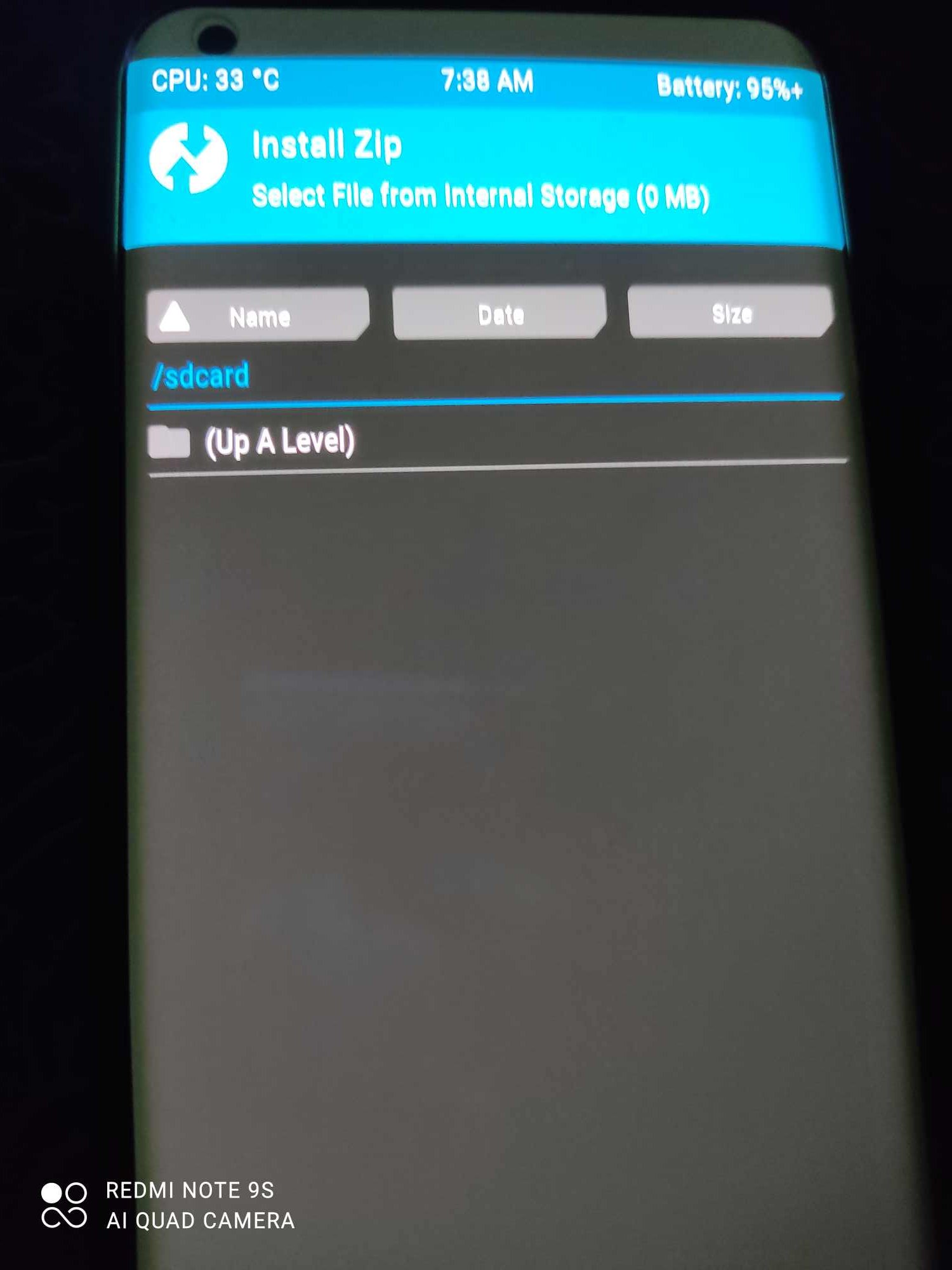

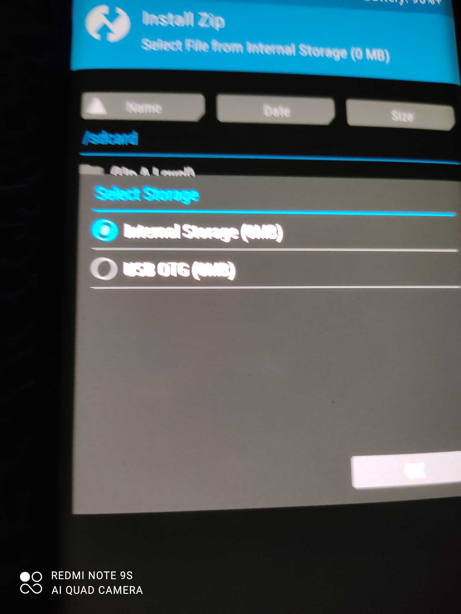

hello I have Mi 10 with rom xiaomi.eu from november 5
I succeed in downloading and opening recovery twrp
but i cannot copy the new rom 11-12 to mu mi 10. Every time ít sáy material not found or has been unplugged
So can you describe the whole procedure hơ to install the new xiaomi rom ?
Thank you very much
I allways intall updates via USB OTG.
Start TRWP select storage USB and install from stick
That's it

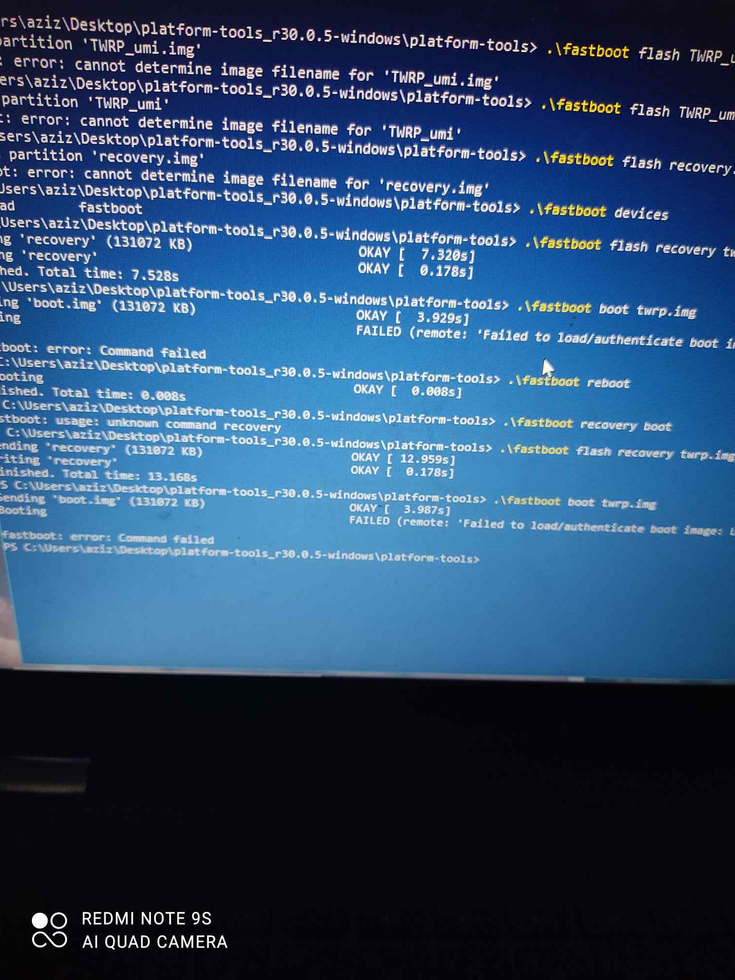

Which is the name of the recovery in the folder? Twrp_umi.img? If yes, than type fastboot boot twrp_umi.img
Gesendet von meinem MI 3W mit Tapatalk
I rename It in twrp.img but not boot i renamed in twrp_umi.img but not boot
the twrp that I had before when I entered it asked me the sequence for the release, can it have something to do with it?
I tried to install the other img from before but it always comes back in fastboot, instead it used to go to twrp but could not find any files now it remains in fastboot sorry so much for the trouble thanks

I tried every thing. Boot and flash, but always return with error.
Somehow, i enter in some kind of bootloader menu .
After that, it returns to system.
Now i am afraid going to twrp
On Poco f2 Pro , try to boot at new twrp at first post ..
fastboot boot twrp.img
Phone must be boot to twrp , then reboot to system ..

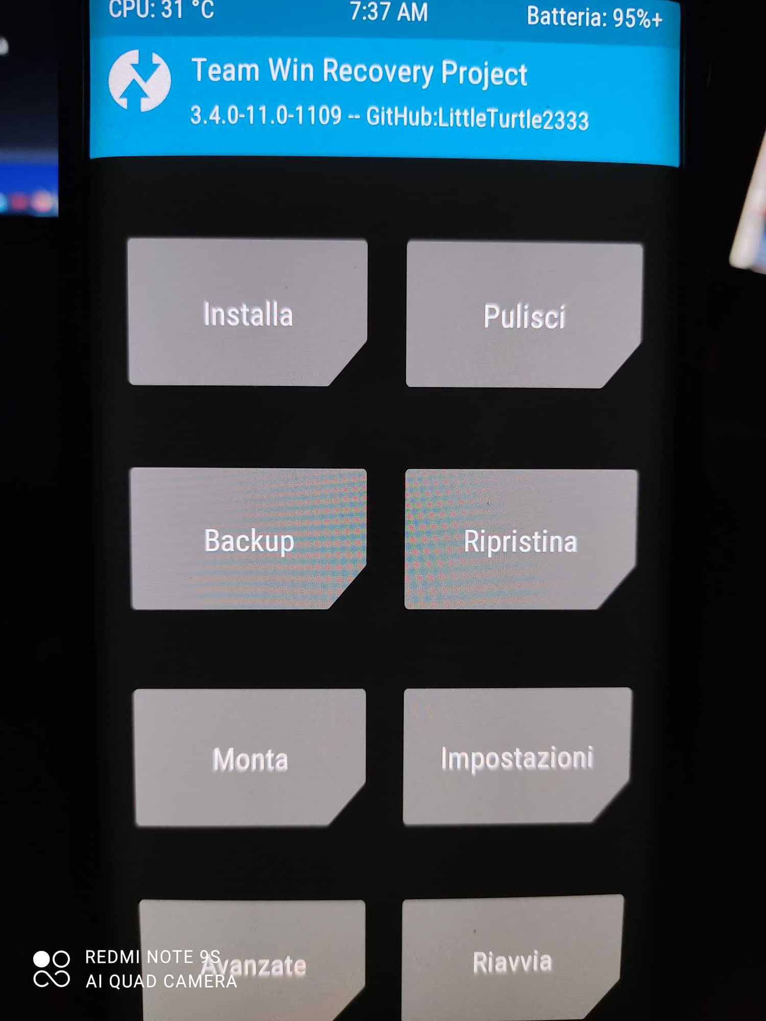

then I extracted the recovery in the file 20.11.12 I install it and it enters me in twrp but I have no data. i try to install the twrp you gave me when i give them reboot recovery back to fastboot
i'm desperate i don't need the update anymore i just want to get my data back
