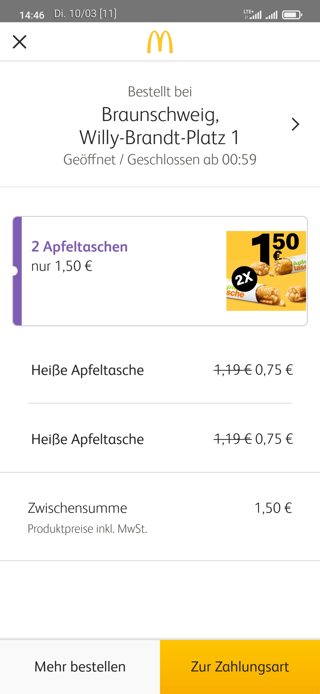

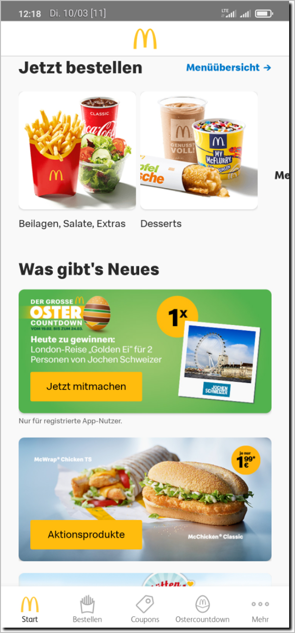

Can you guys check the Mc app, is it working on your phones ?
do you mean this one ?

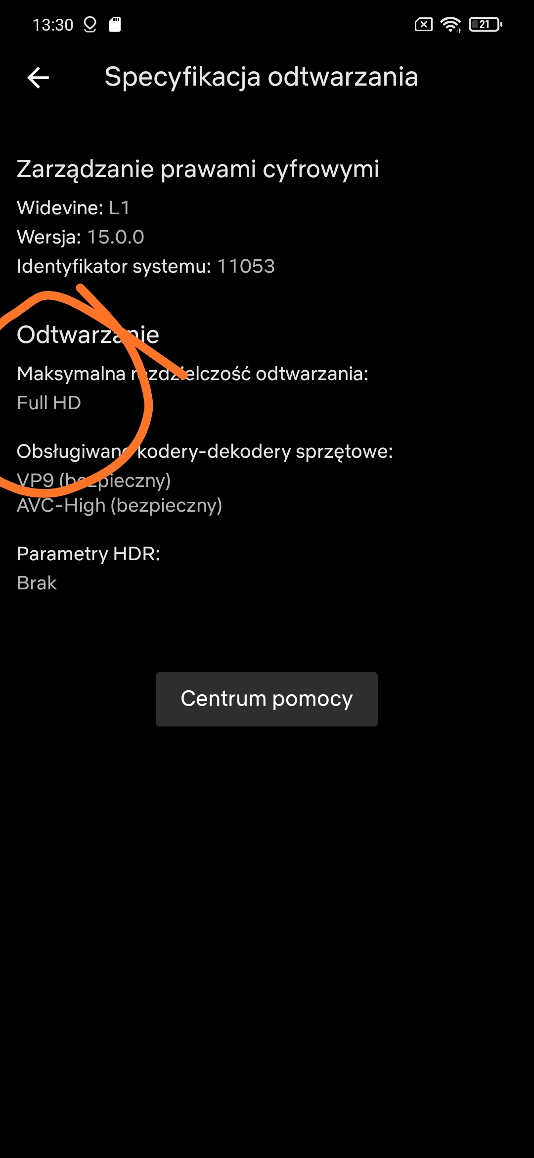

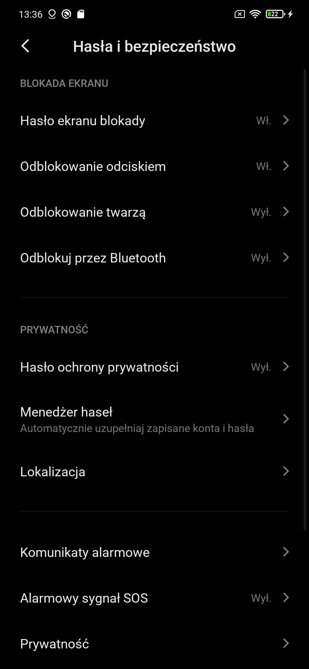

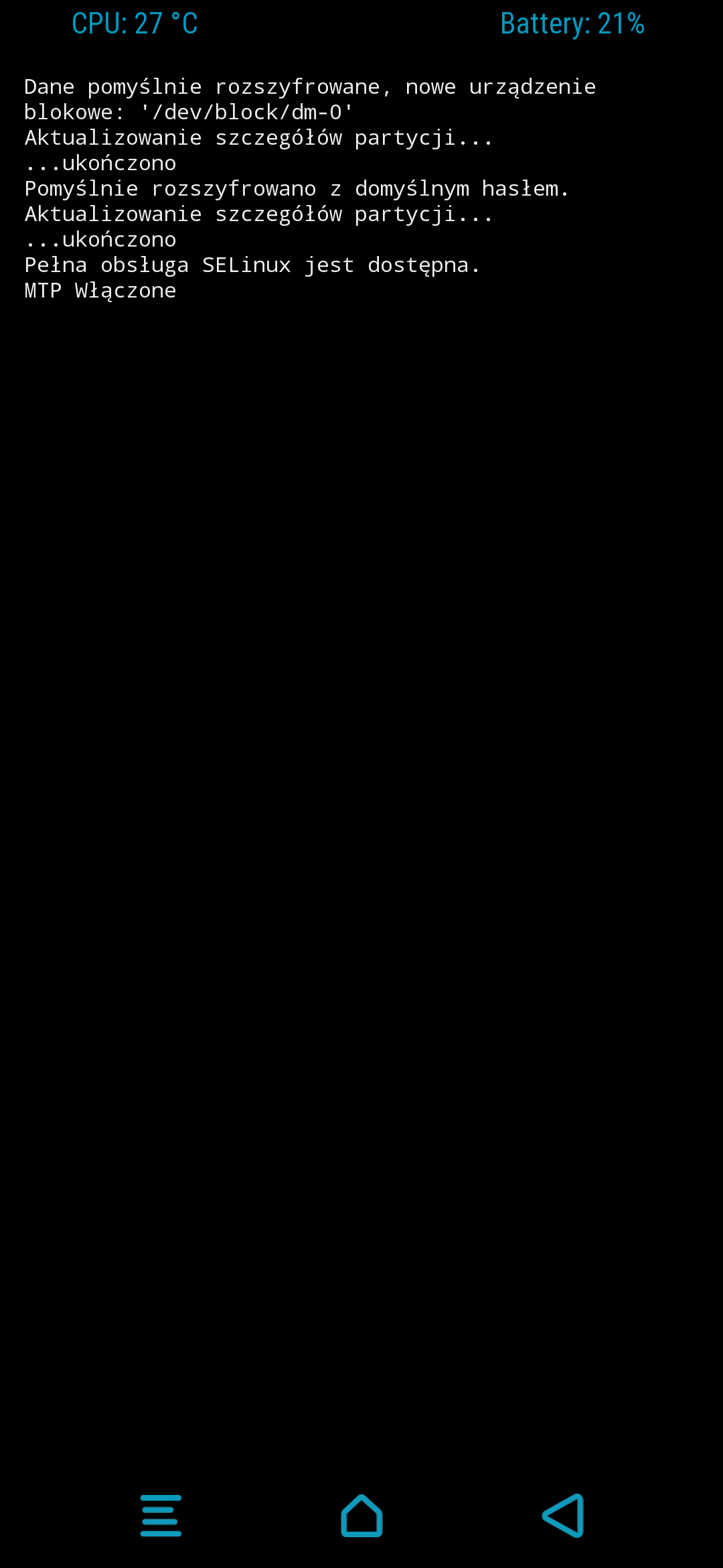

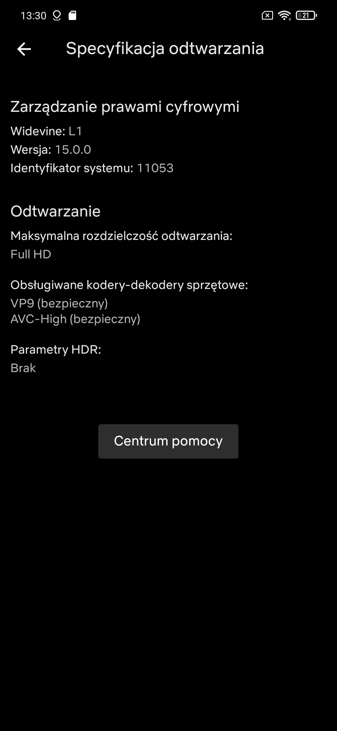

The solution for lavender.
Download keymaster file.
Rename to km4.mbn
flash from fastboot mode.
"fastboot flash keymaster km4.mbn"
Boot to twrp , format data and reboot to system
i use this solution and i set my new fingerprint and pincode dont work
Edit1:i just reboot system twice and now working YEAH!
i have 1 problem :no google play xiaomi certificate
Edit2: i check now problem solved Love for geoanto555 <3333
Edit3: Dreams come true Netflix support Full HD Resolution
