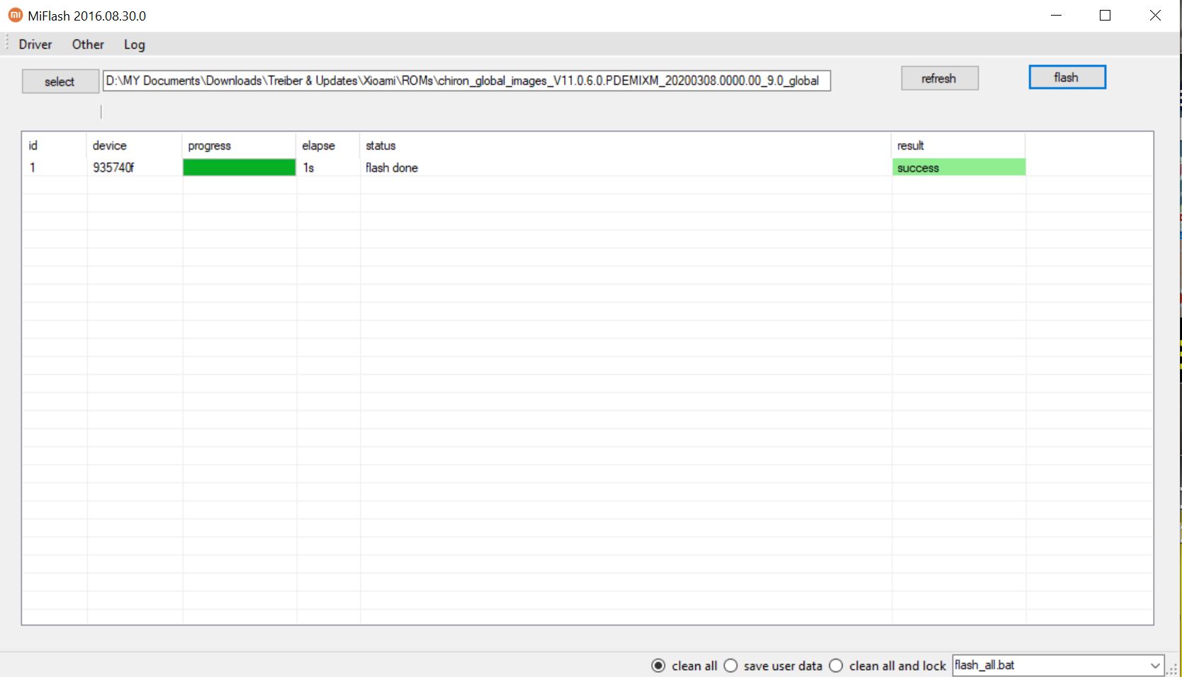

I have a huge Problem and hope someone can help me. I did post the Problem in another Post under the Mi Mix 2 thread 2 (https://xiaomi.eu/community/threads/help-needed-miui-12-installation-wiped-os.55699/)
I followed the install instructions at the top of the to the letter installing TWRP and then (re)unlocking my Phone.
I was informed that unlocking would wipe all the data so I backed everything up first.
I set up the phone again and started the MIUI 12 installation
After the installation process the Phone is stuck on the Mi Logo constantly turning on and off.
I booted into TWRP and get the message that no OS is installed.
I reinstalled the Fastboot Rom chiron_global_images_V11.0.6.0.PDEMIXM_20200308.0000.00_9.0_global via MiFlash 2016.08.30.0 and got a doubtful (because after 1 second) success message but Phone still does not boot.
TWRP still says no OS installed.
29738
I do realise that the problem is that USB debugging is probably not enabled on the (Android free) Phone and that I cannot enable it without Android running.
With USB debugging enabled I should be able to use adb or MiFlash to restore Android.
So, does anyone know a trick to enable USB debugging if the Phone does not boot and has no OS installed? Or any other trick to restore even a previous version of Android?
TWRP is still available to boot into.

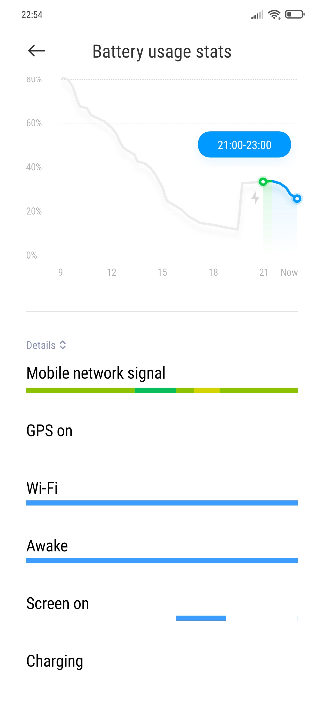

This new build also has problems with sleep. The first miui 12 build would go to sleep normally but now the phone is awake 100% of the time. Even while locked for 8 hours overnight
Same here. Phone is always awake.
Reactions: leobahlis

I did as I wrote above.
Unfortunately Phone cannot restart without an Operating System and on mine it's gone.
He told you to install LOS or anything else from XDA for your device as long as TWRP is still working! And then not wipe, but format DATA in TWRP!
PS: Flashing with Mi-flash cannot work with such a long path! It must be in a folder directly on C:\ with names without spaces!
Thank you JeJeMc and Bernd,
moving the Rom to c:\ allowed me to install it via Fastboot and mobile is working again.
Many many thanks
