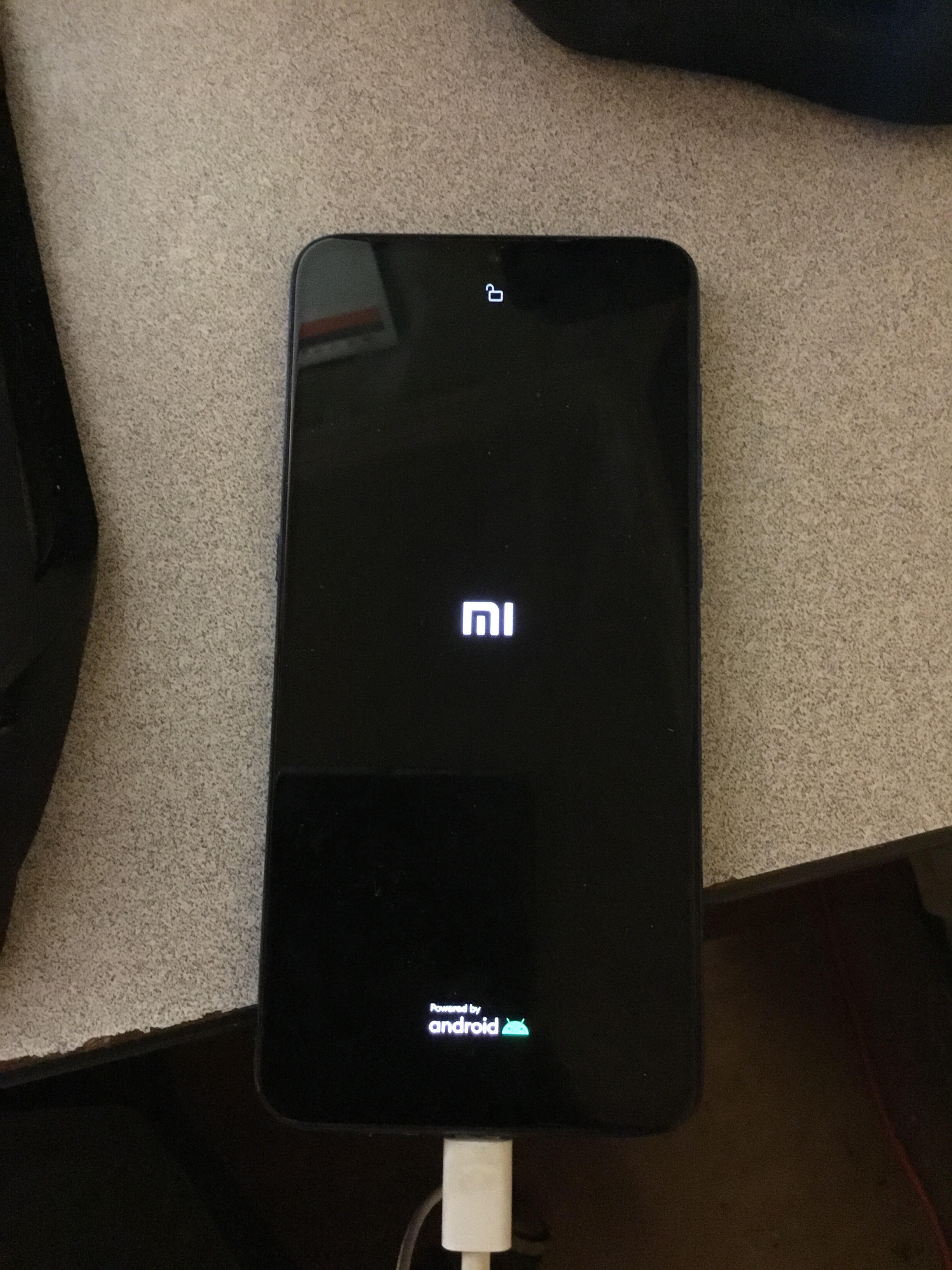

Hey guy I manually downloaded and installed this update to my MI 9, then it asked if I wanted to install TWRP, and I said yes. Now it's just boot looping to the screen that says MI - powered by android with the unlock icon at the top.. I can get it to fastboot mode if I hold volume down and power.. what did I do wrong? any ideas on how to fix this? I tried using fastboot to revert to an older TWRP version and it still boot loops to that screen

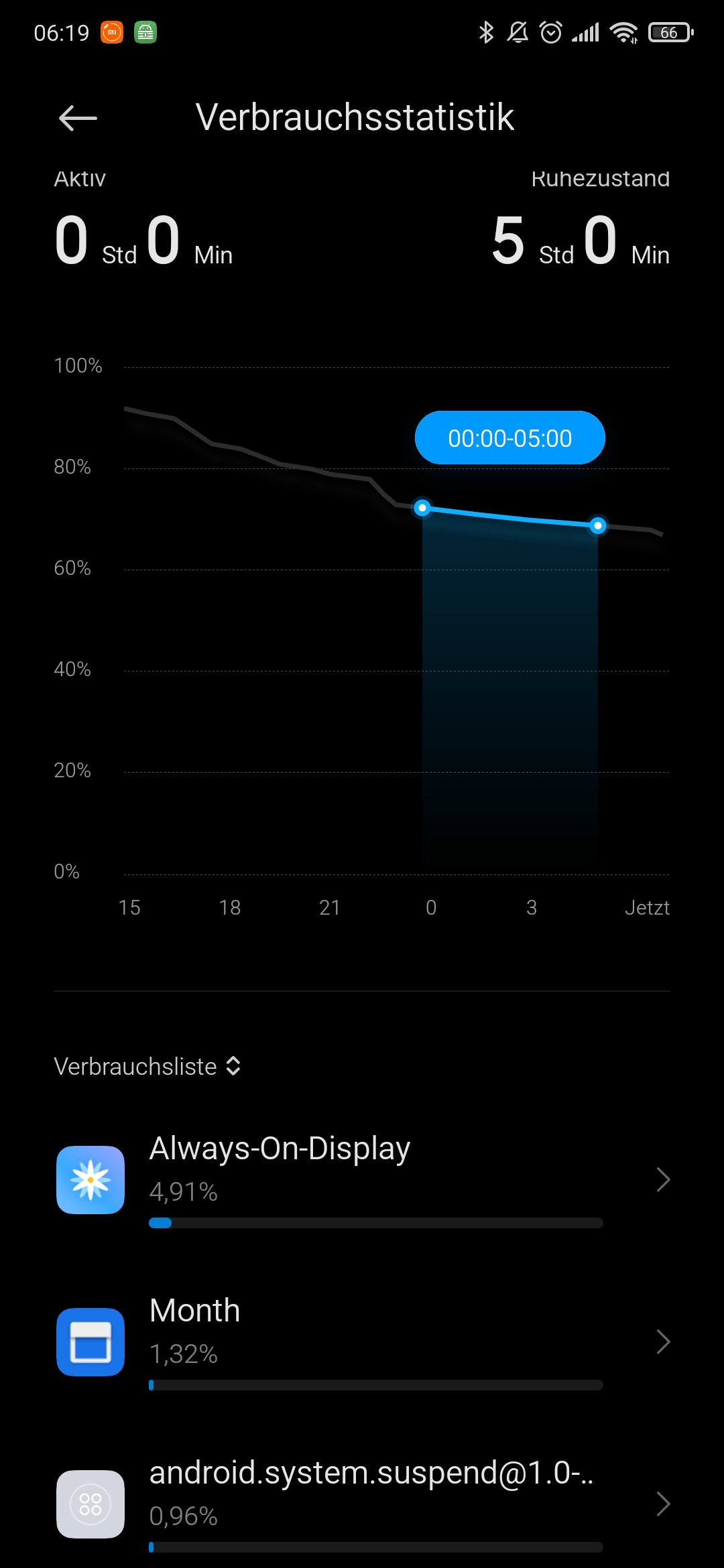

Yesterday I changed from stock to xiaomi EU and have a problem with AOD
Even though it's turned off it uses about 15% of the battery.
Any solution?
I got the same issue. My phone lost 5% battery over night with turned off AOD.
Why would you want to install twrp if it already had twrp (if it didn't, how did even flash it)?
Go to fastboot, reflash twrp for your device, reboot to twrp (vol up+power), flash rom, flash dfe, boot.
You need to format data if you're coming from stock miui.

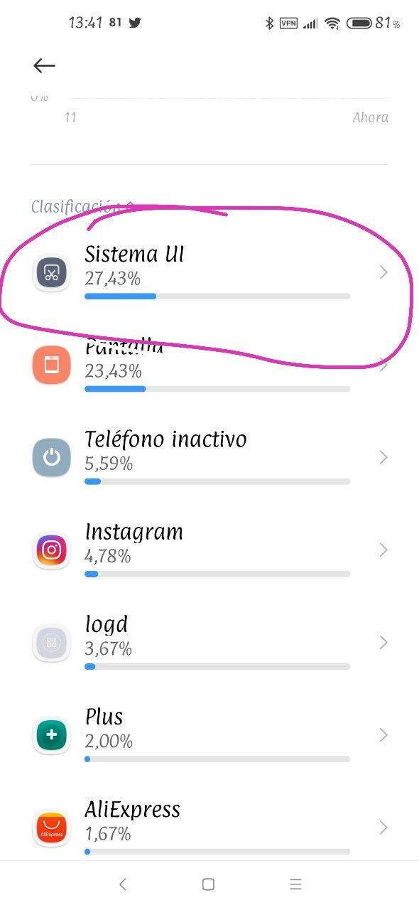

Firstly!! Thanks for your great work devs and testers!! Does anyone know what UI System is and why it consumes so much? the battery is worse than in the previous version, in my case.. maybe because of the UI System. Thanks!!!!!
MI 10 Pro - 20.9.3
