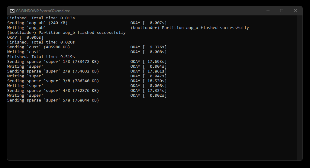

Mi11 - 3x redownload, can't install that :( Always stack at 5/8
'super' can be a very large file, so there may well be a delay. I do not know how long for with this method. But make sure that you give it enough time (maybe 5 minutes?).
