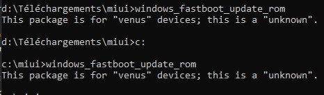

Looks like some problem with your Windows' standard utilities...
In any case, remove these lines from the flashing script:
Code:
set DEVICE=unknown
for /f "tokens=2" %%D in ('platform-tools-windows\fastboot %* getvar product 2^>^&1 ^| findstr /l /b /c:"product:"') do set DEVICE=%%D
if "%DEVICE%" neq "venus" echo This package is for "venus" devices; this is a "%DEVICE%". & exit /B 1
You're running the script in the wrong directory, go one directory up and run the script again
Look at the screenshot you provided. You're running from ..\miui\windows-platform-tools\ you should run from ..\ miui
I repeat, i've tried everywhere...
