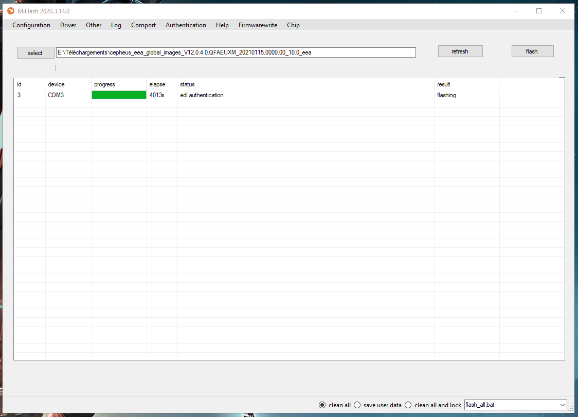

I update to the weekly build every week. so not sure what happened.
@FassTech
Flashing a ROM can't break fastboot mode...
Your device has a hardware issue and is now in EDL mode (I guess)...
I am more than 4000 seconds away, is that normal?
You may want to try and flash the fastboot rom using fastboot and not miflash.
While in edl mode.
I had a similar issue on a Mi6 and solved it using mi flash.
Make sure your USB ports are supported by the fastboot, (USB 3.1 doesn't work always, need a hub or USB 2.x ports)
Hope this helps...

Are you talking about the fastboot menu on the phone? If so, I can't access it, the screen stays off ;(
