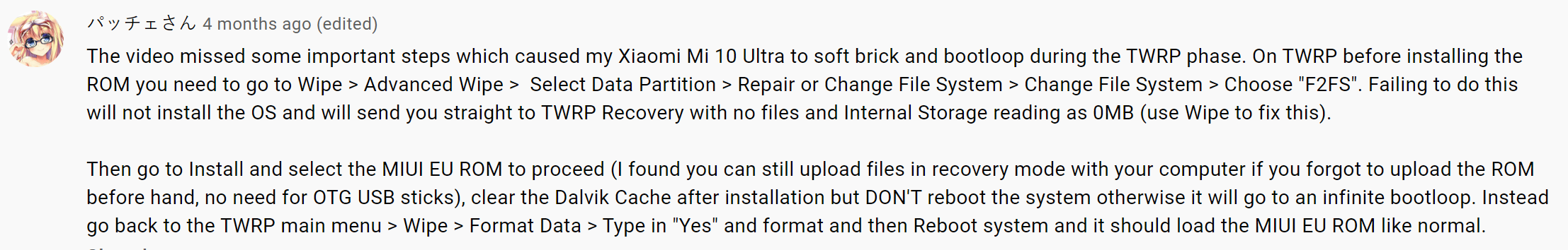

I'm a bit confused. From what I understand, twrp couldnt decrypt your storage, so it appeared as if you didnt have have any data while there were. Now did you somehow downgrade? How? Do you have the data back now?
The fact that twrp doesnt show up your storage means it cant access it, not that your data are deleted. Dont format, try other things first. You may want to try to update this (or the previous rom with a possible soft brick) through fastboot.
i have pattern when try to flash the rom first time i use this pattern to decrypt my data and after the flashing failed and reboot to the TWRP there is no pattern and the TWRP decrypt the data automatically

twrp is not decrypting anything automatically...is not asking for pattern anymore because it doesn't recognize storage...

do you think there is no way to recover the phone now?

after update fail twrp can't decrypt storage anymore...so no flash without hard format

This dude helped me to install previous build with 21.4.28 but unfortunately with a full format, luckily i did a week go backup with mi account and google account. restore 85 % of my data
The only way to recover the phone is to try to flash the previous ROM version. If the device doesn't boot even after downgrading and TWRP still can't access your data, then format data will be necessary...
Reactions: KGVER
The only way to recover the phone is to try to flash the previous ROM version. If the device doesn't boot even after downgrading and TWRP still can't access your data, then a format data will be necessary...
i can flash the previous version with fastboot? or must be a different rom not made for twrp?

i want to try to flash previous weekly rom (mi 10 ultra) with fastboot..i can do this or must be a special fastboot rom?
