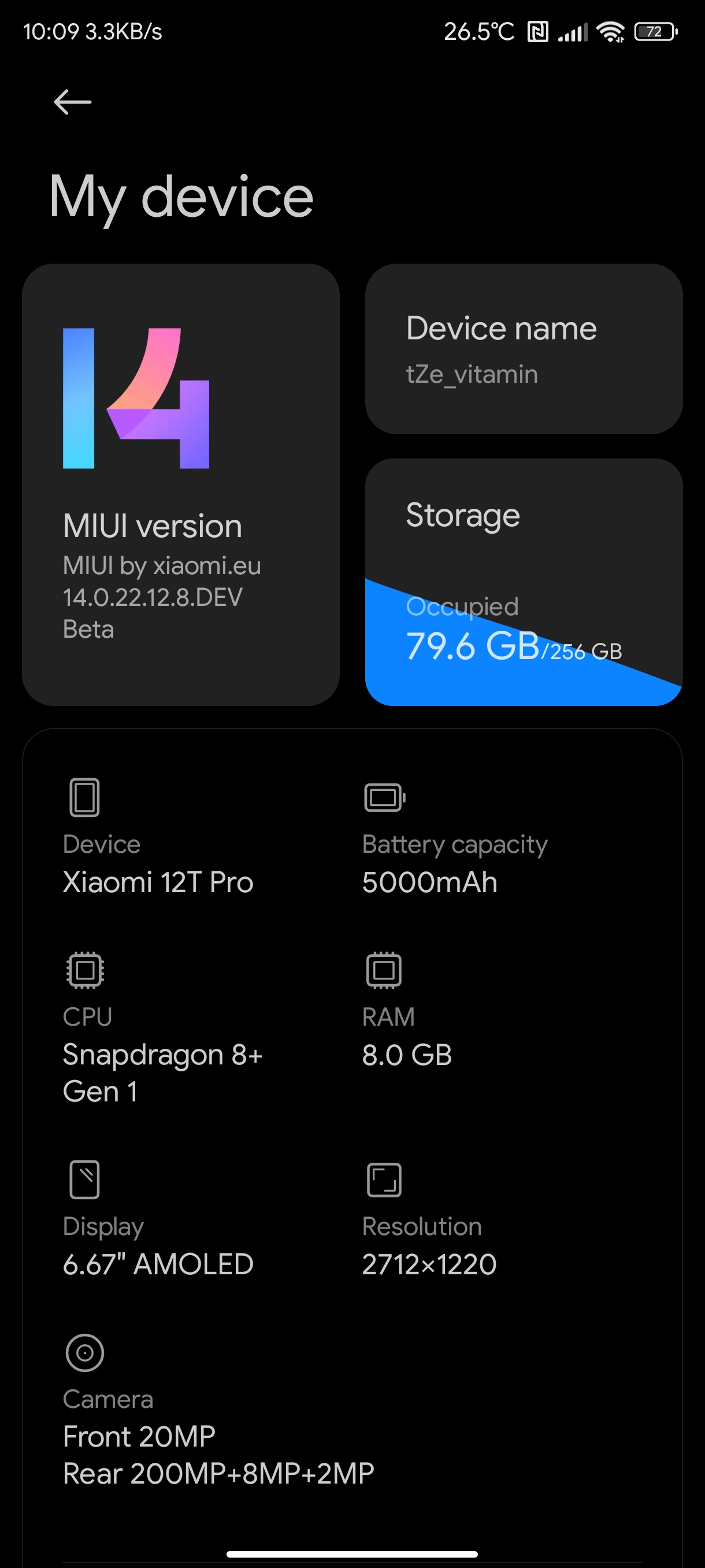

everything working after update to miui 14, TWRP is stay, I flash magisk ans some stuff in TWRP,
every app working , safety net pass.
bugs- Camera
Photo mode working
night mode working
pro mode , ultra wide , wide working
video working
long exposure working
AI watermark working
50mpx in pro mode not working
50mpx ultra hd not working
200mpx not working.
I use dirty flash , from stable 13.10.0 to weekly 14 , goes without problem ,data save, everything save,.

Just read the end of the first comment...
"Warning for Xiaomi 12T Pro users:
Due to missing main camera libs for that device, camera will not work properly until Global ROM based on Android 13 will be released."
Reactions: katerpanne
Can not be, was not before and when booting also not only after a few seconds and then bootloop. Come also in TWRP and there everything is normal. Maybe the download went wrong.

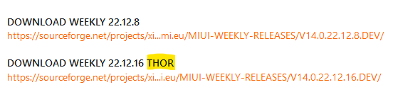

We must wait for thor @Spirous76 some thing is wrong.
Solution to not wait is flash again .11.
If 14 are rdy you can ping me so i can test it before you release, if you want chef ;)

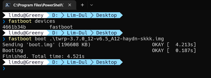

  8. Booted into TWRP via
    Code:
    fastboot boot twrp-3.7.0_12-v6.5_A12-haydn-skkk.img

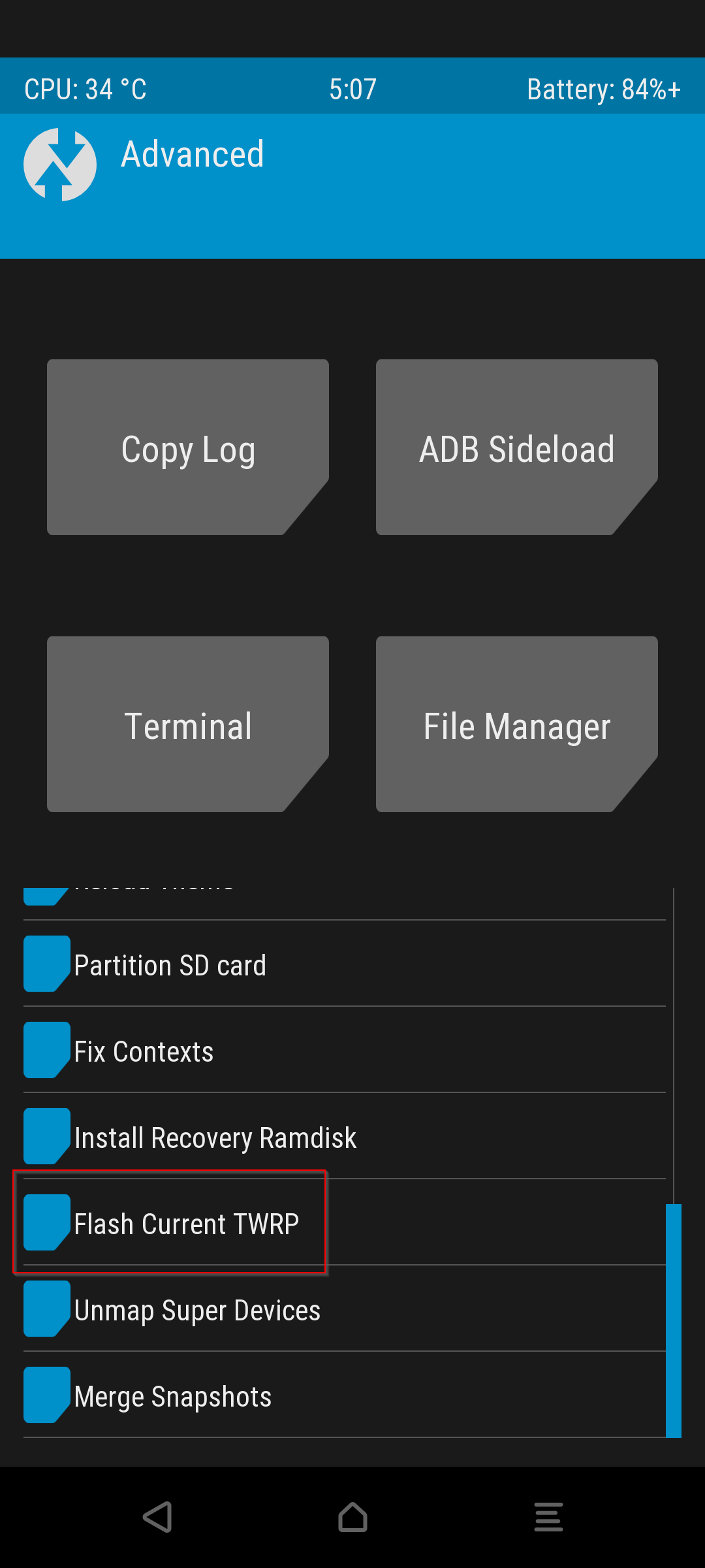

  9. Flashed TWRP via Advanced -> Flash current TWRP

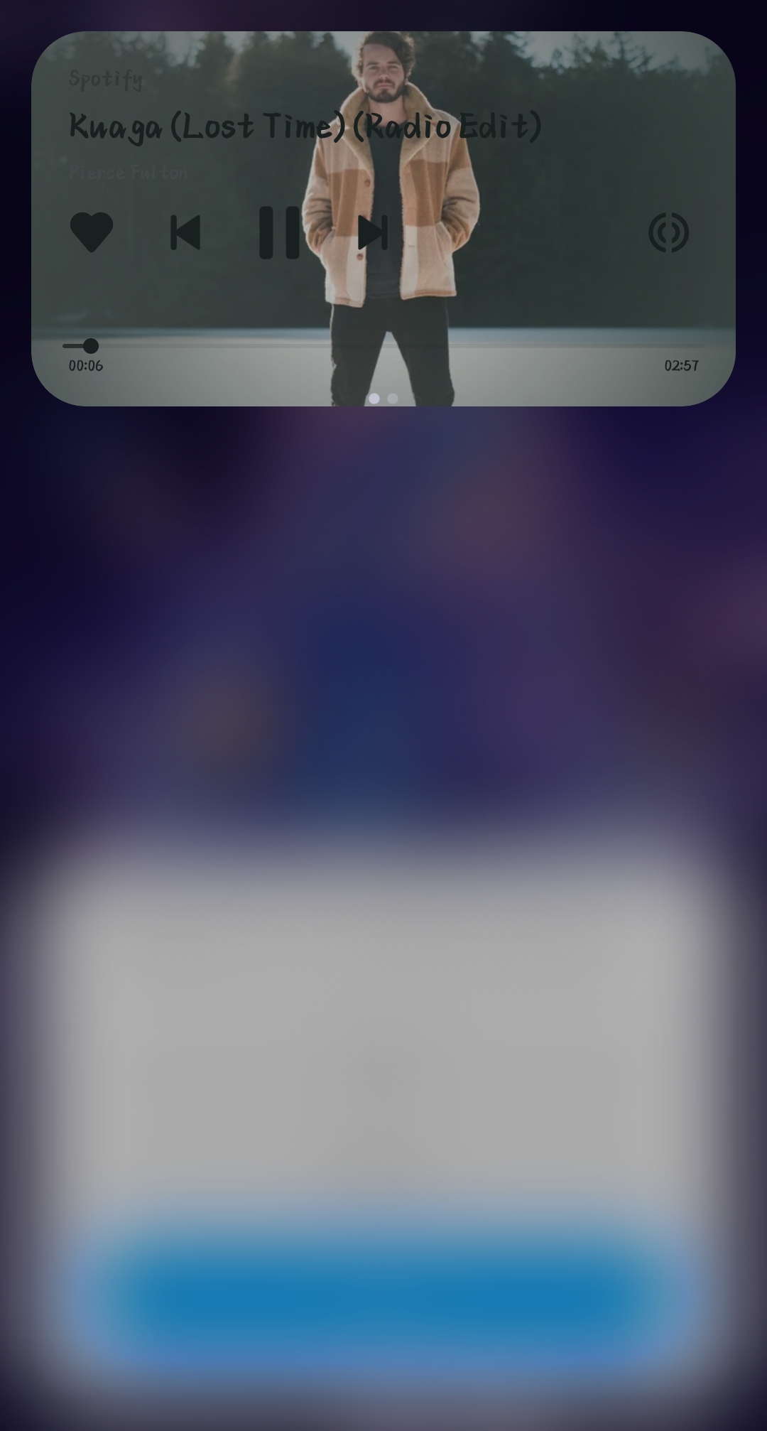

Little problem with this ROM so far: the music player in the Notification center dosen't show any pause/next/previous buttons, and there is no Android 13 animated-style music bar (by that i mean the little fun music bar that shows the songs duration).
Apart from that this ROM is perfect and seems really good so far.
Thanks for this amazing work, xiaomi.eu team :DView attachment 44991
It has controls for me
