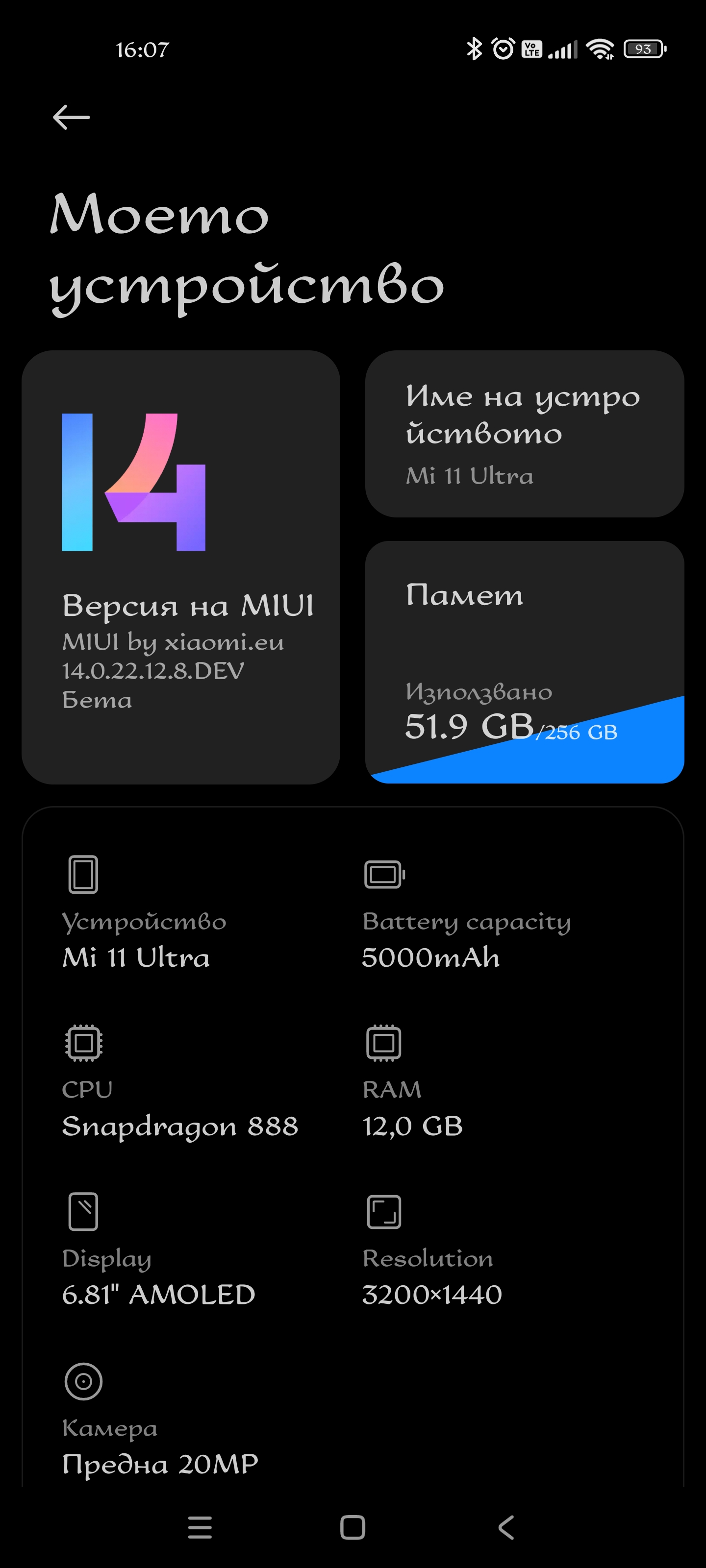

Yes dirty flash from last rom

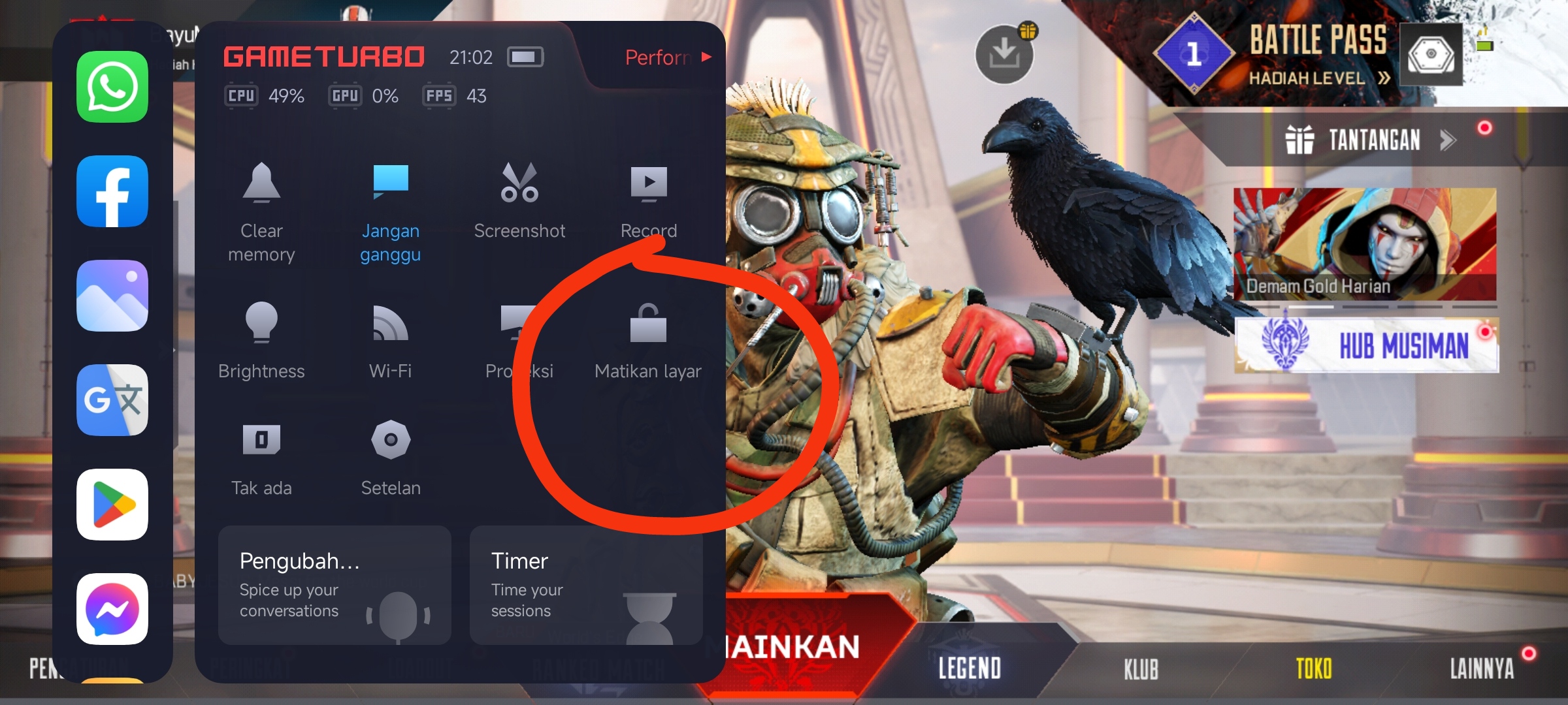

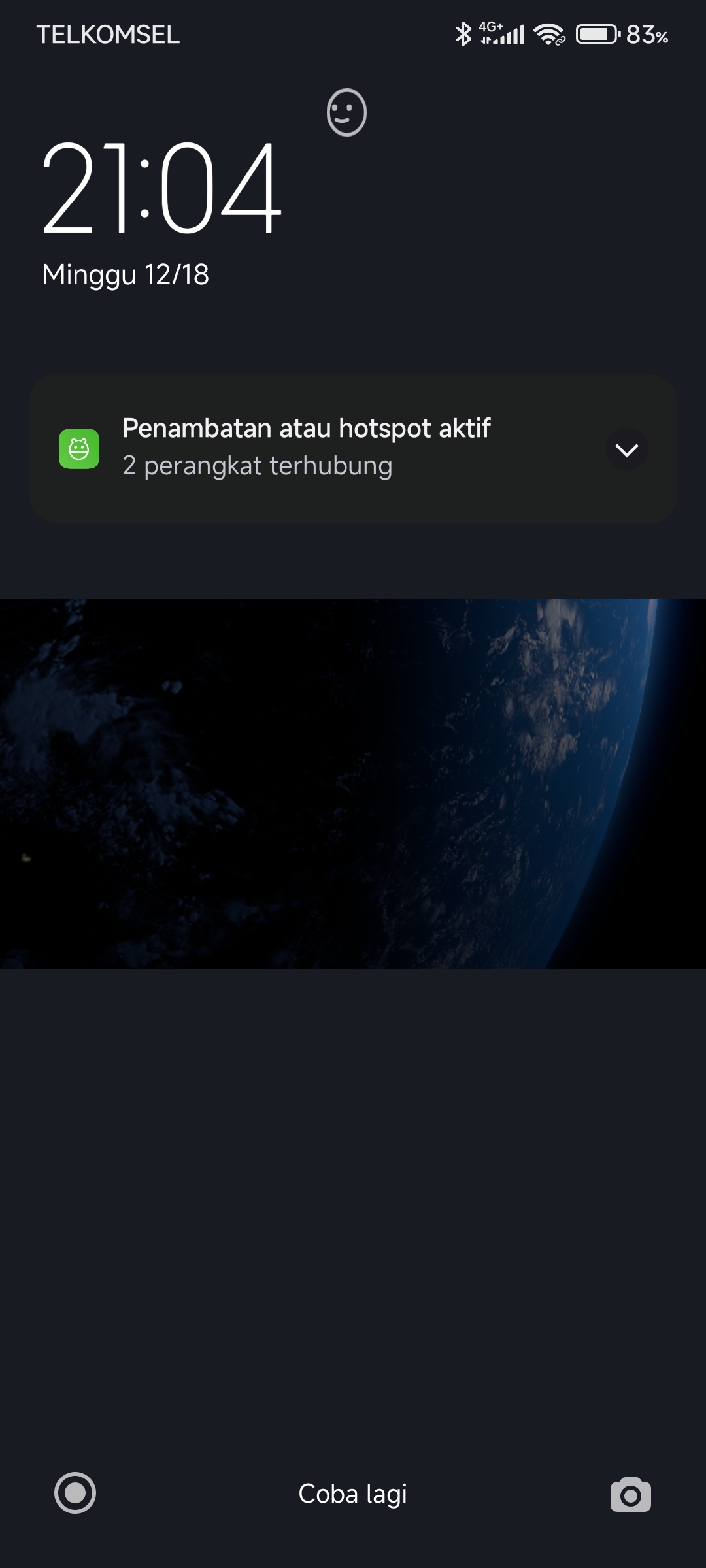

I find bug if use screen off button at game space, aod and lockscreen get weird wallpaper like this

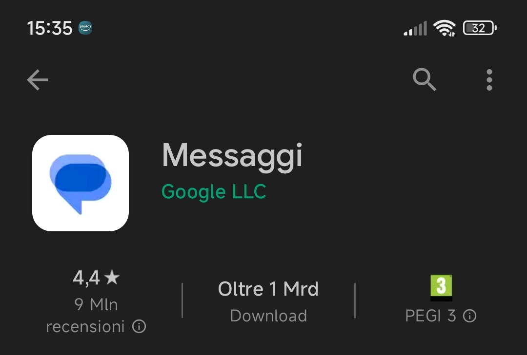

Hi friend, Google messages dont work on my xiaomi 12. Can anyone try please?
All the rest seems ok!

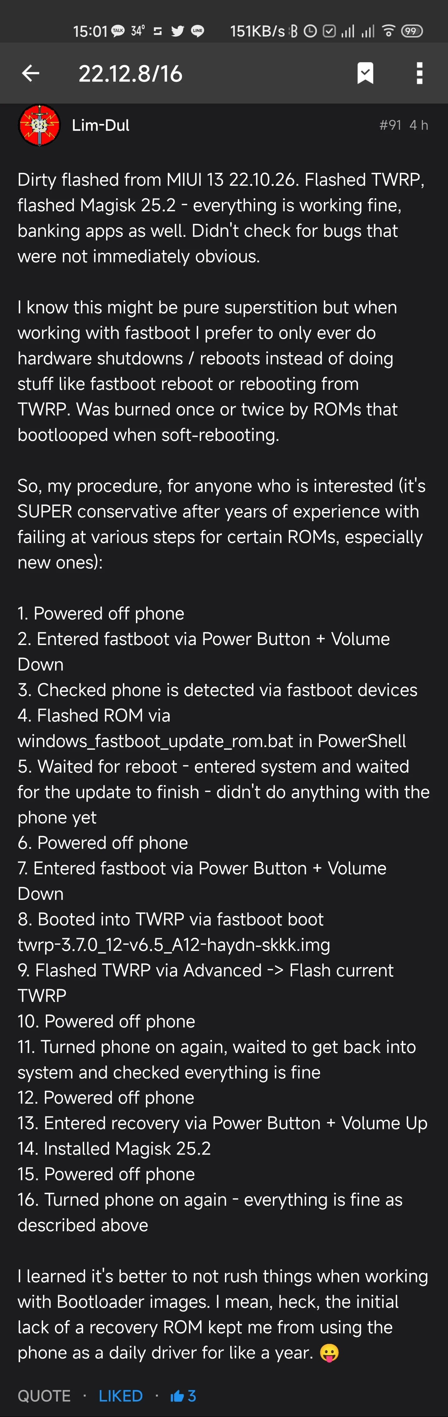

Yes, I also did exactly this (of course after 2./ I unzipped the file in the comp) and I succeeded by installing on Mi 11 Ultra for a first attempt.
Dirty flashed from MIUI 13 22.10.26. Flashed TWRP, flashed Magisk 25.2 - everything is working fine, banking apps as well. Didn't check for bugs that were not immediately obvious.
I know this might be pure superstition but when working with fastboot I prefer to only ever do hardware shutdowns / reboots instead of doing stuff like fastboot reboot or rebooting from TWRP. Was burned once or twice by ROMs that bootlooped when soft-rebooting.
So, my procedure, for anyone who is interested (it's SUPER conservative after years of experience with failing at various steps for certain ROMs, especially new ones):
  1. Powered off phone
  2. Entered fastboot via Power Button + Volume Down
  3. Checked phone is detected via fastboot devices
  4. Flashed ROM via windows_fastboot_update_rom.bat in PowerShell
  5. Waited for reboot - entered system and waited for the update to finish - didn't do anything with the phone yet
  6. Powered off phone
  7. Entered fastboot via Power Button + Volume Down
  8. Booted into TWRP via fastboot boot twrp-3.7.0_12-v6.5_A12-haydn-skkk.img
  9. Flashed TWRP via Advanced -> Flash current TWRP
  10. Powered off phone
  11. Turned phone on again, waited to get back into system and checked everything is fine
  12. Powered off phone
  13. Entered recovery via Power Button + Volume Up
  14. Installed Magisk 25.2
  15. Powered off phone
  16. Turned phone on again - everything is fine as described above
I learned it's better to not rush things when working with Bootloader images. I mean, heck, the initial lack of a recovery ROM kept me from using the phone as a daily driver for like a year. :p
