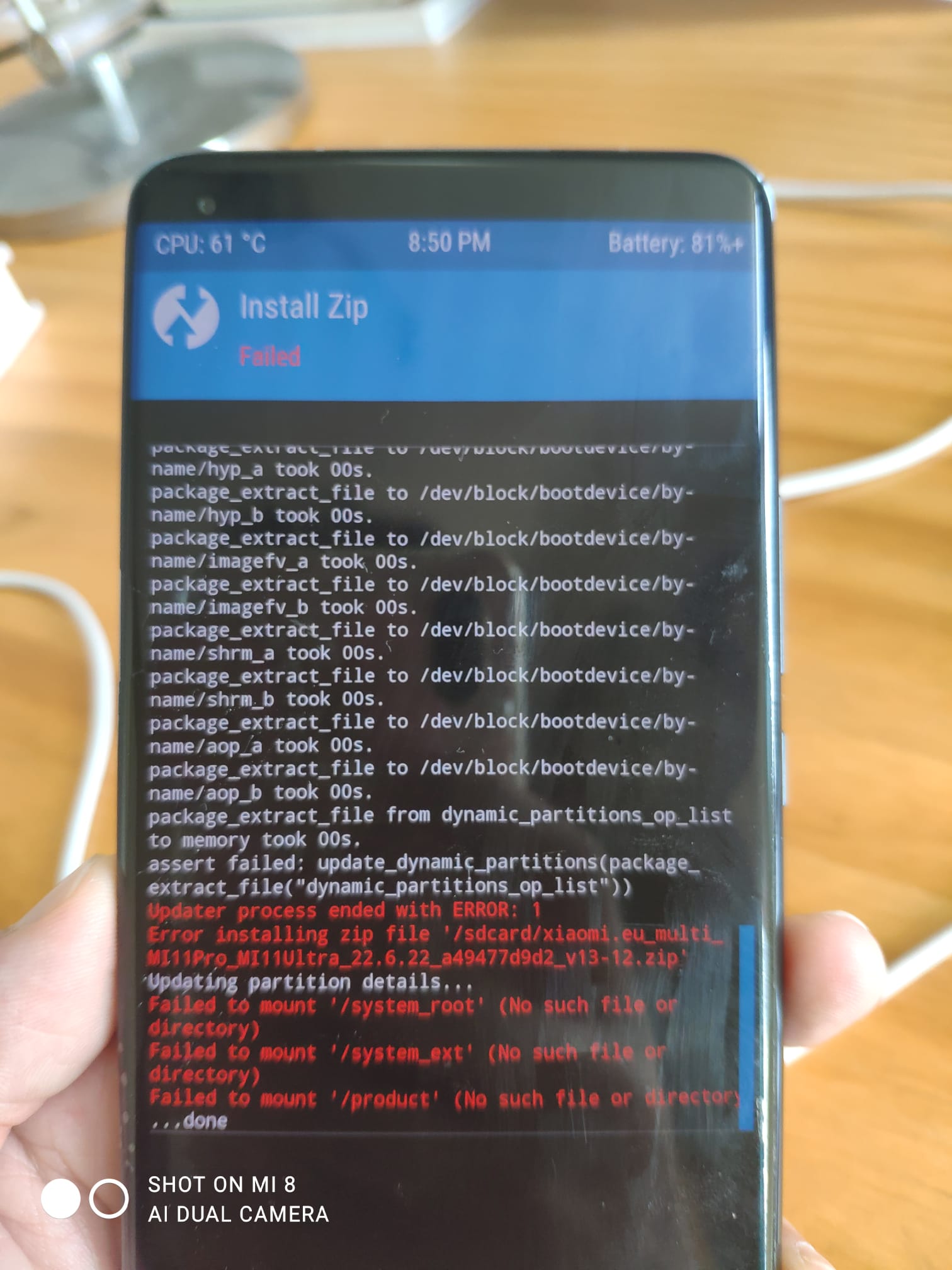

I follow this guide to update my weekly ROM on Mi 11 Pro. but got error message. What should I do ? THank you

try to install TWRP first then reboot again to TWRP to install rom.
I saw a post with Mi 11 Ultra nearly bricked the phone if install TWRP image. I don't want to take the risk.
gogocar62 guide can install the ROM just by fastboot boot twrp.img , don't have to install and take risk.
these messages appear when twrp was unable to decrypt the system, are you sure you installed twrp version 3.6.2?
it will only work if you carry out the steps, and from what I understand you are afraid to install this twrp version because someone else is almost bricked, well, if you have a backup of your data and do everything correctly you have nothing to worry about
it's not a fastboot rom, so it shouldn't be possible to install like that, only recovery
Reactions: biscoot
The TWRP version is 3.6.2_12-Mi11Pro_v3.7_A12. My phone is Mi 11 Pro, should be fine? Thank you.
Reactions: MarkSUK
moarfish
Reinstall the ROM
reboot the system even if it reports errors.
If the phone ends up in fastboot mode, repeat the procedure.
1) From TWRP, make a backup of Boot (it will contain your already installed TWRP to Boot)
2) Install Magisk APK (this is only application, you have no root yet), download from Magisk Github
3) From Magisk app, choose Install on top, Patch and navigate to the backed-up boot.emmc.win (don't worry that it's not img - it is img, and you don't need to rename).
Do not enable Recovery option - leave as is
4) Reboot to TWRP and install the patched boot img to Boot.
Or even better, firdt from Fastboot:
fastboot boot <patched boot img>
and if it works correctly, then
fastboot flash boot <patched boot img>
or install then from TWRP as above
Alternatively, rename the downioaded magisk APK to install.zip and flash from TWRP - btw, you can try, TWRP should even recognize magisk APK as the installation ZIP if you don't rename
Then, you will have both TWRP and Magisk in your Boot. Normal boot will boot to System+Magisk, boot to recovery will boot to TWRP
And in future you can update Xiaomi.eu from your TWRP.
IWhen updating Magisk, just use the Magisk application, Install and take Direct install
Just Renamed Magisk.apk to magisk.zip & Flashed it using TWRP
It worked perfectly.
moarfish
Reinstall the ROM
No matter how many times I reinstall the ROM and reboot the system, it shows the same error message.
It reboot in to the old 22.6.15 weekly ROM after reboot system.
Thank you for your help.
