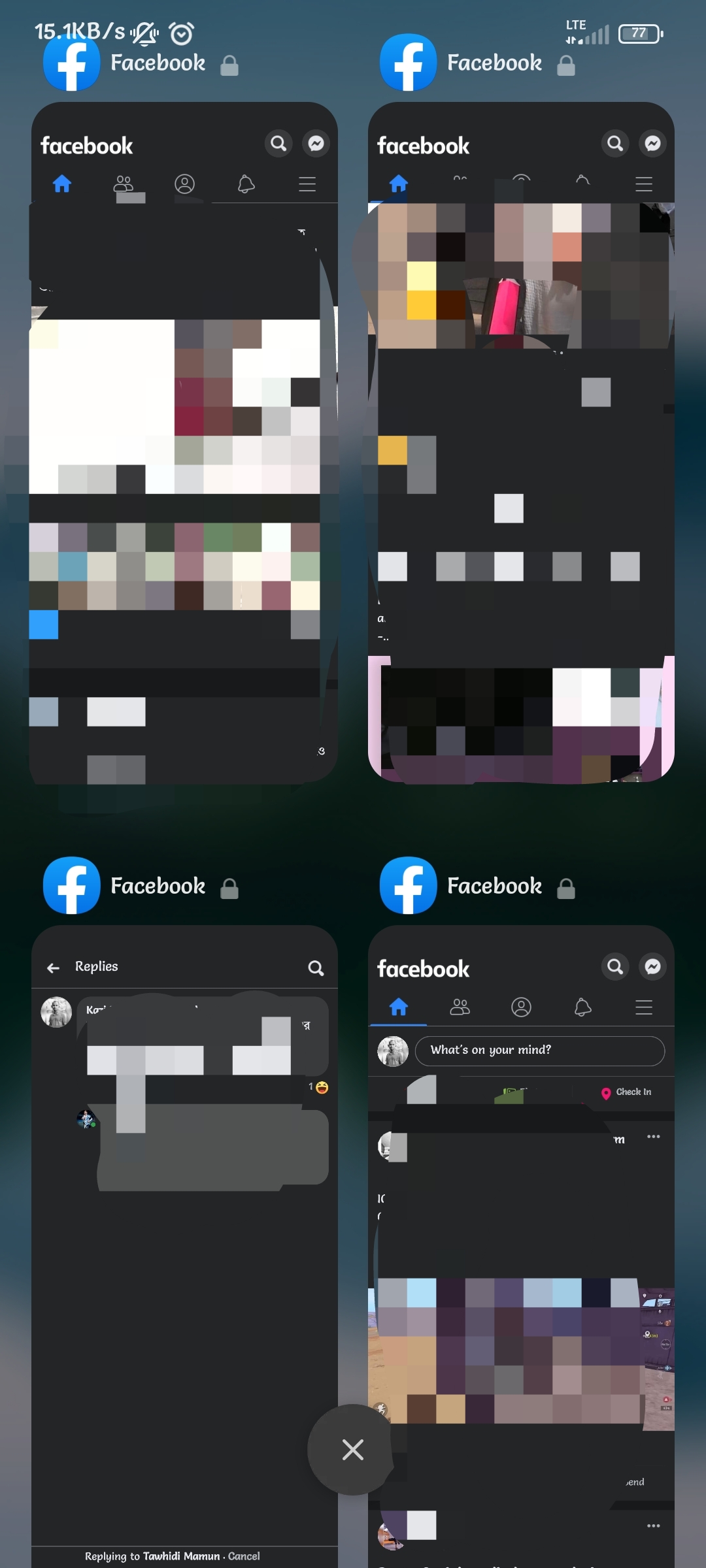

Why does Facebook open multiple times whenever I click on any notification or click on the Facebook app from the homepage?

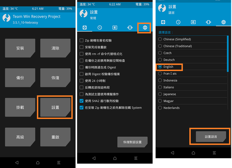

Instructions for equipment without A/B !! ( All devices before Mi 11 era (except Mi 10S, Redmi Note 10 Pro Global iirc) are non-AB).
Updates via TWRP:
- Insert the ROM into the phone.
1. Download TWRP to PC and rename it to twrp.img https://dl.akr-developers.com/?dir=skkk/TWRP/A12/v3.7_A12
2. Connect the phone to the PC in fastboot mode.
3. Run TWRP fastboot command
Code:
fastboot boot twrp.img
4. Install ROM
5. Reboot system
How to change the language in TWRP.
