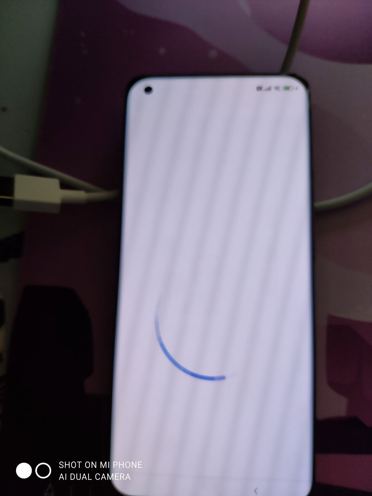

Hello,i have Mi 11 Pro i make downgrade+ factory reset on mi phone but now is stuck on blue circle after wifi connection....please help me with advice.i try to connect to PC but pc wont recognize
Try to press the back button till u get back to WLAN selection go to the options of your network and select use devices Mac

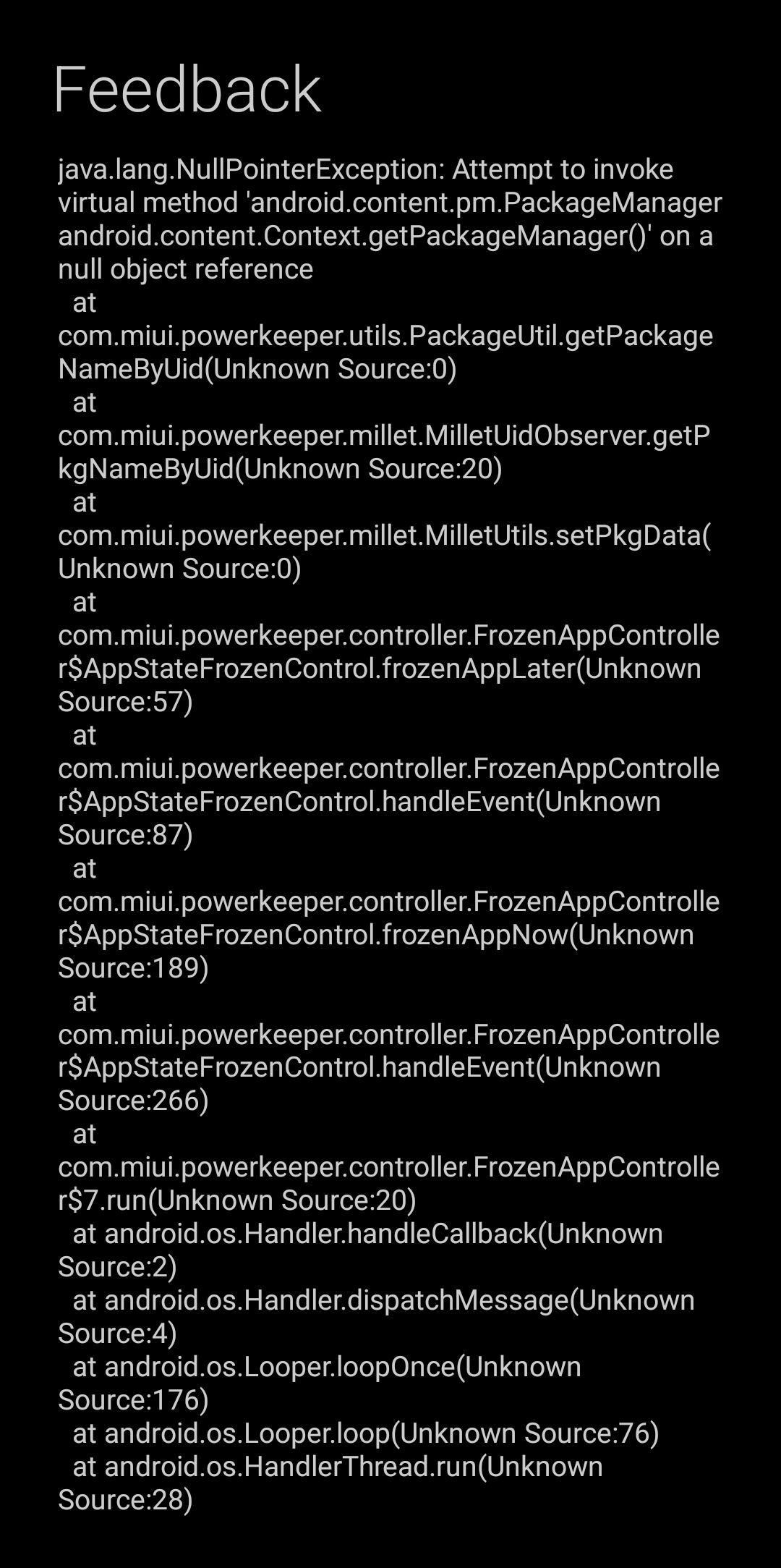

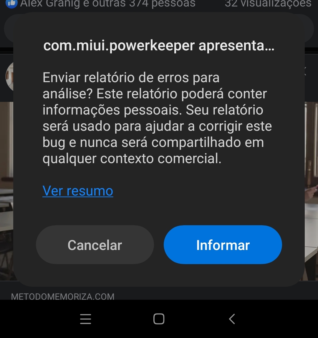

Please, help me. After current Weekly 22.9.28 update, My device keeps showing this message of battery problems. I use mi 10 ultra (12gb/256gb).

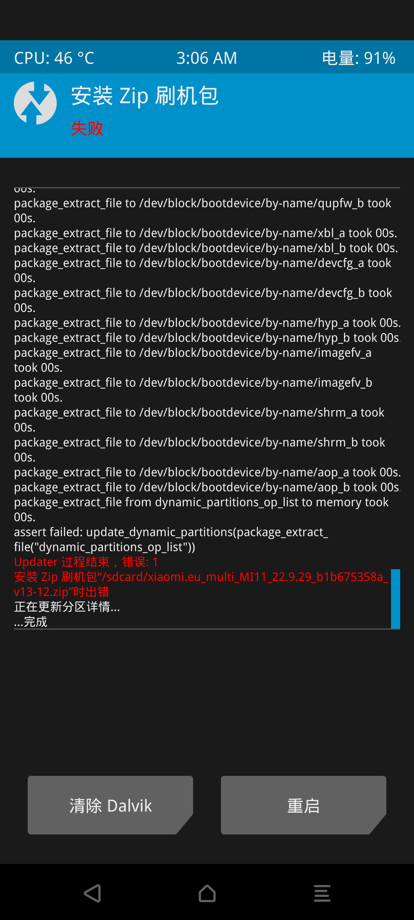

mi11
for those of you who get errors in twrp when you want to install update
this worked for me
when your mobile is on turn it off
and press power and volume down so you get into fastboot when you are there press and hold the power button until it turns off
then immediately press volume up so twrp starts
Now I could do the update

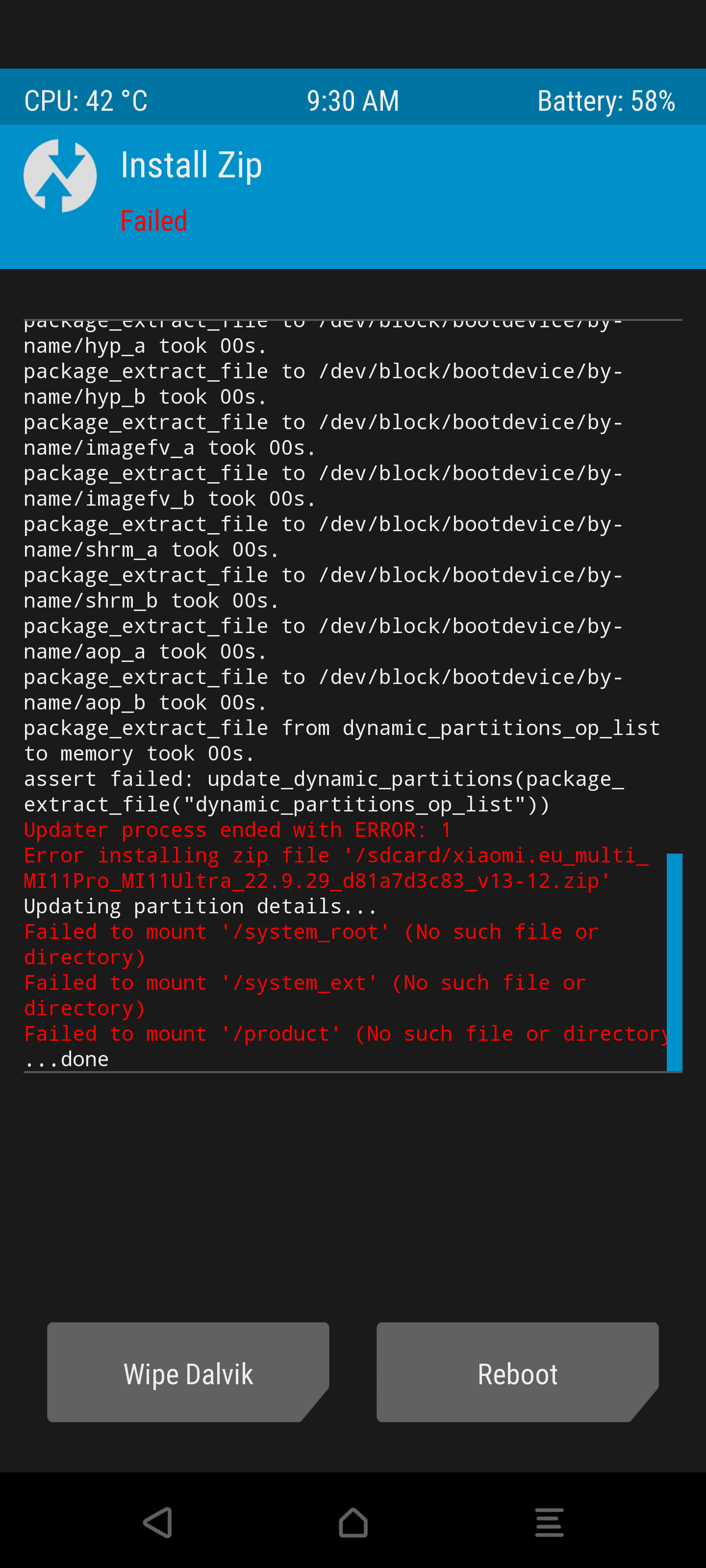

Didn't work for me still getting Error 1
Unable to mount system_root
Unable to mount system_ext
Unable to mount product

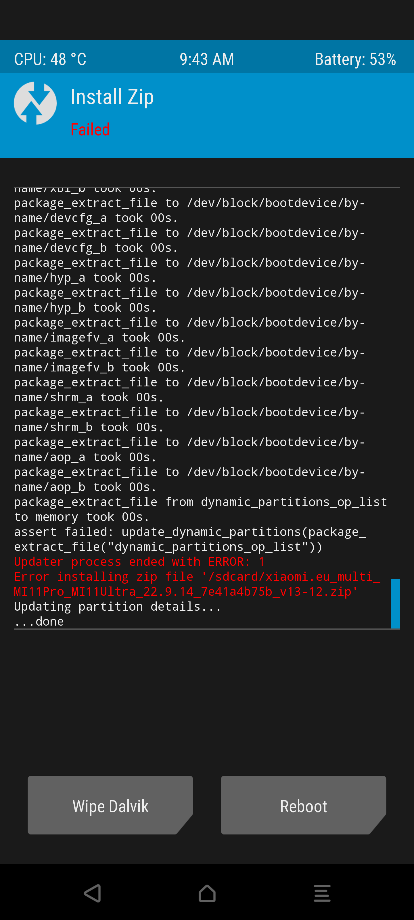

refresh trwp
Error Gone by following these steps:
Refreshed TWRP and immediately mounted all partitions and tried to flash
Just Got Error 1 and not all the unable to mount errors(screenshot attached below)
Refreshed TWRP again and immediately flashed without bothering to mount anything
Flashed ROM successfully without any errors
Reboot to system and let the ROM update settle before flashing Magisk in TWRP
All good now
