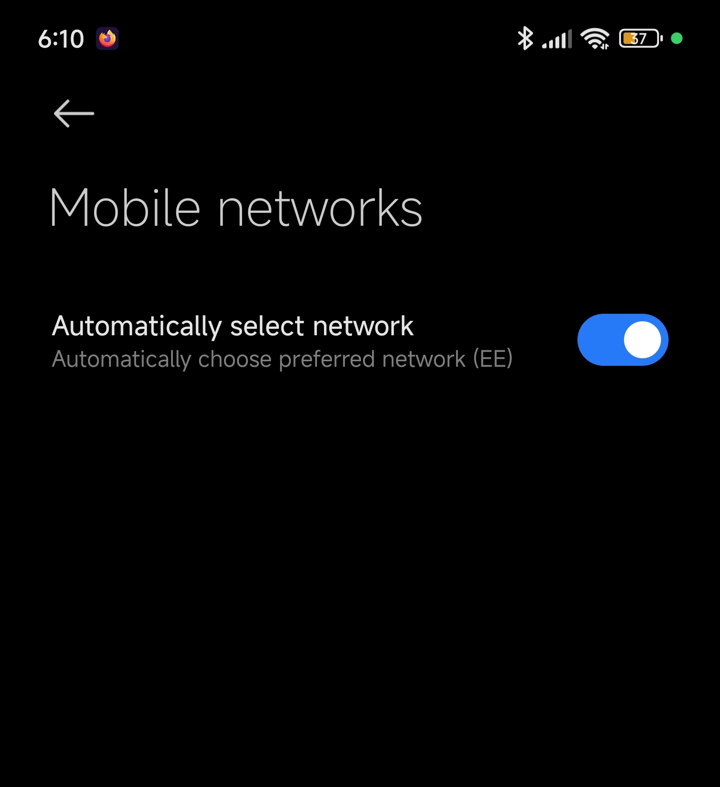

then click mobile networks, and what does it say?
None of the options go on to give the option to turn on 5G.
How to do? I'm not rooted

Dial * # * # 4636 # * # * to enter the TESTING menu.
Select your SIM card through "Phone Information 1" or "Phone Information 2", the first and second SIM card slot respectively
Go to "Set preferred network type:" and select anything starting with "NR" from the drop-down list.
EX: NR/LTE/GSM/WCDMA
It is already set to 'NR/LTE/GSM/WCDMA'

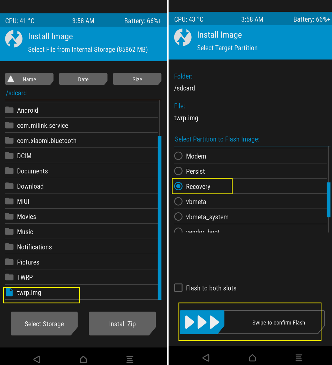

I managed to get myself stuck on a TWRP bootloop. I have the Poco F4 GT (Ingres) with HyperOS 23.12.25 and trying to update to the 24.1.2 weekly update. I tried Updating via Updater app and TWRP didn't throw any noticable errors but it basically didn't update my HyperOS. I checked TWRP updates (there is) and moved from v8.1 to v8.2 following the screenshot by @gogocar62 and was hoping this will fix the Updating via Updater app issue. Now I'm stuck in a TWRP bootloop and seeking assistance on what to do next (to get out of the bootloop) before I make any further changes just incase I might've missed a step that wasn't obvious on the guides.

I've looked everywhere - I cannot find where to turn on 5G!

I am normally in Battery saver. I turned it back to Balanced, rebooted *, but the 5G switch has still not appeared.
* I also noted that the background does not blur when the Extended power menu comes up.
Did you read and try the last frequently asked question?

Did you select the option in twrp" flash to both slots" ?
To get out of the loop you need to follow the adb FB commands to change your boot slot to the other than the phone is currently using
I never got that option. I was on [twrp-3.7.0_12-v8.1_A14-ingres-skkk.img] and updated to [twrp-3.7.0_12-v8.2_A14-ingres-skkk.img] and as per @gogocar62 updating TWRP is as simple as going to recovery mode (TWRP) Install>Install Image>[Locate]NewTWRP.img>Install Recovery Ramdisk>Swipe to confirm Flash>(No Errors on log)>Reboot Stytem. Rebooting the system returns me to TWRP (which is now v.8.2).
Do you mean I need to do the same step above and flash the updated TWRP on Slot B? (TWRP saying my Current Slot is: A)
Do not choose recovery ramdisk. You have a device with dedicated recovery partitions (A/B). Choose recovery and then both slots.
This procedure is not for your Poco F4 GT device. Your device has a dedicated partition for recovery.
enter recovery mode (TWRP) Install > Install Image >[Locate]NewTWRP.img > select recovery > Swipe to confirm Flash > reboot recovery
Thanks for the clarification, I hope I haven't done anything that needs my phone to be formatted again. So I did the correct steps now and I'm still stuck in TWRP with the following issues: (red text)

Install TWRP again in TWRP > reboot into recovery > install ROM > reboot system
Got the phone up and running again without losing anything. Thanks for the help. Unfortunately Updating via Updater app still doesn't work and still have to manually update HyperOS as you mentioned above, I'm over it, gotta do it manually till it the feature works.
