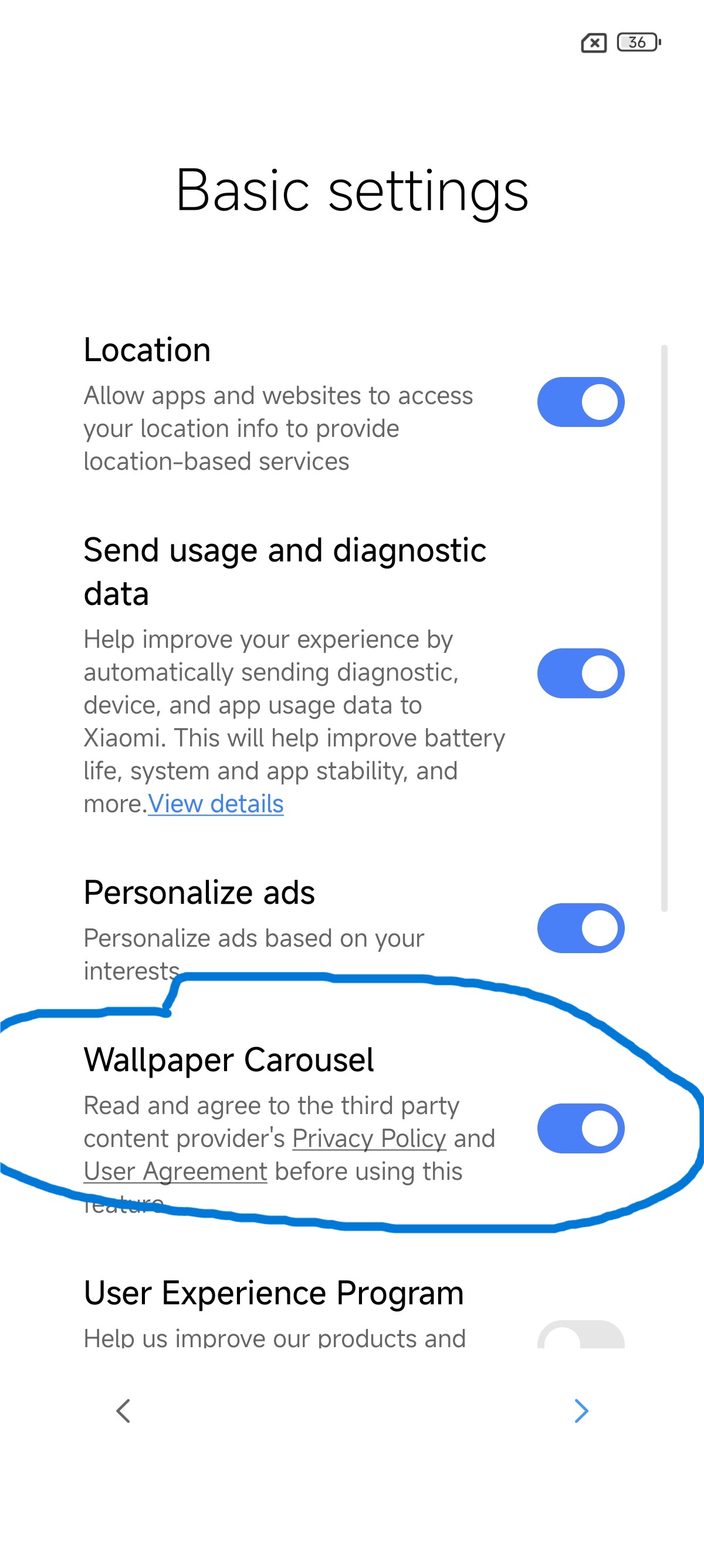

When I first installed the EU rom , if I turned on "Wallpaper Carousel", I couldn't skip basic settings and enter the system desktop
This feature is an external service, I am not really surprised if it requires to setup the phone.

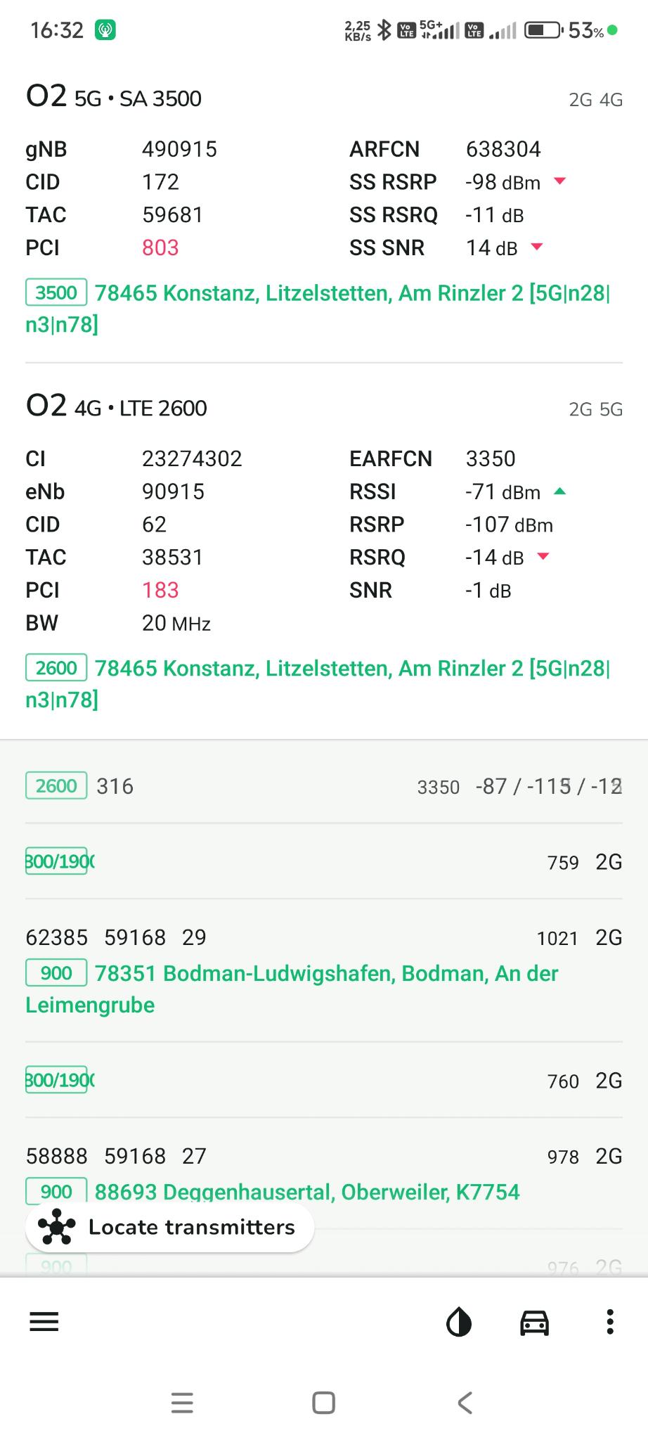

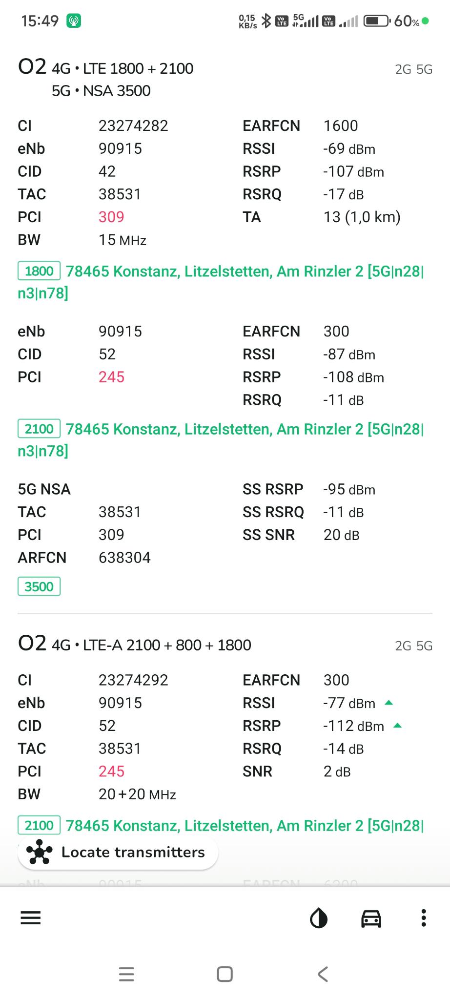

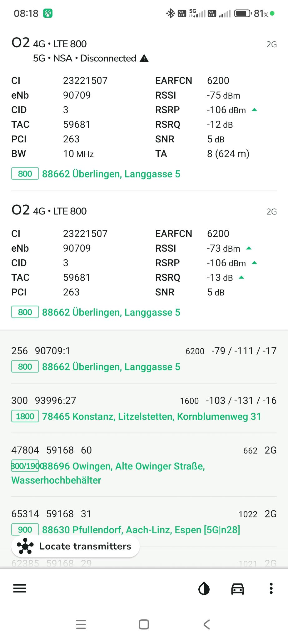

I have a Poco F5 Pro (Mondarian). I am very happy with it and with Hyper OS EU. However one issue has come up, please let me know if there is a route to solve it.
I am talking about 5G connectivity.
I can connect to 5G SA as well as to 5G NSA in general. However there is an issue with 5G NSA, if it's corresponding LTE Band is on 800MHz. Then is stays 5G NSA disconnected. You can see the 5G icon in the status bar, but if disconnected to the 5G service, you get only the LTE connection speed.
I attach 3 screenshots. One will show you a 5G SA connection.... I get up to 350Mhz download speeds, that is the provider limit.
Then I attach 2 screenshots with 5G NSA. I one show you connected, which is giving me also very good download speed, and the third is showing 5G NSA disconnected, it shows the LTE800 band as well.
Unfortunately the provider often uses the LTE800 band, so I am often in the unfortunate situation, that I am in reality not using 5G, even if it shows me the icon.
Since it shows the 5G icon, doesn't this prove, that it can "see" the 5G signal?
I received the phone with MIUI 14 global. Then I switched to MIUI 14 EU ROM. I guess at that point I switched to the chinese base.
Now the questions: Is the modem/firmware the same on this ROM as it is on the Miui original HyperOS Global based version, which is the key question?
Is there a chance that the "5G NSA disconnected" gets solved by flashing the Global based ROM?
Can I perhaps extract the modem from Global and flash it on this ROM? Would this work, and would this be a reasonable way to test?
Is there any other way to make it work, which I didn't think of?
Or will all above conclude that Xioami/Poco would not support at all 5G NSA with LTE800 as corresponding 4G band?
Thank you for your thoughts and ideas,
D.

More or less the same here in NL on Vodafone. The icon says 5G Network Signal Info is LTE * 4G..
5G availability is 8,9% past week (as by the Opensignal app.)

Poco F5 Pro (mondrian) can handle CA: B20 (800) + n78 (3500) but that's Carrier side defined (DSS/NSA/SA)
The HyperOS by Xiaomi.eu support the correct Carrier Aggregations for your global model so none update is necessary
