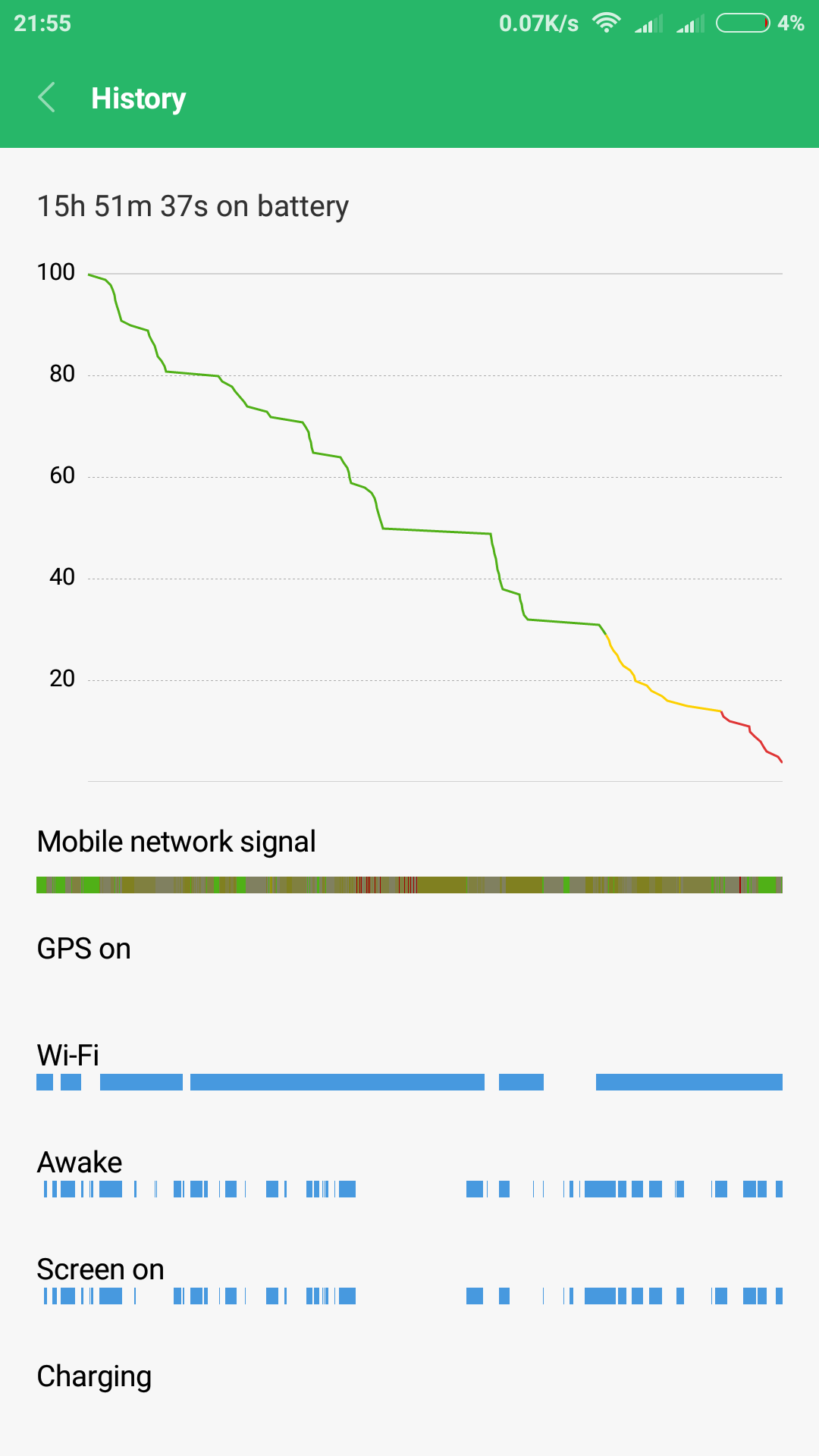

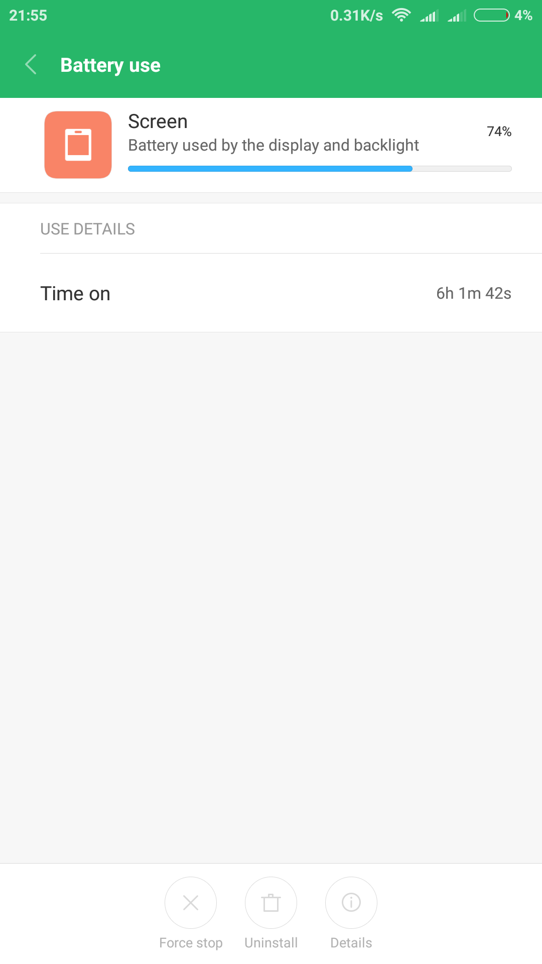

Good job ... with some small leak ... battery percentage drops suddenly, what for me is not an indication in real time.

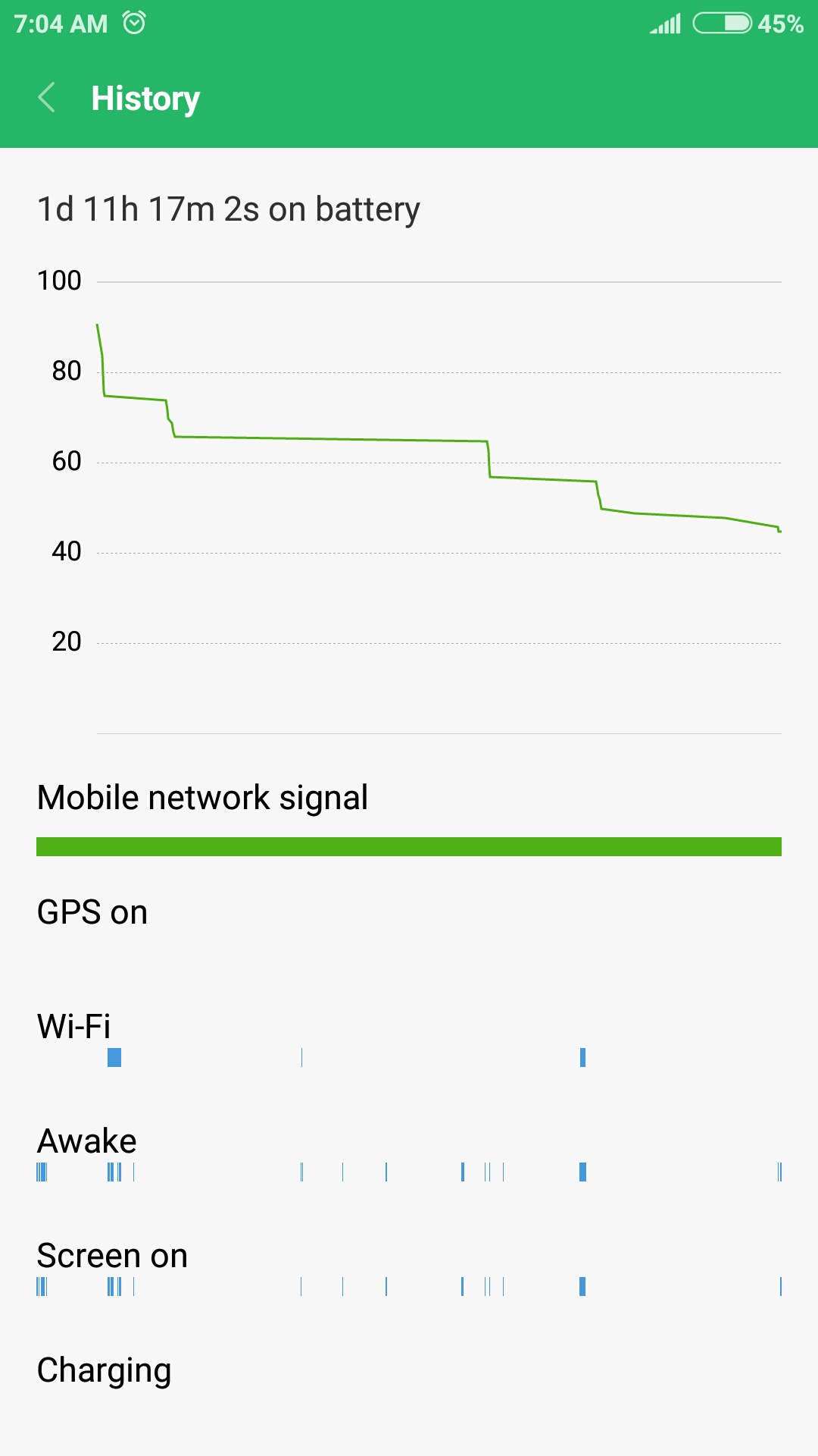

Im using this rom for a couple of days now and i Just Love it! The batterylife on my Pro is much better now :) overnight it only drops like 3 or 4%!

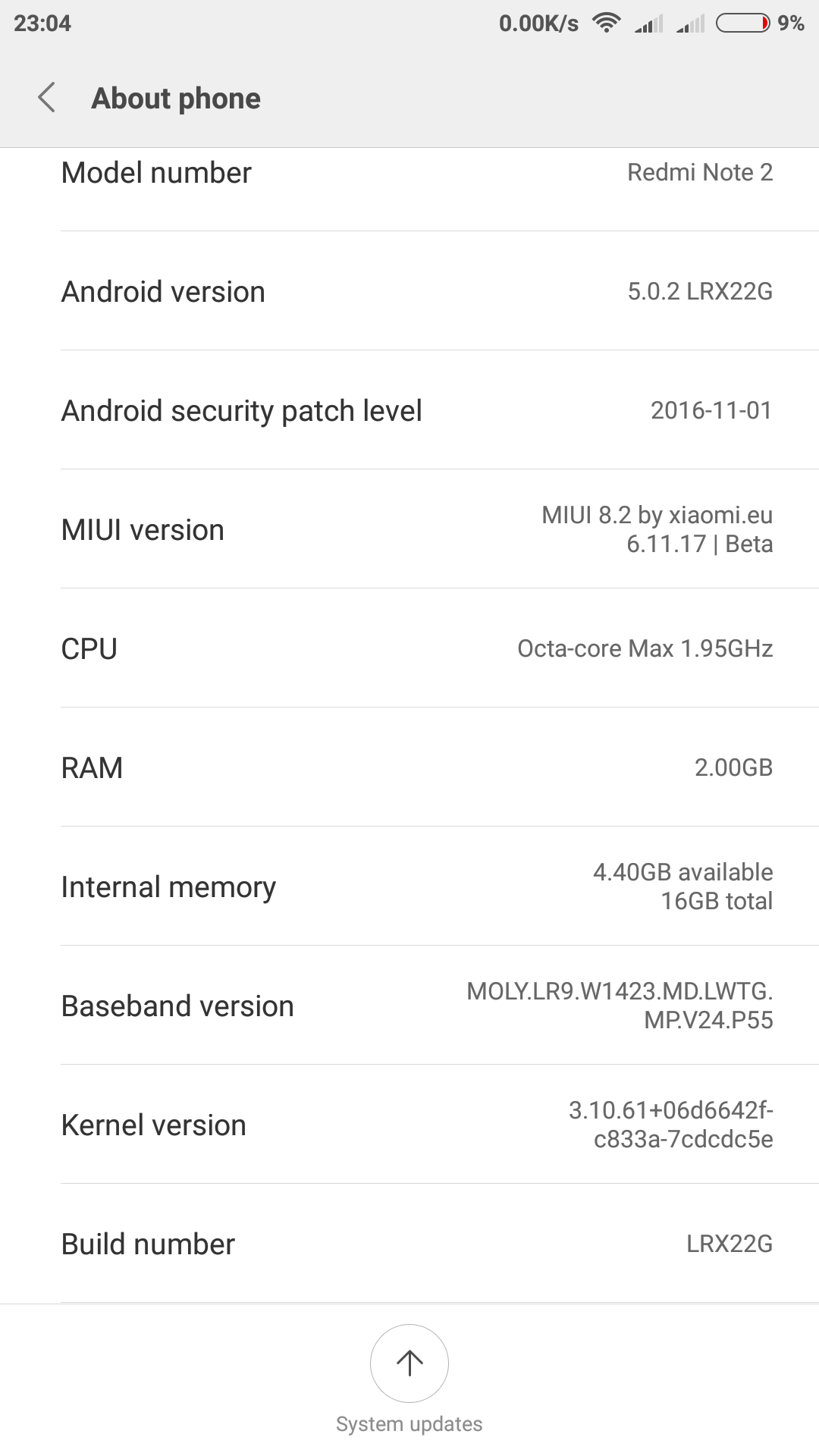

Great rom for this week.(redmi note2)

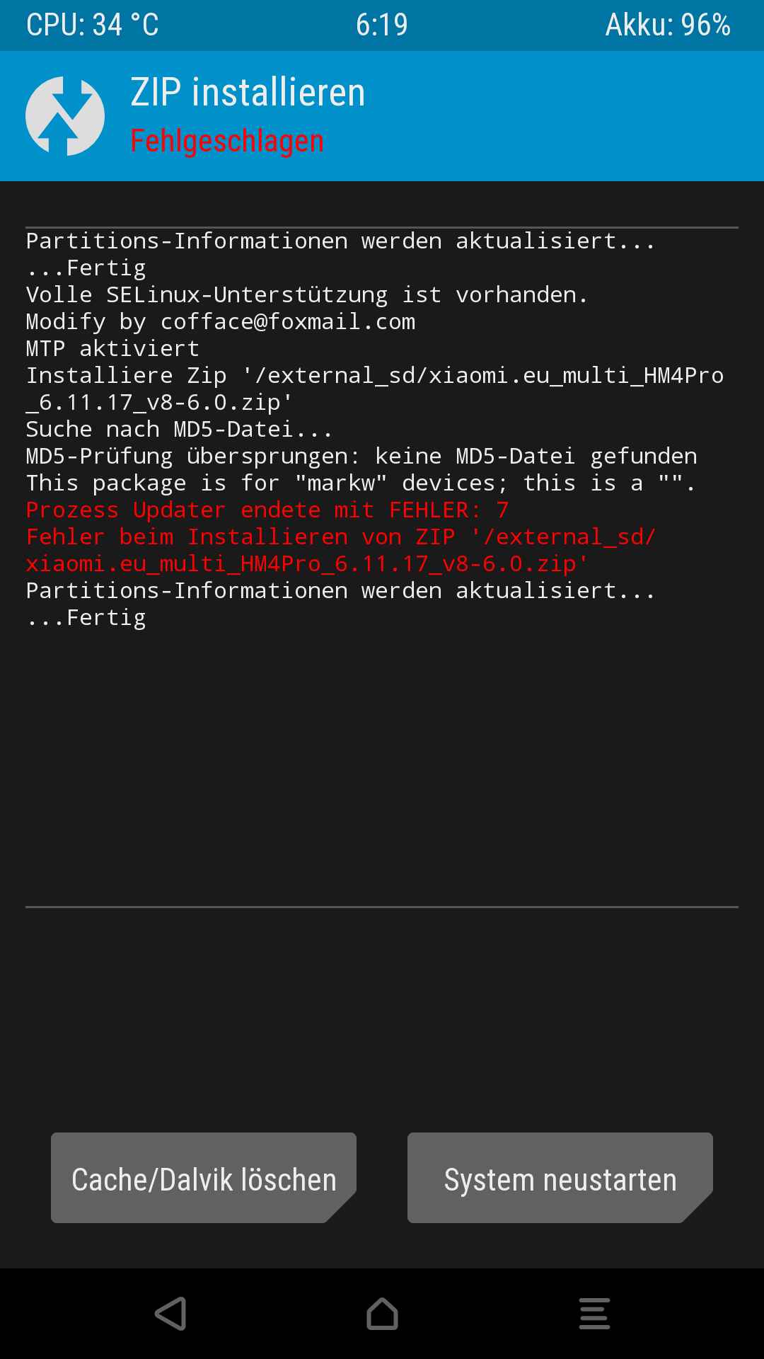

AFANTOCULU!!!! sorry for my native lenguage esclamation...
i did... solved finally. there is a problem isnide the files in the rom, a with help of Daniele Benati on a fb group i did it
i write what to do in any other people need it
Download the last xiaomi.eu rom (6.11.17)
open the zip file with winrar
META INF->COM->GOOGLE->ANDROID
using exclusively the blocknotes open the file UPDATER SCRIPT
delete on the first string:
getprop("ro.product.device") == "markw" || getprop("ro.build.product") == "markw" || abort("This package is for \"markw\" devices; this is a \"" + getprop("ro.product.device") + "\".");
until the first string start with:
ui_print("Tar etc etc etc
save the file and put the modified file in the device and use it to flash the rom with recovery
So the workaround is to have the recovery to believe that you have the wrong phone xD
