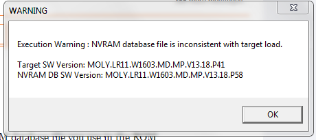

After flashing stable ROM for Redmi PRO, I face invalid IMEI error.
There is a way of solving this here but in order this to work I need NVRAM database file you use in the ROM
I try to take the file from Original MIUI Chinese Fastboot ROM but the version is not the same
MDDB_InfoCustomAppSrcP_MT6797_S00_MOLY_LR11_W1603_MD_MP_V13_18_P58_1_ulwctg_n
According to Soft MAUI Meta, I need same file but version P41
Since the ROM you offer are not for Fastboot mode, I can't take the file from the Rom package.
Can you please provide this file to me?
Thank you
