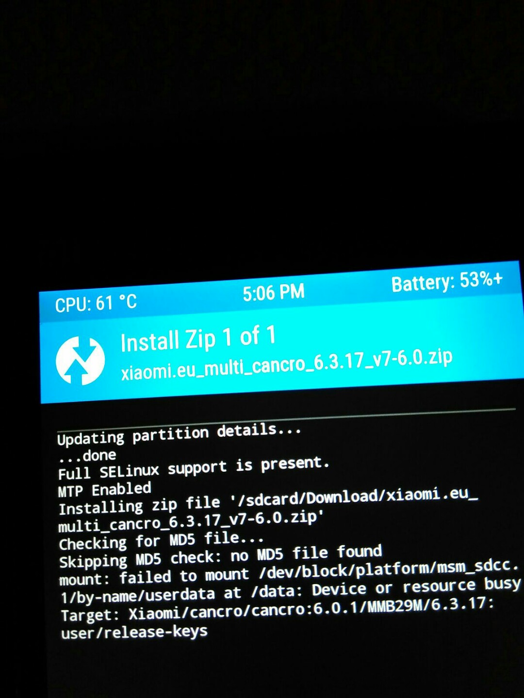

Once again my story... I have ecaxtly the same Error on mi, 3 cancro. What i do is flashing in fast boot mode the cyanomod recovery. Then into the cyanomod recovery i flash the weekly eu cancro miui rom. It gives some errors at the end but after reboot i have each time the new eu miui rom installed. Then i flash supersu.Every week i have to repeat this scenario to update. Problem is in twrp system is not mountable but in cyanomod recovery it is mountable. Perhaps someone can edit the cyanomod recovery so the errors don't appear anymore. But it doesn't do anything wrong with the eu miui rom.
I suggest to look if there is a cyanomod recovery available for your device and try.
Remove TWRP folder in your internal storage. next time you reboot to recovery you will get a Welcome screen asking you to keep system read only or allow modifications. Select "Allow modifications".

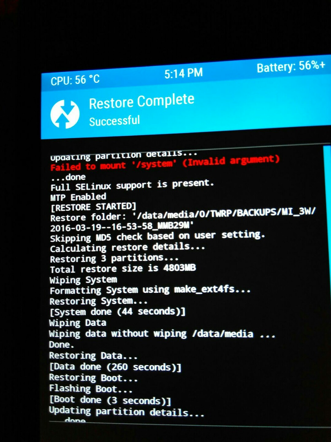

I tried that but doesn't work. Can not install cancro eu rom with twrp on mi 3 . What does work is restore the backup i made after deleting the twrp folder. Or the trick with installing cyanomod cancro recovery in fast boot and installing from there the miui eu rom.
I would flash whole phone with mi flash again but don't think they made flashrom already for marshmallow.
hmmm, then I think that's a TWRP version problem. Change TWRP version, friend.
I now have version 3 downloaded from eu forum link but had it with previous version too. What version do you recomment?
Better a 2.8.7.x version they are more stable, find one in en.miui.com, I have a Mi 4c so I can't help you. :(

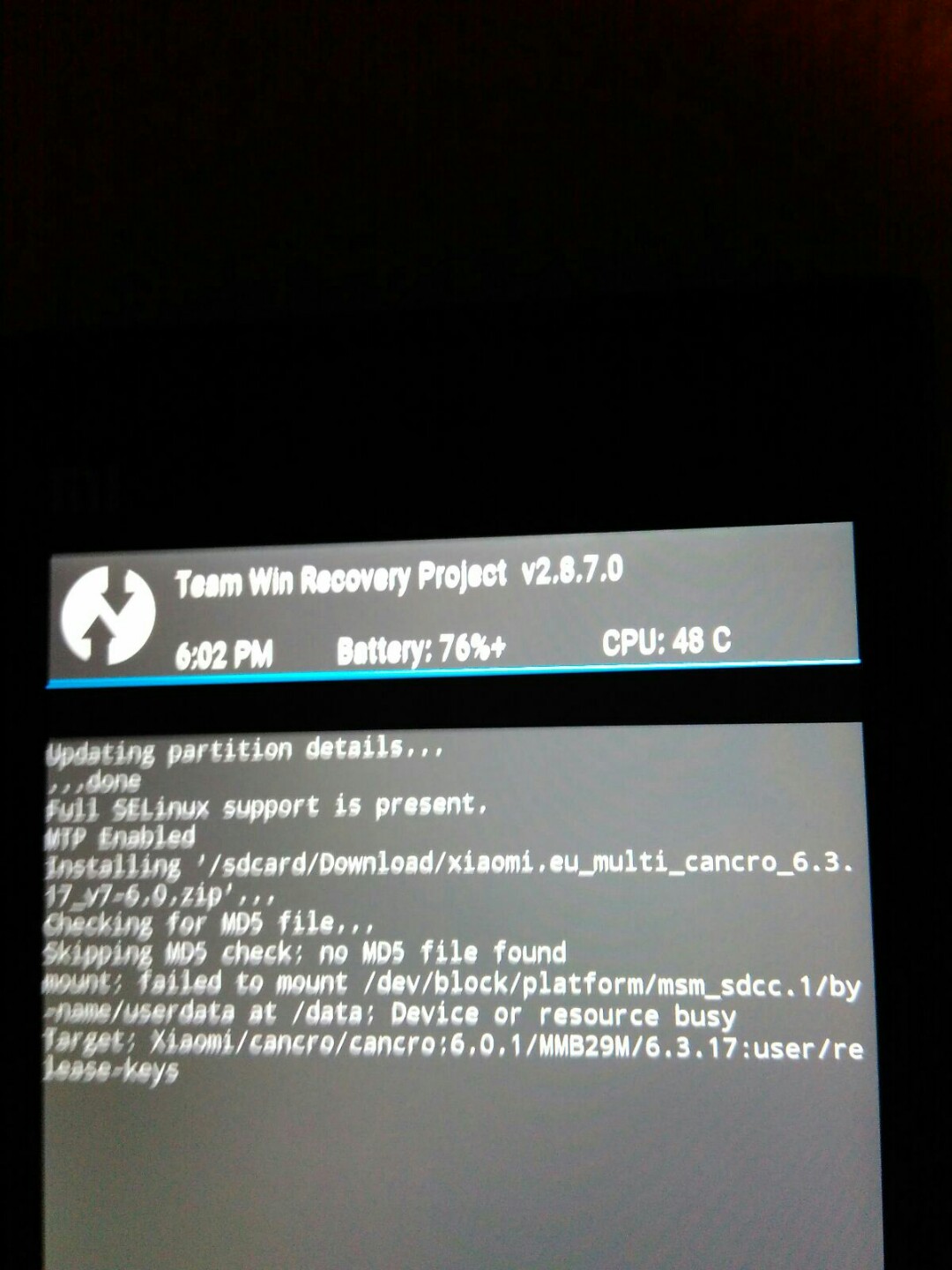

It doesn't work neither on 2.8.7View attachment 11736
You just have to let it continue with the installation. It's running on background. I had exactly the same problem since the devs included TWRP in the new releases but the installation works perfectly.
You have to wait several minutes, it will reboot and the install will continue on the Miui logo with the 3 dots.
Regards.

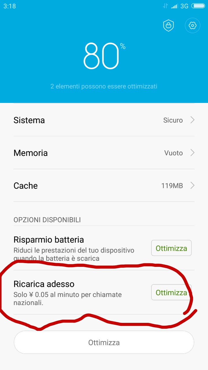

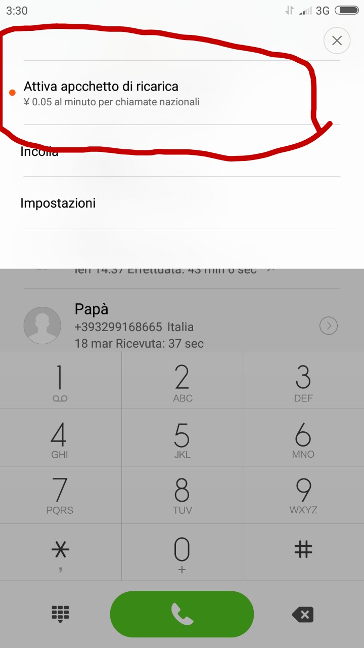

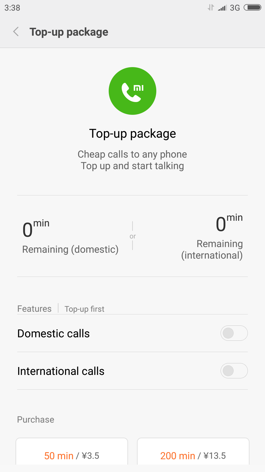

What is this? Security app suggest me to buy china yuan for cheap call.
Mi4c
This
