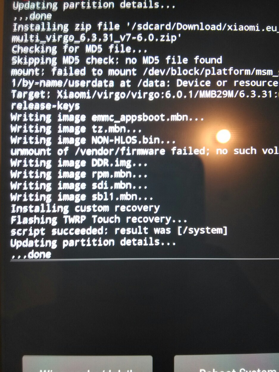

Thank you bro but I already tried to flash the rom direct from TWRP.. No way.. Tried different versions of recovery but same result. This must be something related to my device..
In this week end I'm going to try to fastboot china dev rom, flashify TWRP 3.0.0-1 and then flash the EU version.. Don't know what else I can do.

Use this one (usa questa) http://en.miui.com/forum.php?mod=viewthread&tid=249552&highlight=Twrp+3+redmi+2&mobile=2 work fine and you can install rom lollipop.

They have problem with the last 2 releases, they removed the download too! Wait for the new release :)
Hanno avuto dei problemi con le ultime 2 release infatti hanno anche tolto il download, aspetta la nuova versione :)

Oooooooh so it wasn't me THANK YOU..
I've been using roms from EU for almost a year, but now i was starting to think that i become dumb :) ! I didn't notice the download was removed

Problem with Virgo.
updated as usually (via updater and before updating, checked the MD5) but the phone it is stack in the Mi logo screen.
Already rebooted to TWRP, try to install the file .zip from there but I have the same result.
Any idea how to solve without loosing all the phone info??
Attach is the result of the TWRP installationView attachment 11863 View attachment 11863
