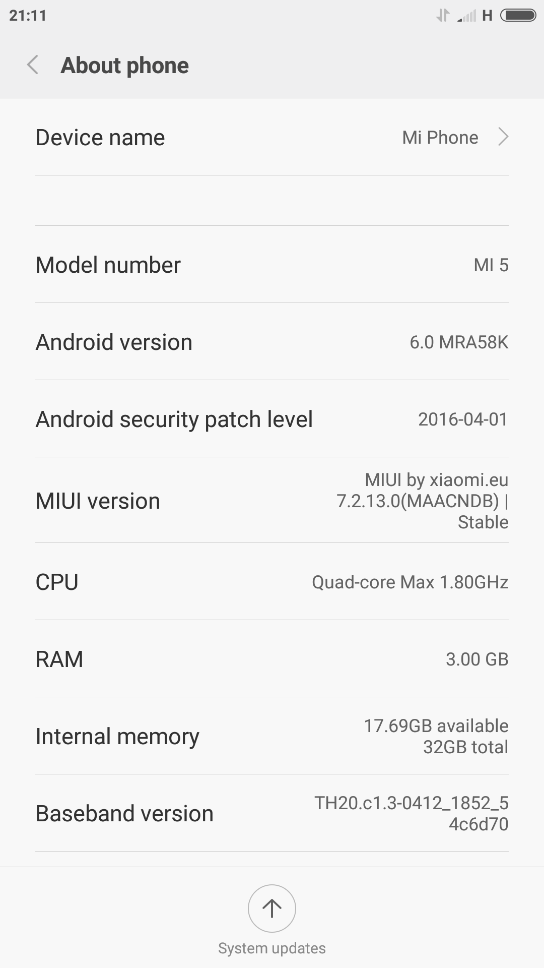

Is this a fake?

No matter the display if your bootloader is locked you cannot install xiaomi.eu. So yours is not genuine.
Yes that is a fake rom. I don't really see the reason behind it though. I won't trust such a rom and miflash official China dev immediately. You need that to unlock the bootloader anyway. And when you get permission flash xiaomi.eu rom.
