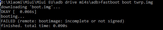

Hello to all,
I've recently installed version 7.4.20 on my MI4S and my previous version was 6.12.22.
I pretend ow to upgrade to this release (7.5.11) but i'm having problems installing the TWRP_aqua_7.0, for android 7.
The command "fastboot flash recovery twrp.img" runs without any problem, but when running the command "fastboot boot twrp.img" I get the following message:
Downloading 'boot.img' ...
Okay [ 0.066s]
booting...
Failed (remote: bootimage: incomplete or not signed)
finish. total time: 0.090s
Can you help me.

It seams that the Aqua TWRP has a bug. I suceded installing using TWRP Libra.
