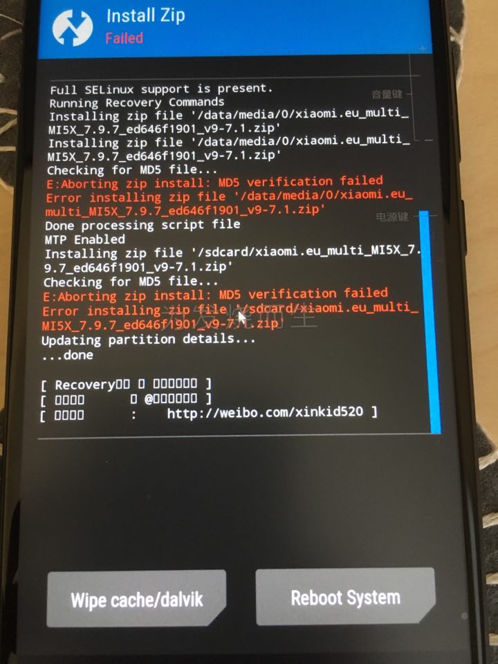

MI 5x MD5 verification failed error !!
Please help me how to fix it ?
