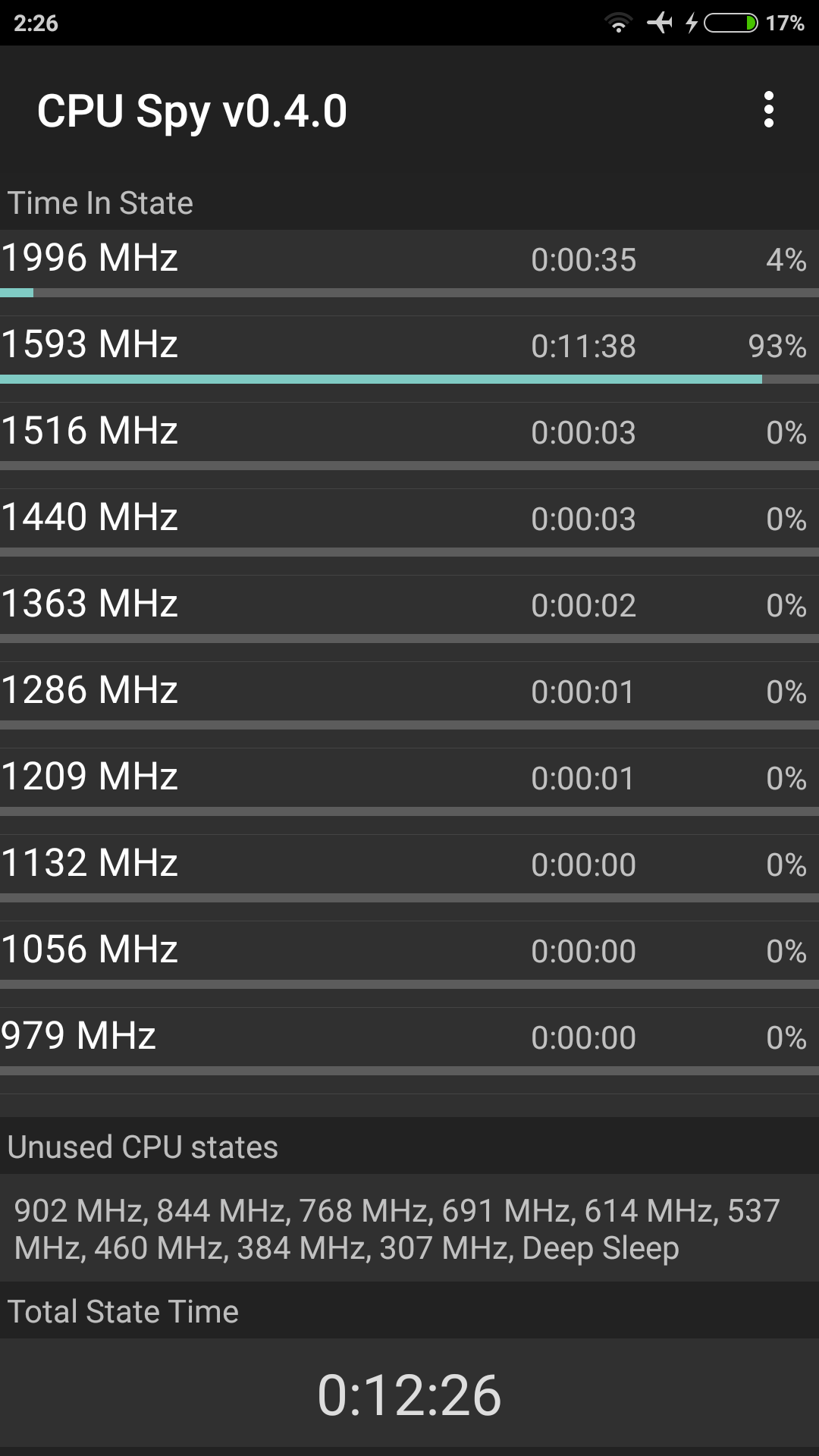

It's normal that the Mi5S's CPU stay constant at 1593 MHz when is it in charge? (Slow charge 5V - 1A)
The temperature is so high
