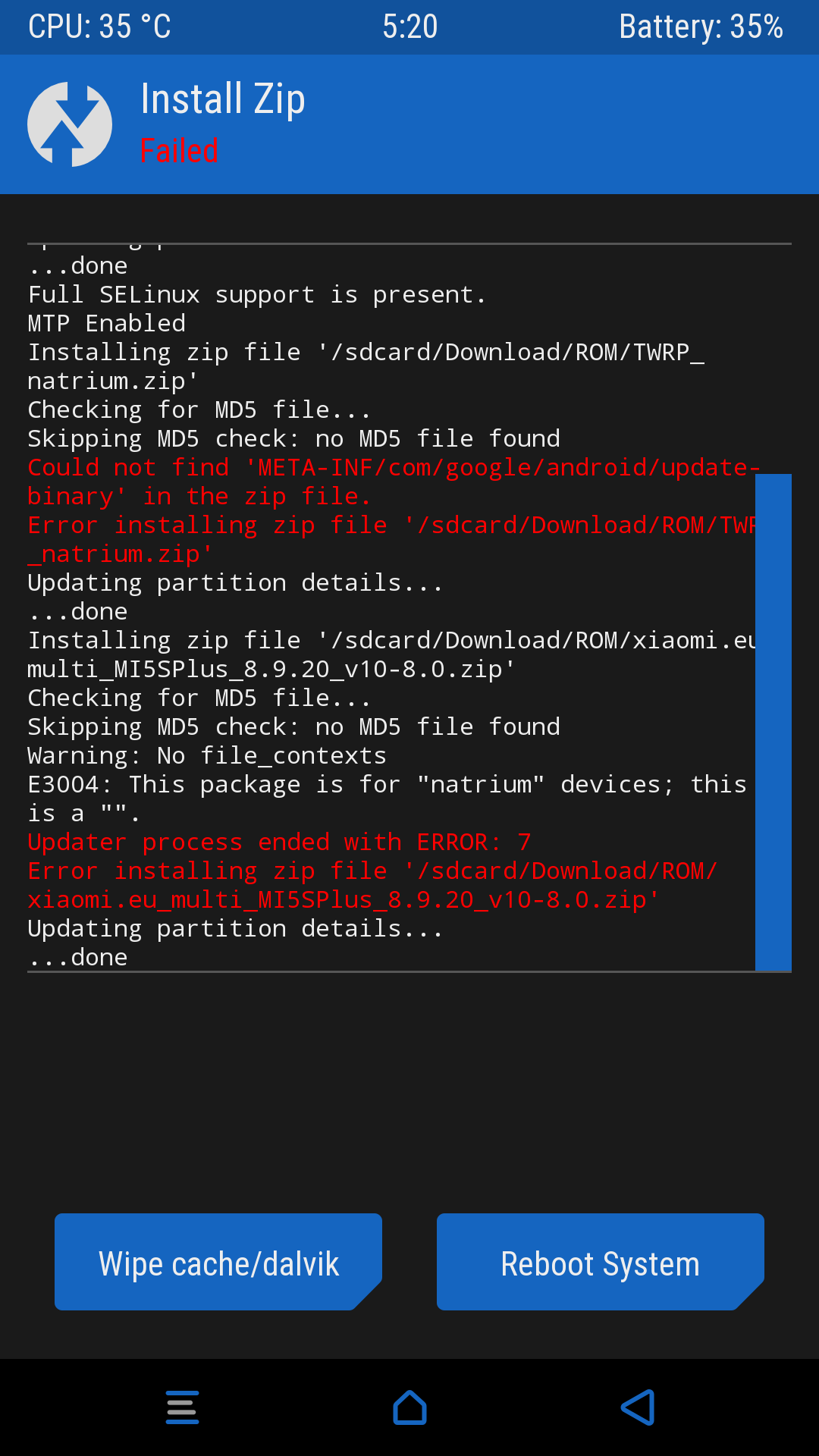

My phone is Mi5s plus and I am on the Miui 10 from last week 8.9.13
I tried to upgrade my phone to latest firmware especially because it is on newer versions of Android 8, but it has failed. I tried several times to download because I thought that file was broken. Then I tried with updater app from miui it also failed. I also tried to flash latest twrp but it also failed.
I am attaching screenshots from twrp. Thank you for hard work, hope that this will be some help.
