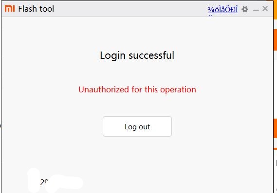

HI,
I have the same problem, no more fastboot nor recovery, reboot permanently => back to amazon, because xiaomi does not allow the flash with sp flash tool "account not authorized for this operation", I write on their forum but I remain unanswered.
The problem comes from the manufacturer, if this flash is "authorized", and i do not succed, I do not send it back, but the "unauthorized operation"!
The device works, just allow the operation ... if not ==> Back to xiaomi this is the good choice !
*** You must also know that the interminable reboot of the phone will literally kill the battery! ***
Allow buyer the flash to return to the original rom it's the minimum...
Can not flash with the flash tool Sp flash tool, to recover the phone:

HI,
They allow buyer the flash to return to the original rom it's the minimum...
Can not flash with the flash tool Sp flash tool, to recover the phone: View attachment 27306
Attention for users of REDMI Note 8 PRO, I do not recommend the installation of this rom, if you still want to try to do it, check if you have an account "authorized" (according to which we do not know too much! )
Otherwise, if you want to go through SP FLASH TOOL (for recover if phone brick), it will not be possible!

HI,

check this: it is about redmi note 8 pro.
Thank you, but I already know this procedure, it's exactly the one I used.
Unfortunately Xiaomi allows some accounts and no others, we do not know why!
For my case "unauthorized account"!
I returned the phone to amazon too, but there is still a hell of a problem with this rom and the RN8P, fastboot and recovery disappear ...
