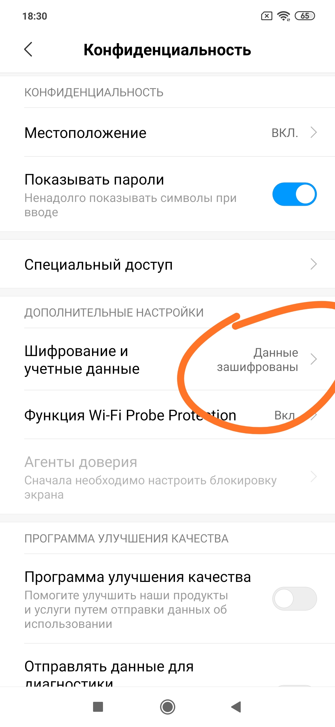

Wait, you have bootloop? Phone is encrypted?
Same for my Mi9.. Can't go back to 9.4.18. The Phone was encrypted. I don't know why.
In the file "fstab.qcom" is the entry "fileencryption=ice" .
So, looks like mix3, mi9 and mi9se are encrypted by system
You could change it back to "encryptionable=ice", format data and pull changed file back, may be will work

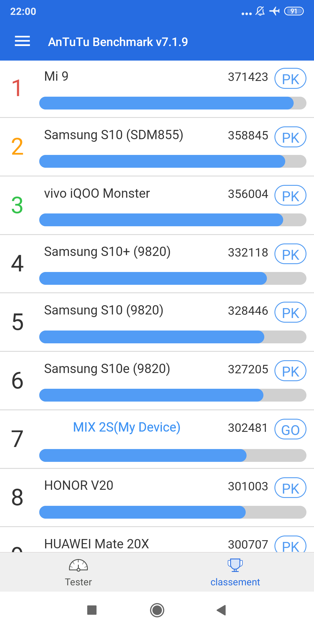

9.4.26 here on lui mi mix 2s cam very smooth and very nice antutu score ( 302 481 ) ans batery life , thanks for the rom !

Please tell me, how to disable encryption DATA partition on my Mi9se?
I tried to format DATA partition in TWRP, but after installing firmware, DATA is again encrypted.
TWRP: TWRP-3.3.0-0421-XIAOMI9SE-CN-wzsx150
Install all over again. So, algorithm is as follows if encryption is not needed:
- TWRP
- Wipe > Format data
- Reboot > Recovery
- Install > ROM
- Reboot > Recovery
- Advanced > RM Forceencrypt > Remove Forceencrypt
- Reboot > System
- TWRP
- Reboot > Recovery
- Install > ROM
- Reboot > Recovery
- Reboot > System
why you wants to disable encryption..? TWRP will decrypt it after setting of lockscreen password..

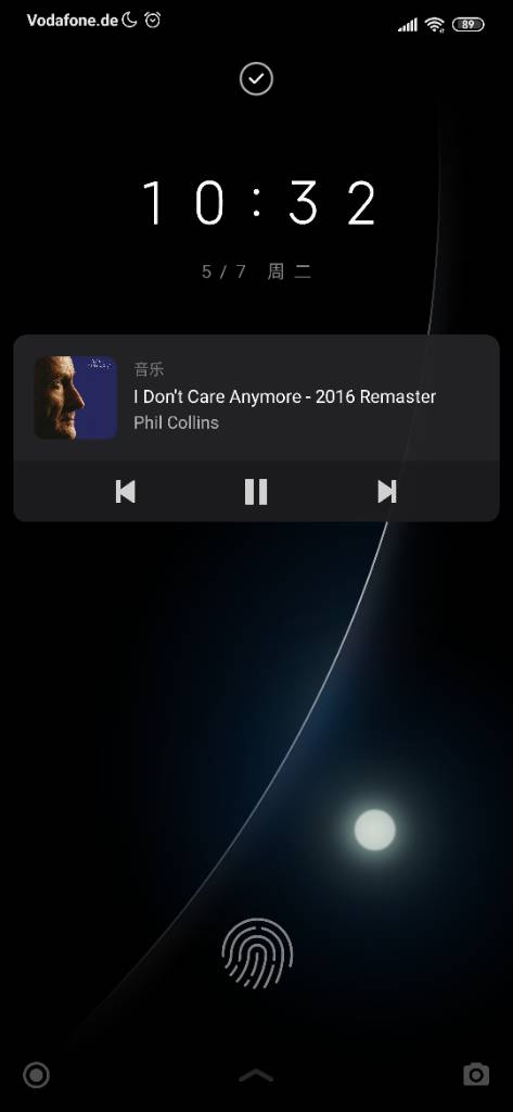

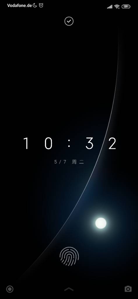

Anyone else have translation problems on lockscreen?
Gesendet von meinem MI 9 mit Tapatalk

If it is EU stabke ROM it's OK, but flashing official stable leads to encryption.
What is not clarified yet is the TWRP (latest version) behavior versus encryption they are supposed to handle without need to play with Fstab.
Can we now encrypt with settings/privacy feature, that was inoperative before.
It seems that on the MI9 encryption is automatic and is never linked to the pin password as it should be in this case.

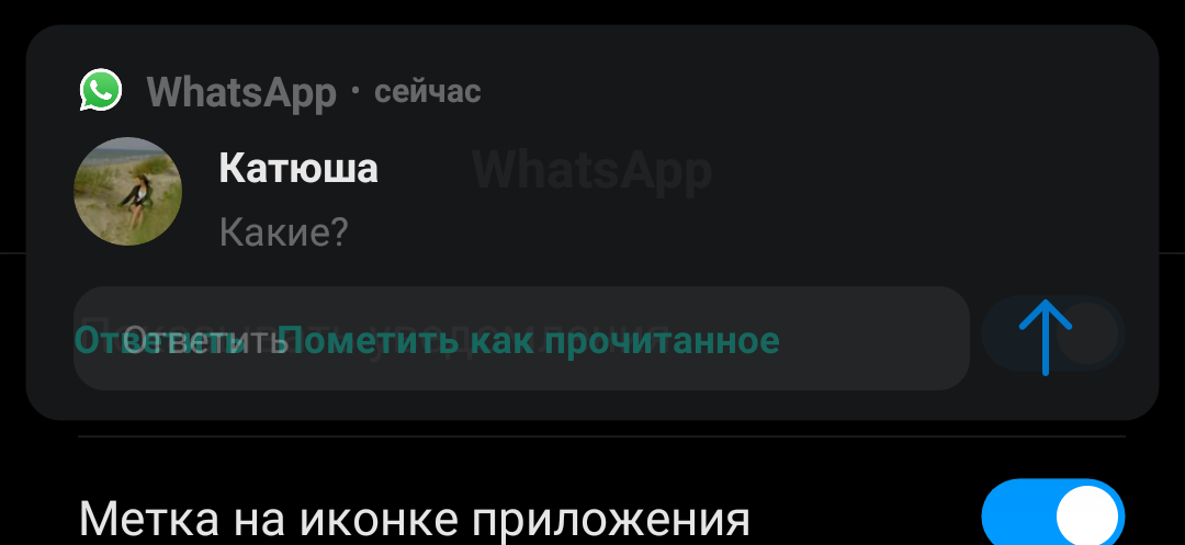

Have a problem with quick repond. Button Reply & Mark as read combined with the field of response
Problem only in dark mode. Theme is default

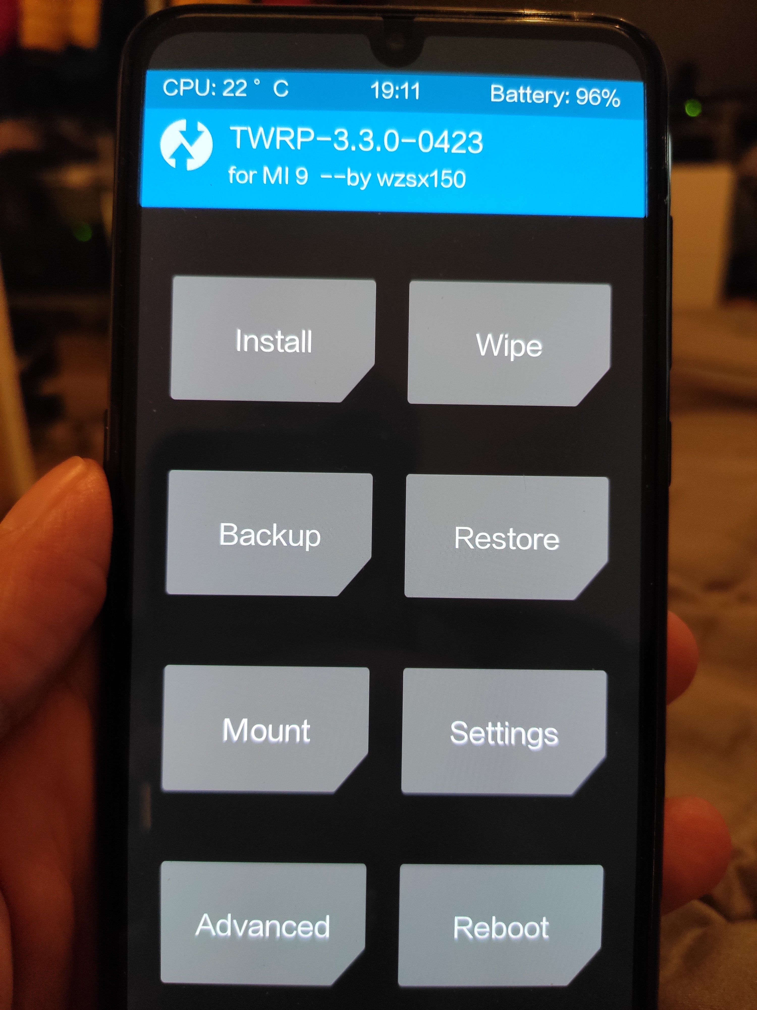

Hi Soldatino, which TWRP you use for the MI9 ?? is it working fine ?
Thanksss
This one !
It work with magisk 19.1 but updating to 9.5.1 I had to do a format data and clean install because magisk module installed before kept the phone in blocking by restarting it each power on!
On my mi9 se, Trwp askme the password and if I Digit my phone pin it work .
It's encrypted but with my pwd I can Easy decrypt and flash update.. is it right?!

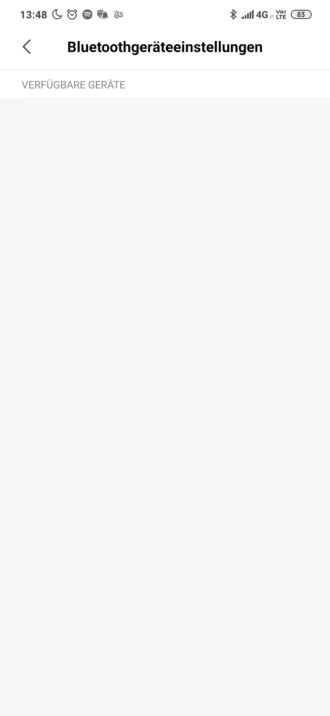

How can I use the unlock with bluetooth device feature?
No device appears even when I am connected.
