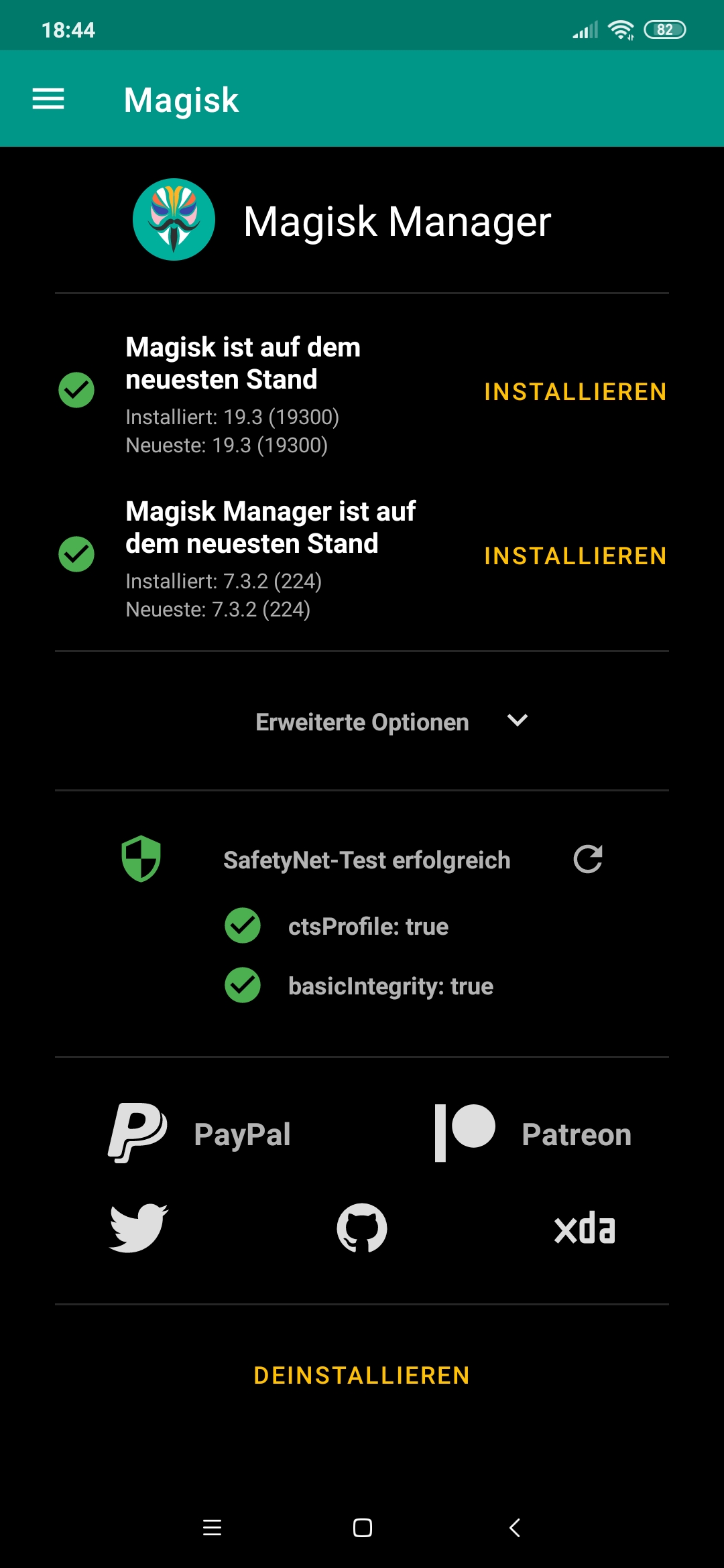

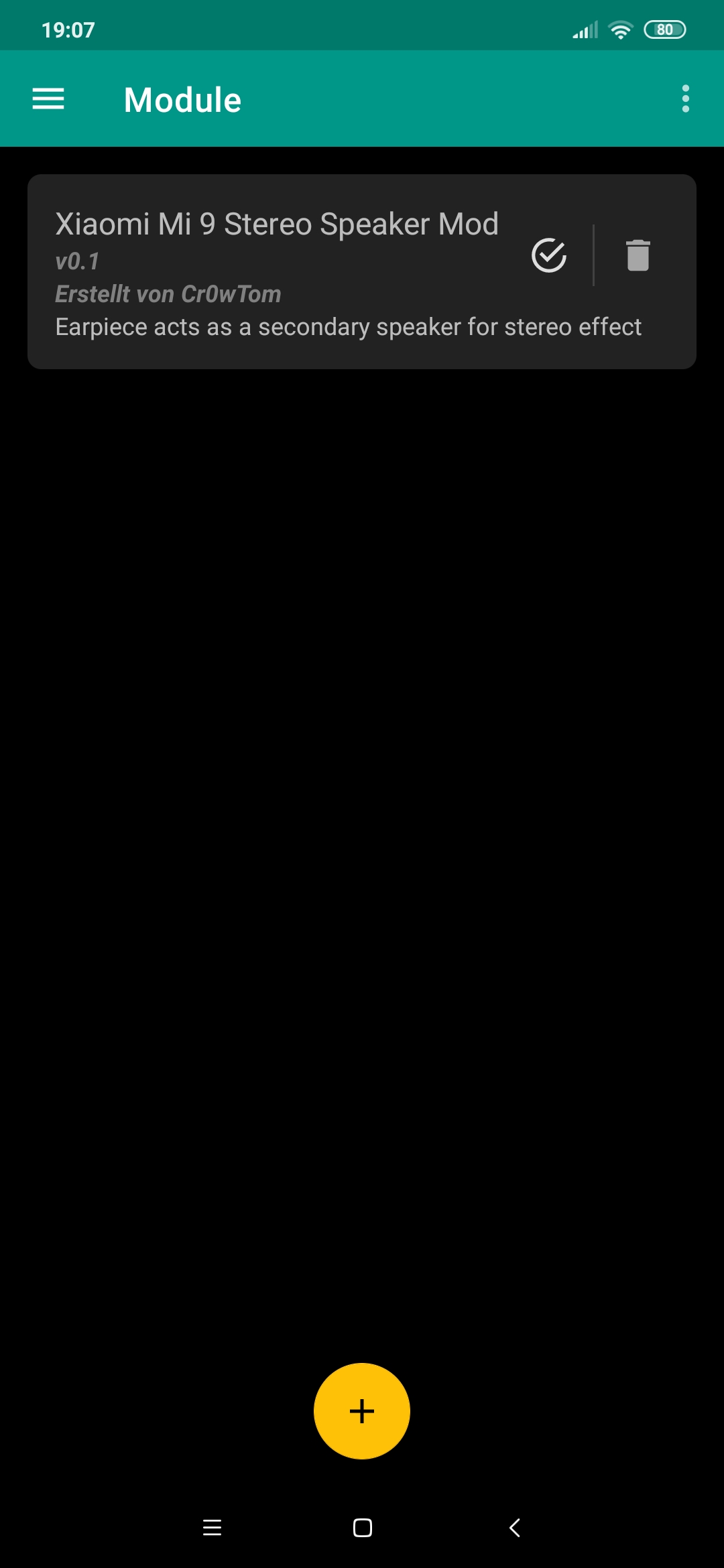

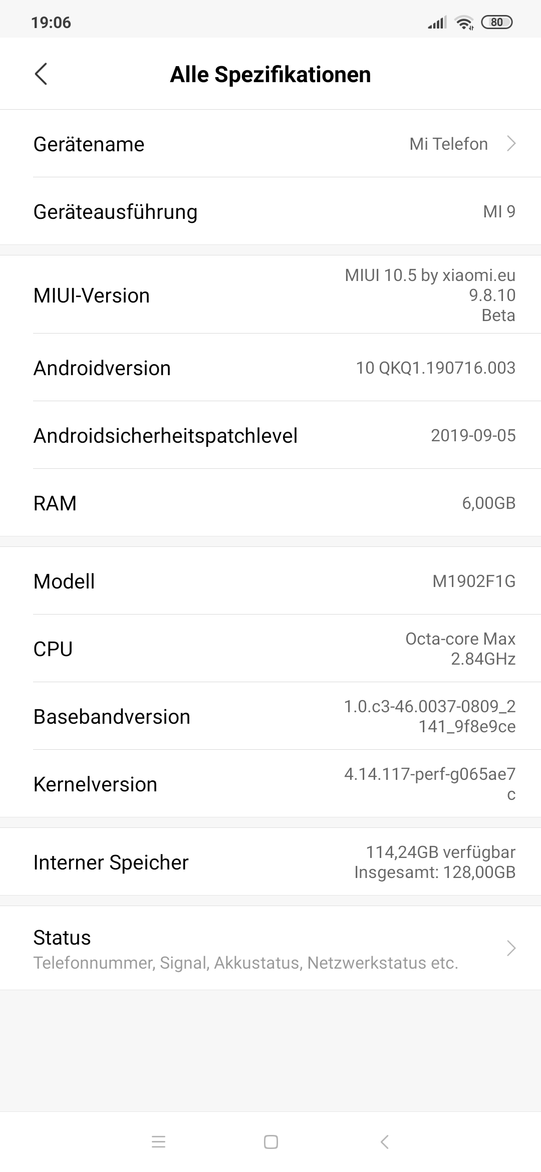

Today I have the following strange experience: I have not been able to install the update from 9.8.8 to 9.8.10. After I only got into TWRP via Fastboot but could not boot anymore, I flashed via MI-Flash back to Stock Rome (Pie Stock Rome). Then I installed again TWRP, formatted the data and taken the newest Rome. I do not know why, but now I come in the recovery and was able to install Magisk despite version 9.8.10 and everything works. I have no idea why but the Rome is now running top .
1. Flash about Xiaomi Flash and got back to Stock
2. Installed TWRP twrp-3.3.1-35-cepheus.img
3. Installed the newest Rom MIUI Android Q 9.8.10
4. after setup i go back to TWRP and installed Magisk 19.3 Stable
5. download and install the Stereo Speaker Mod and no Probs
6. I dont know how it works, but it works .:)
