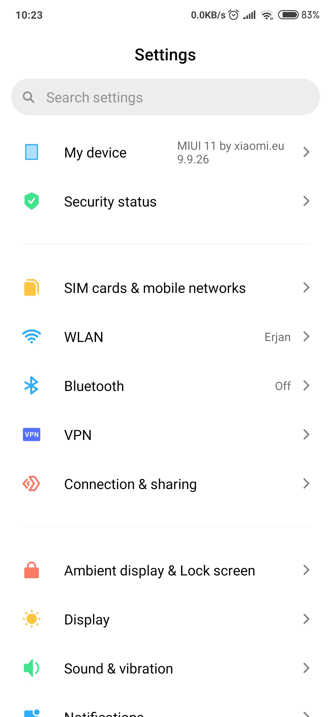

There is no new font Milan Pro, but its settings are. It works very poorly on Mi MIX 3. I can hardly type this text.

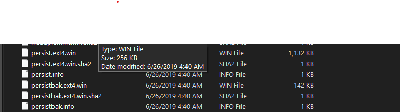

FYI : make a full TWRP backup and save it for the future. Persist issues are easily resolved simply by restoring persist images via TWRP.
For example see my attached screenshot, you place these files in a backup folder and place that inside the TWRP backup folder. Now it's easy to restore just the persist images alone.
