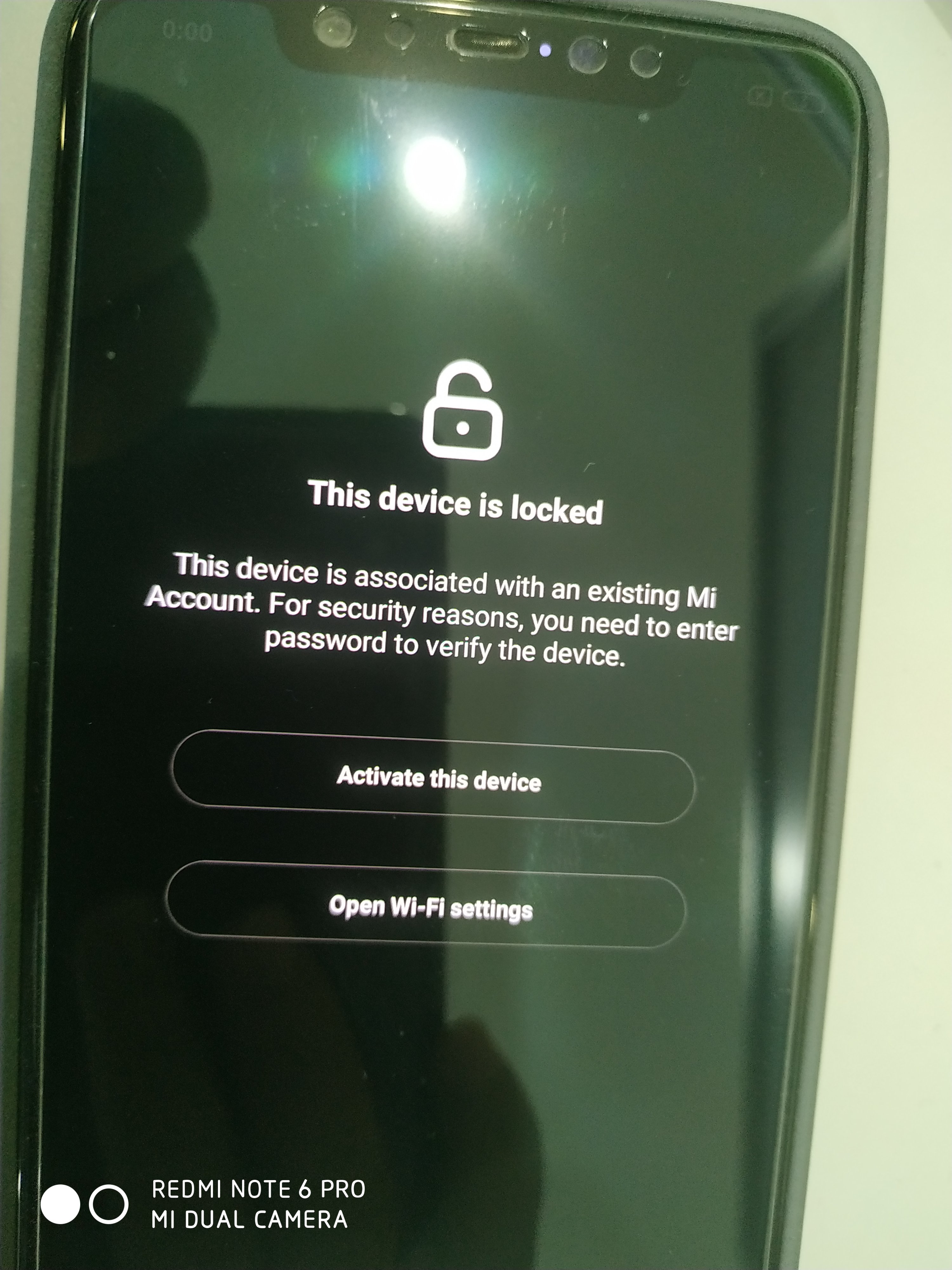

Hey. My phone is mi8 128 after 9.9.27 the wifi and Sim card is not working and I flashed the global beta, China beta and the last EU miui 10 rom and neither the wifi or the sim is working in any one of them and iam now stuck withe the activation screen
Please any help would be much appreciated.

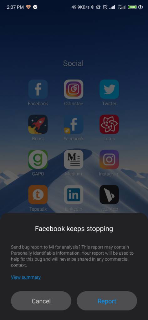

There is a trouble with Facebook app, it keeps crashing all the times unless I clear all data but it's a mess
Sent from my MIX 3 using Tapatalk
Please any help would be much appreciated. View attachment 26390
Did you try to flash persist.img or so?
I don't know what you mean
But waht I did after the 9.9.27 update is
1-flash 9.9.3 via twrp and the results are not working
2-flash global beta 9.6.27 via fastboot not working
3-flash China beta via fastboot 8.12.13 not working
and now back to global beta again and still the same.
Okay I've a solution for this you might have broken your firmware partition that's why modem hardware is not working. Tell me your device's codename and also rom name that comes with your phone when you purchased it.
For example my device's codename is Raphael & rom name that came with my phone was QFKCNXM. So provide me these 2 name I'll give you a TWRP flashable file that could solve your issue
Sent from my Redmi K20 Pro using Tapatalk
My phone code name is dipper and it's a chinese version and came with global stable rom - don't know the rom name
did you accidently format persist partition in twrp while flshing any rom?
That's weird. A Chinese version phone should came up with a Chinese rom. However this is a Chinese firmware+vendor file as your device is Chinese. DOWNLOAD
Just flash this file using twrp and no need to wipe/format before or after flash this file. Hope this might fix your problem
Reactions: dawoud400
HMK20ProMI9TPro_9.9.26_v11-10 is hosted on AndroidFileHost but not Sourceforge.
Can that file be uploaded to Sourceforge? Every mirror on AndroidFileHost is giving me extremely slow and unreliable download speeds. Thanks
EDIT: Someone was nice enough to supply a google drive link a couple pages back...
this is the first version 9.9.26!!!
Very happy about this version! The new miui 11 works fine on the mi8pro! No bugs so far, only some translation items, but no problem. Recommend it!
i had this problem once a short moment with 9.9.27, but since 9.9.27 does not work, back to 9.9.26
and everything is fine
Connect to a wifi, enter your mi credential for unlock the phone.
Of you don't Remember password, reset It on website.
