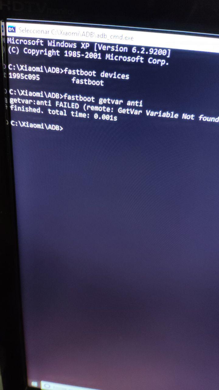

Hi, I would like to know how to check if my Mi Mix 2s has anti rollback.
Currently I have installed the 8.7.5 Global, I wanted to install the .eu. I do not know how to verify if you have or not, I have located a command that tells you whether or not you have redmi note 5 but this device does not work. They know some way to find out. I append pfoto of what I get when I write this command.

I speak of the mi mix 2s. a companion of a thread of Telegram put the Chinese 8.7.9 it does not allow him to put again twrp it does not allow him to flash the global one with my flash.
Maybe he has locked the bootloader flashing a rom
TWRP needed to be recompiled to add support for 8.7.19, the one from XDA works just fine now. No anti-rollback for mix 2s.
Of course it doesn't and you have to be doing something wrong.
And if there is antirollback, The phone would not be reversibly damaged and it would not be possible to restore it from the bootloop as it did and use it
