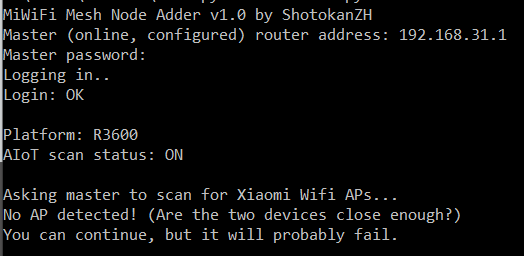

Thank you very much for your answer. I finally succeeded the password step... ;-)
I have however a problem : My master router (AX3600 global firmware) is unable to detect the second router (ax1800 chinese version) => "No AP detected" and nothing happens after entering my MAC address
Any thoughts? Many thanks again for your help.
...it's a password field, it does not show anything, it's for added security...

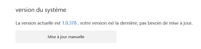

The AX1800 you are currently using, is it updated to the latest firmware? Is it out there any global firmware for that router?
I have an AX3600 with global firmware and a Chinese AX1800 which the routine very successfully meshed. Make sure you have done a factory reset on the AX1800 and locate it close to the main router.
Thank you very much. I did a factory reset through the interface and not pushing the button on the AX1800 and it works very well. Thanks again all for your help. Much appreciated!
