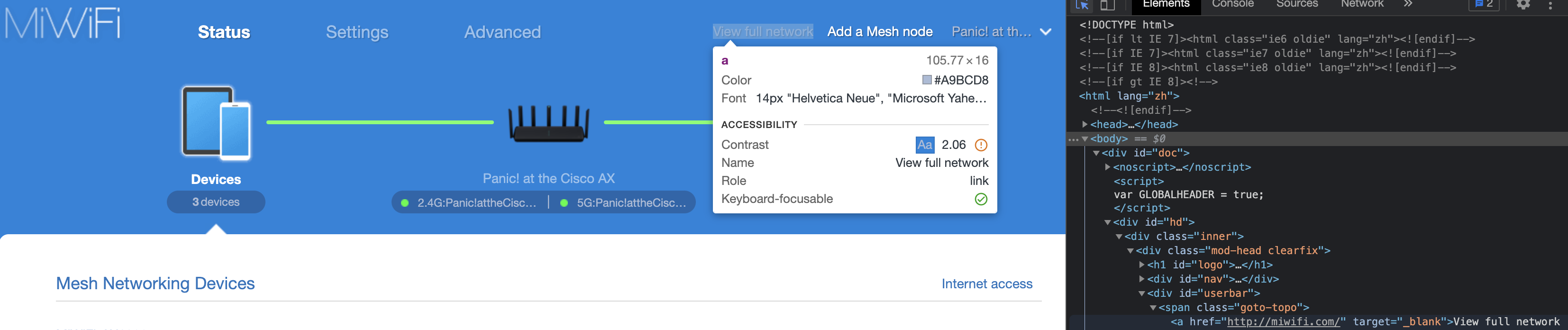

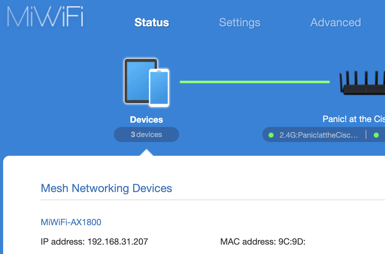

Replying to myself and others: Reset the AX3600 to the factory settings, tried the script and... TA-DA, mesh network set... (The odd thing its looks like you can't have spaces at the SSID - The router renamed my network and removed the spaces after enable the mesh).
Other odd thing its in router dashboard if I click in "see full network" its sending my to xiaomi home page:
36112
But at least the mesh is done now and I can get rid of one ethernet cable :)

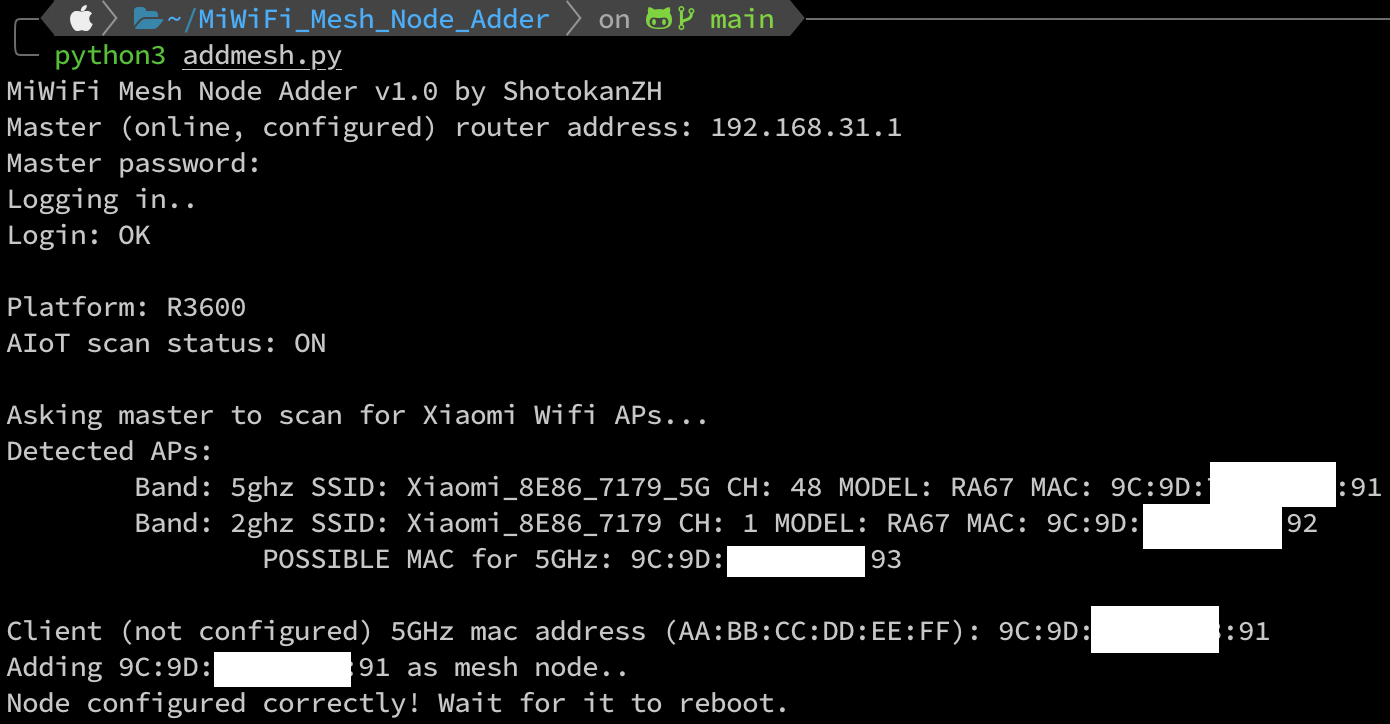

For Mac I used Spotlight and Terminal (windows check his notes)
Terminal:
python3 -m pip install -r requirements.txt
python3 addmesh.py
Put in 192.168.31.1 (IP from Master AX3600)
Password:12345678
The script will show you the right MAC address, make sure you copy the 5G one and paste it where asked. Press enter, wait for restart!
Don’t use the MAC address on the sticker off the router.
Now it should work and now you can change your passwords etc.

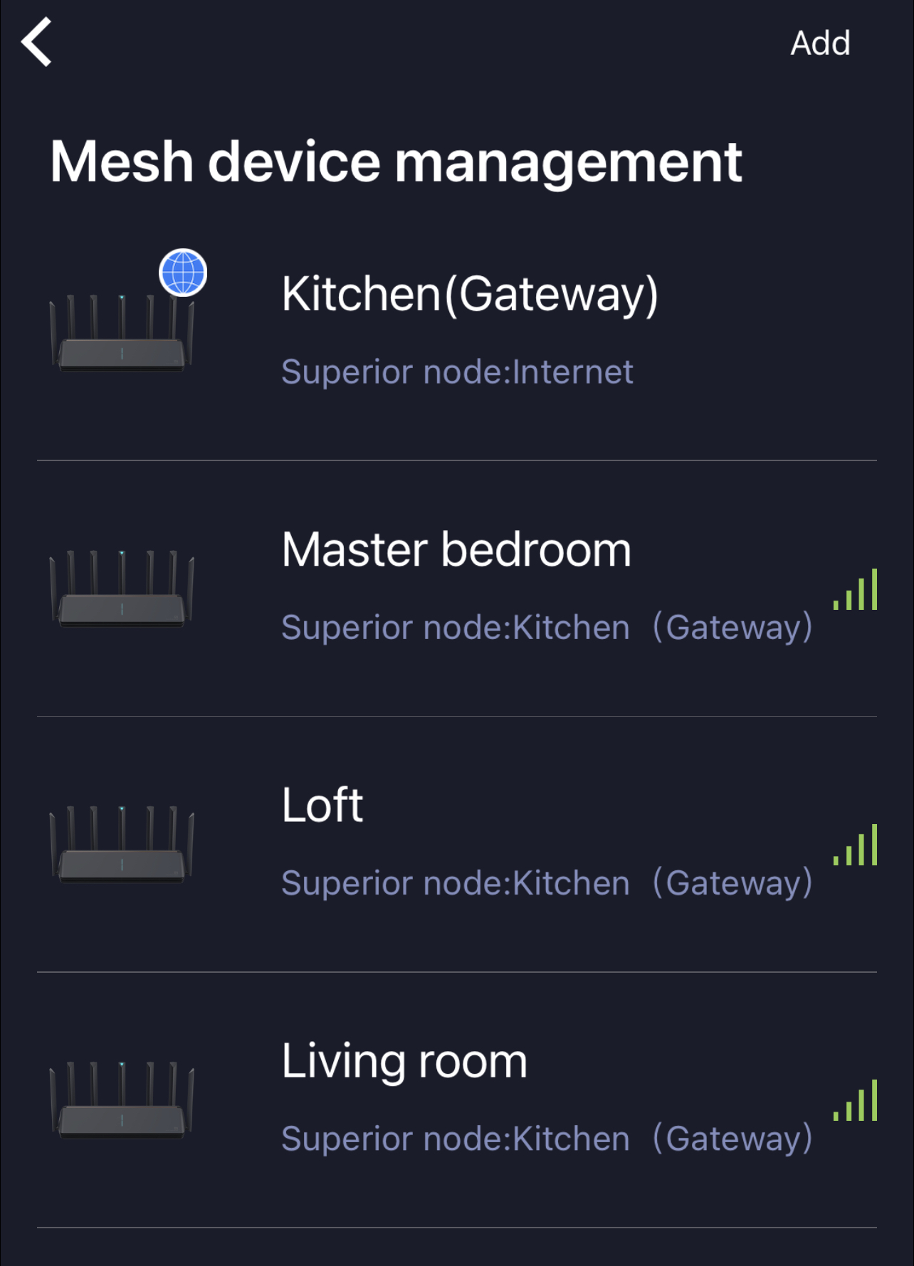

Back here again u fortunately… I live in a rather large space and the complete setup contains of 4 AX3600. The whole house has a lot of Google Nest Speakers and a bunch of Apple Homepods but they all struggle with the connection. I think that they lose connection while they switch to another router and obviously I am really disappointed with 4 routers… anyone the same issue or a solution?
Funziona alla grande lo script. Ricordatevi di collegarvi al router principale tramite wifi. Funziona anche con firmware cinese e global. Testato su ax3600 Cina e ax1800 global

- make sure you use the MAC adress gathered by Wifi analyzer, the one on the landing page doesn't work
- make sure that the second router is in factory reset state.
Hope this help !
And obviously, thanks for the code ! it's pretty damn good !

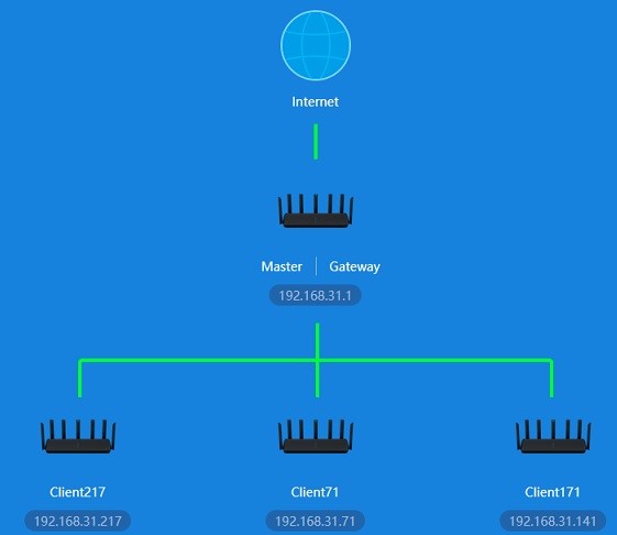

thank you very much for the script and help to set it up. It works perfectly. I have a main router AX3600 and was also able to add 3 more new type AX3000 as mesh. It all works ok. I do have a question, on one of the AX3000 in the farther side of the building, the speed is ridiculously slow (approx 10 mb) as compared to the others, it may be farther than expected. I tried using plugging in a LAN cable to the WAN port to see if it helps, but to be honest, there was no difference, any ideas would help to also get the speed up on the side of the building with the low speed?
