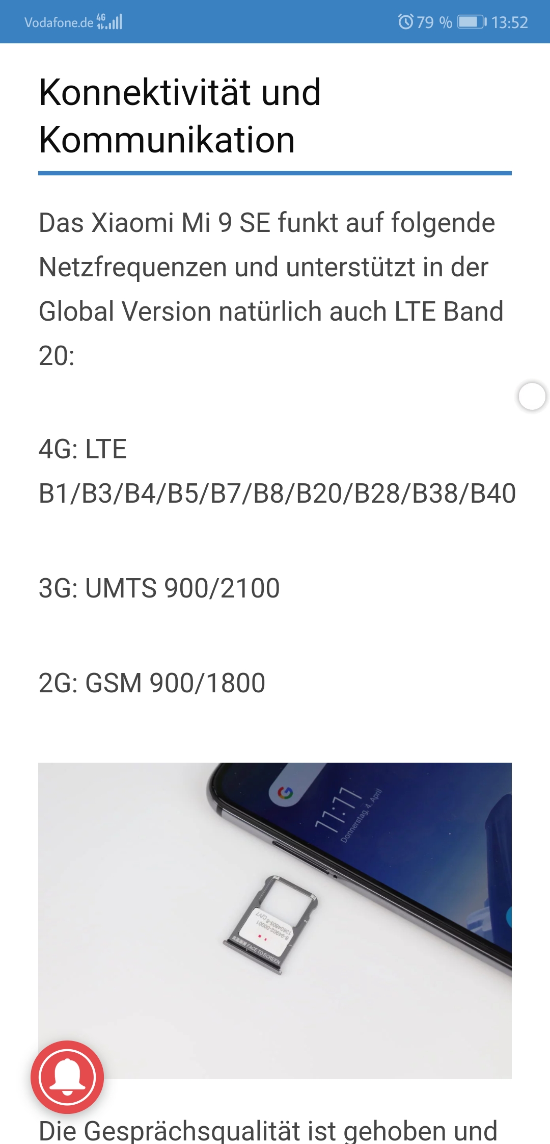

Latest update on specs of global version

if you read the article you will see that at least on the device they tested... the hardware was able to use Band20 and Xiaomi switched it off with an update later. So if the hardware is the same on other Chinese devices... it could be in theory switched on.
I'm not an German to read. I'm not even obligated. For sure the band 20 is one reason why there are global versions of Xiaomi mobiles
