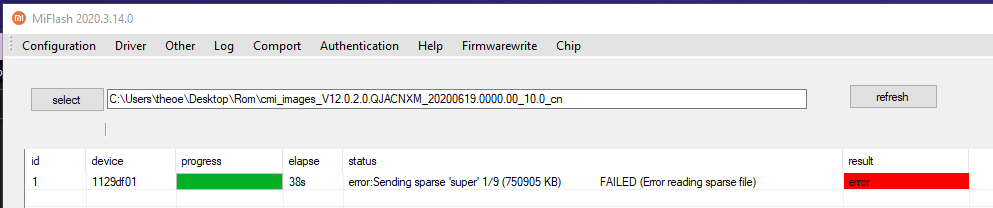

That's what I just tried. Unfortunately hasn't worked. I get an error in the flash programme.
That didn't work either unfortunately.
