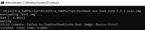

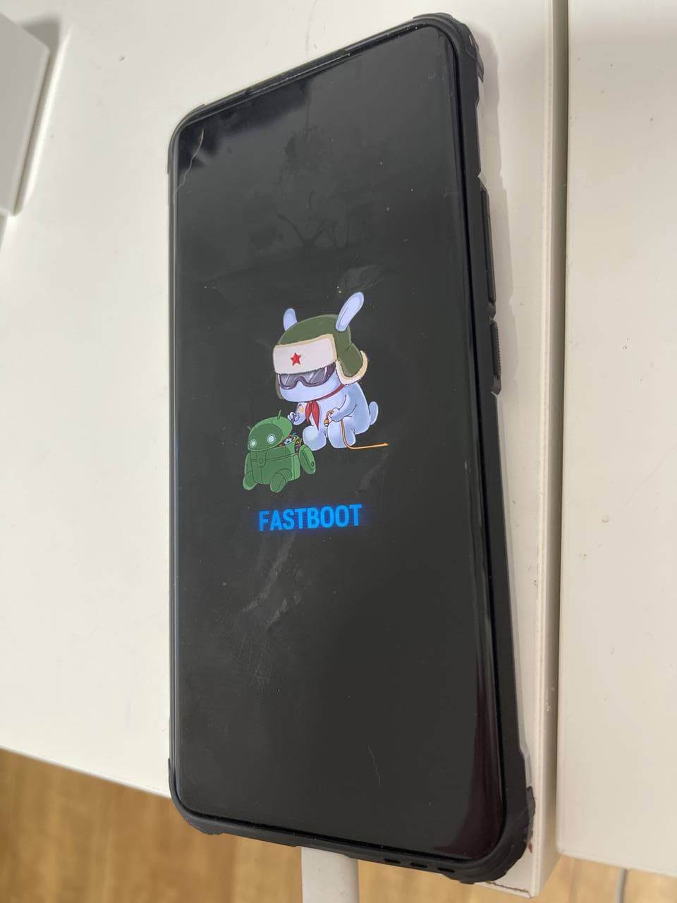

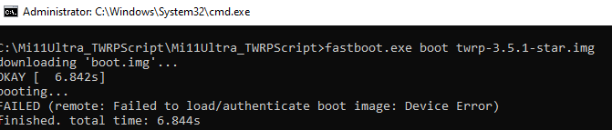

I think I have done something very stupid, and now it seems that i brick my phone.
Hopefully someone is able to help here.
I have reset my phone on twrp and I think I have deleted data partition so I was not able to flash a new Rom by twrp.
So I download original Rom and flash it by fastbootmode with the Xiaomi Mi Flash Tool.
It runs up to 100% and tell me flash is successfully.
But it doesnt boot up! It ALWAYS boot back to FASTBOOT.
I try to install TWRP but i always get the follow error: FAILED (remote: Failed to load/authenticate boot image: Device Error)
Also, after flash stock image, I am not able to boot up with power / vol up.
My journey end always in fastboot mode.
I hope someone can help me to boot up my device.
Thanks in advance.
Chris

Hi again and again... no details no qualified answer ...
Which version did you install a11 or a12, did you move from stable do weekly or vice versa, did you format in miflash and so on
Mostly if you are back in fastboot or bootloop you have to format /data partition, disable magisk
A workaround could be to flash boot.img - but I dont have a crystalsphere what you did
If you installed a12 and if you try to flash TWRP it will not work
You have to boot into TWRP

I use MiFlash20181115 and stock CN Rom star_images_V12.5.20.0.RKACNXM_20211027.0000.00_11.0_cn_593548f483.tgz.
I do not have magisk and i am not able to boot to stock recovery. it always loop to fastboot screen. Also i am not able to boot to twrp.

Mi 11 Ultra device is known to be easy brickable... but I don't know why. :(
Did you chose to lock the bootloader when you flashed the "China" fastboot ROM via MiFlash?
Anyway, the easiest method to unbrick your device is to pay for a "EDL unbrick" service. The most known service is @*spam*paid*service* (Telegram).
did you format with miflash or did you enable the checkbox lock? is it so difficult to write in detail what you did?
1. Try to put fastboot and twrp image and fastbootimage into eg c:\test then flash with miflash / format / not lock
