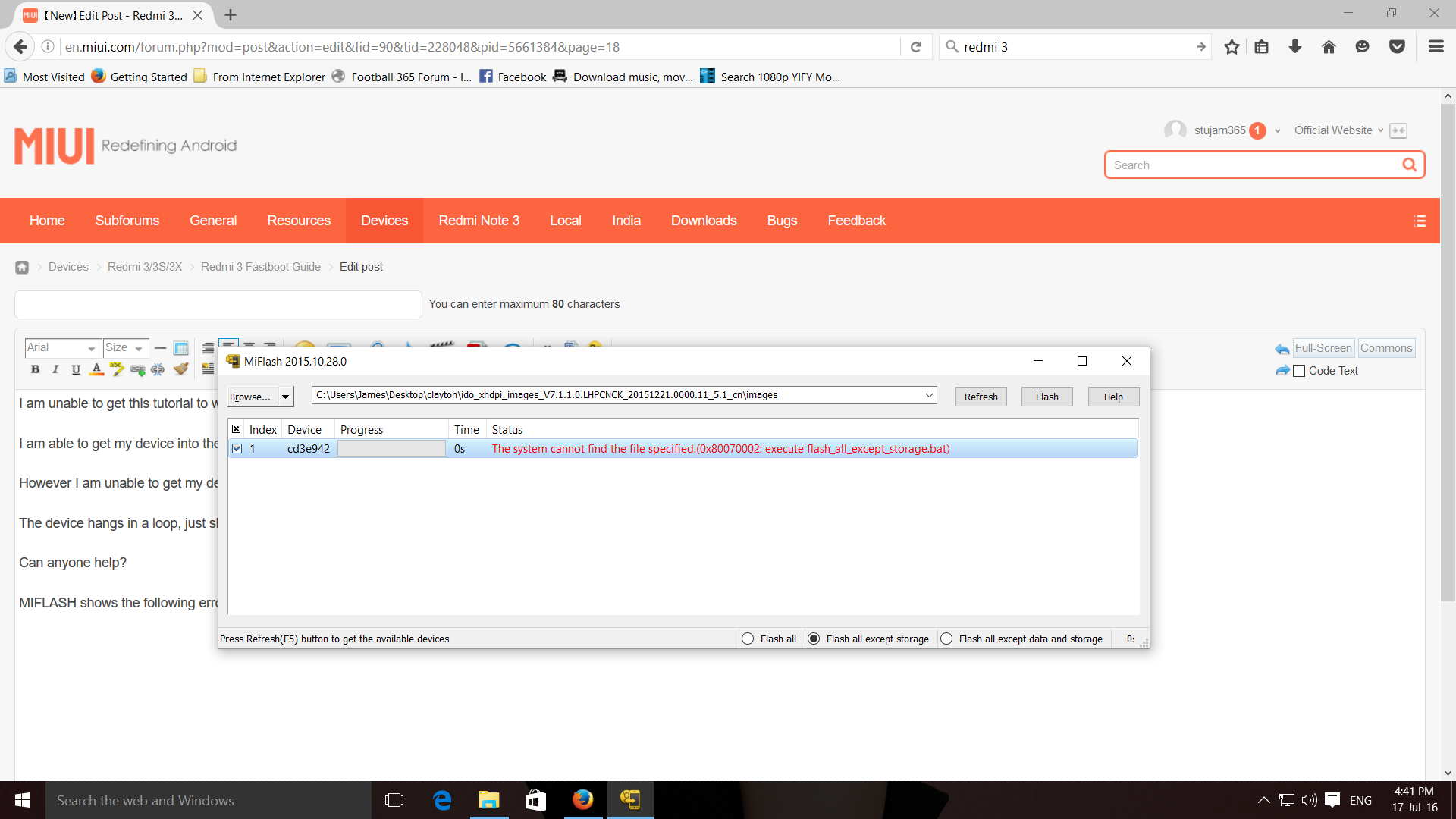

Hi I was directed here from friends who have had help from this
Wondering if anyone can help or has had any experience with the issue I am having. Was trying to update the phone with the latest stable ROM as the one I had installed is this one MIUI Global 7.1 Stable 7.1.91.99lhpcnck, however apparently this is not an official ROM?? Now the phone is constantly just showing the MI logo for about 30 seconds and then resetting and repeating. Unable to get the phone into recovery mode by pressing power and volume up. Though it does go in to fastboot mode but when I try to flash it using various ROMs from the official sites it says it cannot find the batch file when it is there in the directory.
Seems my phone is now unusable. It is however under the one year warranty from Gearbest where I bought it from so have contacted them.
Not select image folder, upper folder
Inviato dal mio GT-I9505 utilizzando Tapatalk
Thank you for your reply.
I have tried that without success. Keeps saying it can't access batch file even when I search for it in the advanced section

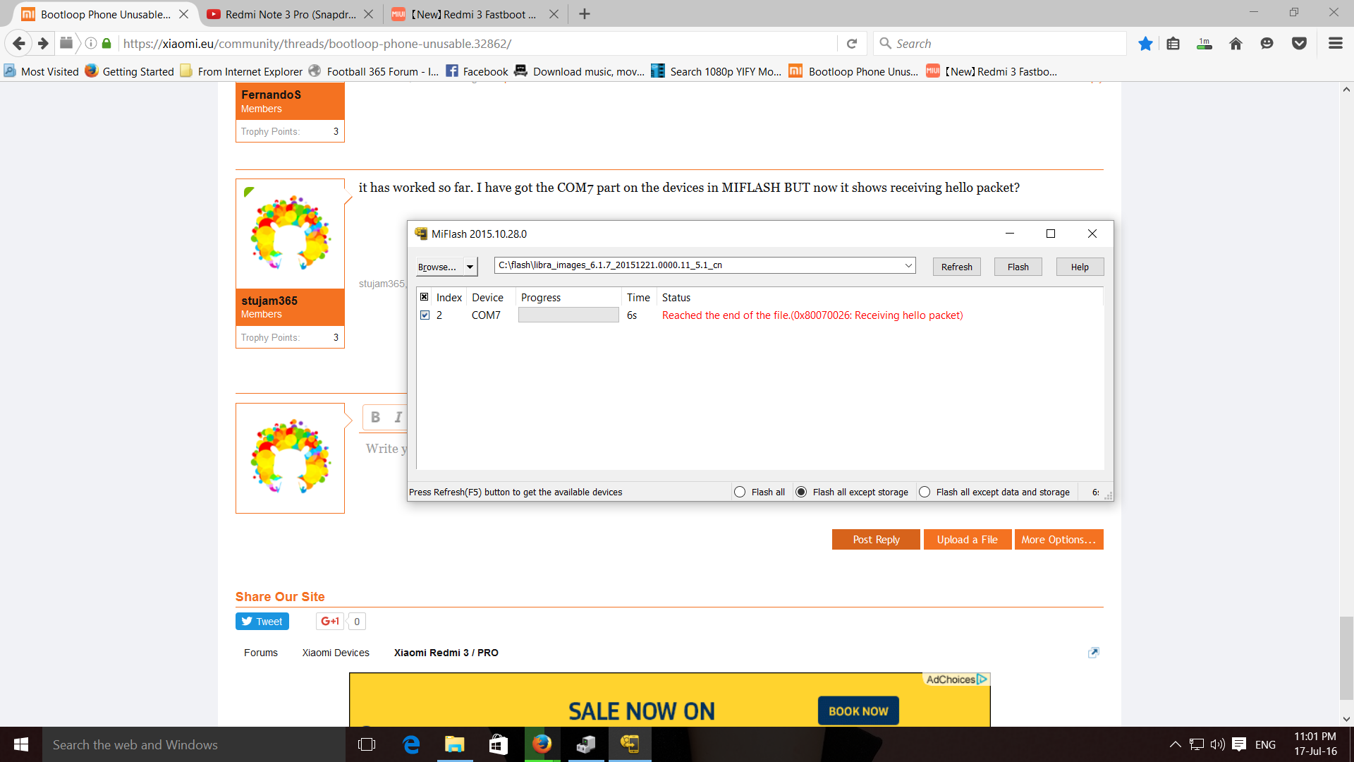

it has worked so far. I have got the COM7 part on the devices in MIFLASH BUT now it shows receiving hello packet?
This new rom is not for Redmi 3. Roms for Redmi 3 are ido or HM3.
Отправлено с моего Redmi 3 через Tapatalk
They are for unlocking bootloader and TWRP.
