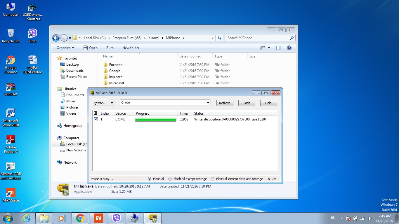

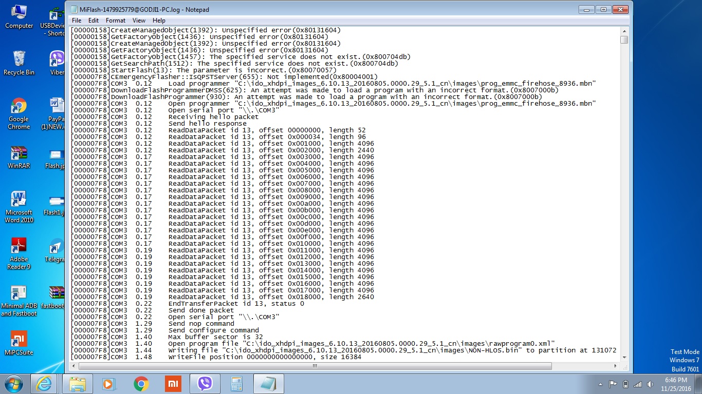

For five days, I'm trying, and I can not find a solution to my problem. My phone Xiaomi Redmi 3 Pro. After rebooting the phone is charged only to the logo Mi. Use the buttons to enter the EDL, Fastboot without problems. The devices Manager Phone is determined by how it is to be Qualcomm HSUSB-Qloader 9008 in EDL mode. My Windows 7 Profesional 64bit. I activated and Test Mode Windows 7 Build 7601 my MiFlash 2015.10.28.0 flash continues 12000s ++ and can not be completed.But then log in to Miflash see there are many errors in the beginning of a Flash. ButLoader phone is locked, the firmware on the box of the seller . Log from MiFlash

Try another USB cable.
With miunlock you login through PC during the unlocking.
Try with another usb cable or another PC
