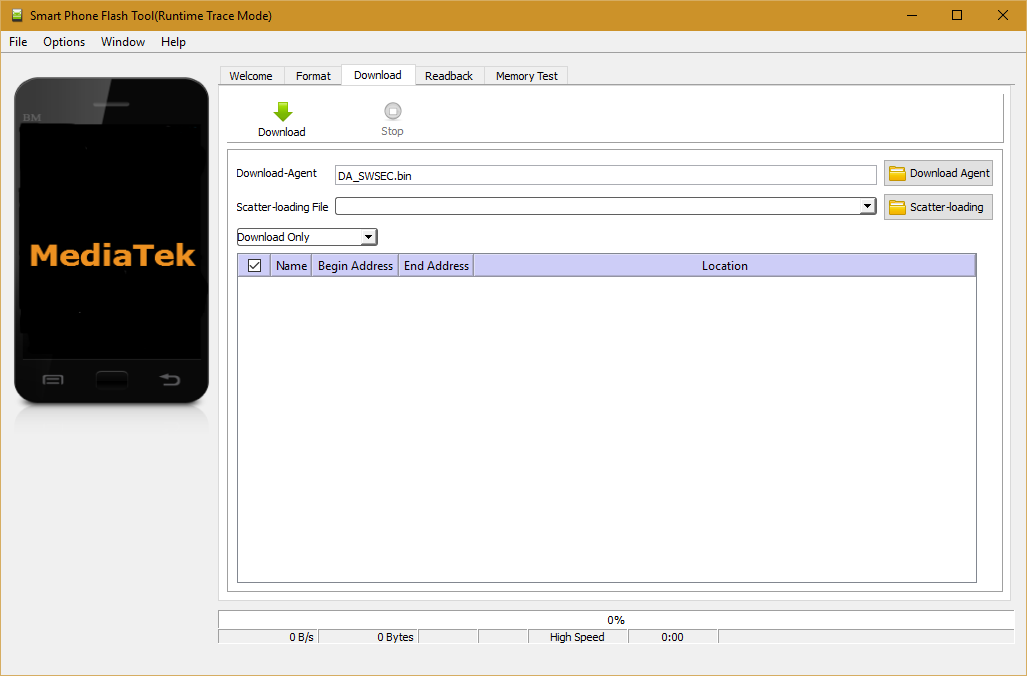

It's somehow due to SP Flash Tool version incompatibility.
Below, I've made simple, both SP Flash Tool as a self-extracting .exe file whereby when execute, it'll prompt for driver installation. Upon that, SP Flash Tool will popup whereby you simply just need to direct ONLY the 'scatter' file which should be in the same directory of the extracted Fastboot ROM.
Download SP Flash Tool v5.1516.00 for ALL Custom Fastboot ROMs [45.5 MB]
http://www.divineelixir.net/files/SPFlashTool-v5.1516.00.exe
Download SP Flash Tool v5.1520.00 for ALL Official Fastboot ROMs [45.6 MB]
http://www.divineelixir.net/files/SPFlashTool-v5.1520.00.exe
